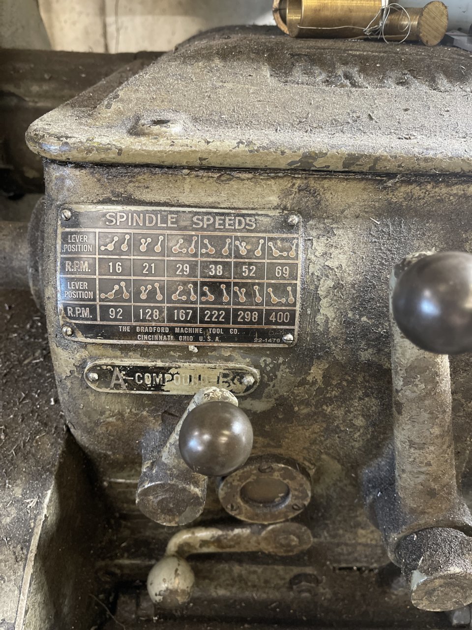

    Proof that I'm not misreading this thing. I think I'd notice if it was doing 4k rpm...image.jpg

    4K? Yeah, you'd notice that... that big old sum' bitch would dancing all over the shop floor! :rofl:

    That tag looks a little odd because it looks to represent two levers on the left. I wonder if it means the one down below that one which would put the spindle speed at 92 rpm :notsure:

    Never mind I think I see the two levers now. Then that left lever looks like 2 speed range and maybe that bottom one is a feed reverse.

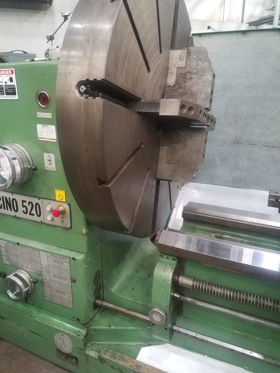

    The big lathe in our shop has a warning not to run over 150 rpm with the 4 foot diameter chuck on it. Guess they don't want it flipping over on the operator.

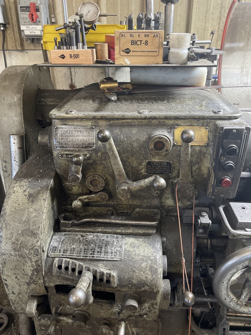

    The diagram represents the middle two and the far right. The far left is actually for part of the threads and feeds selection. image.jpg

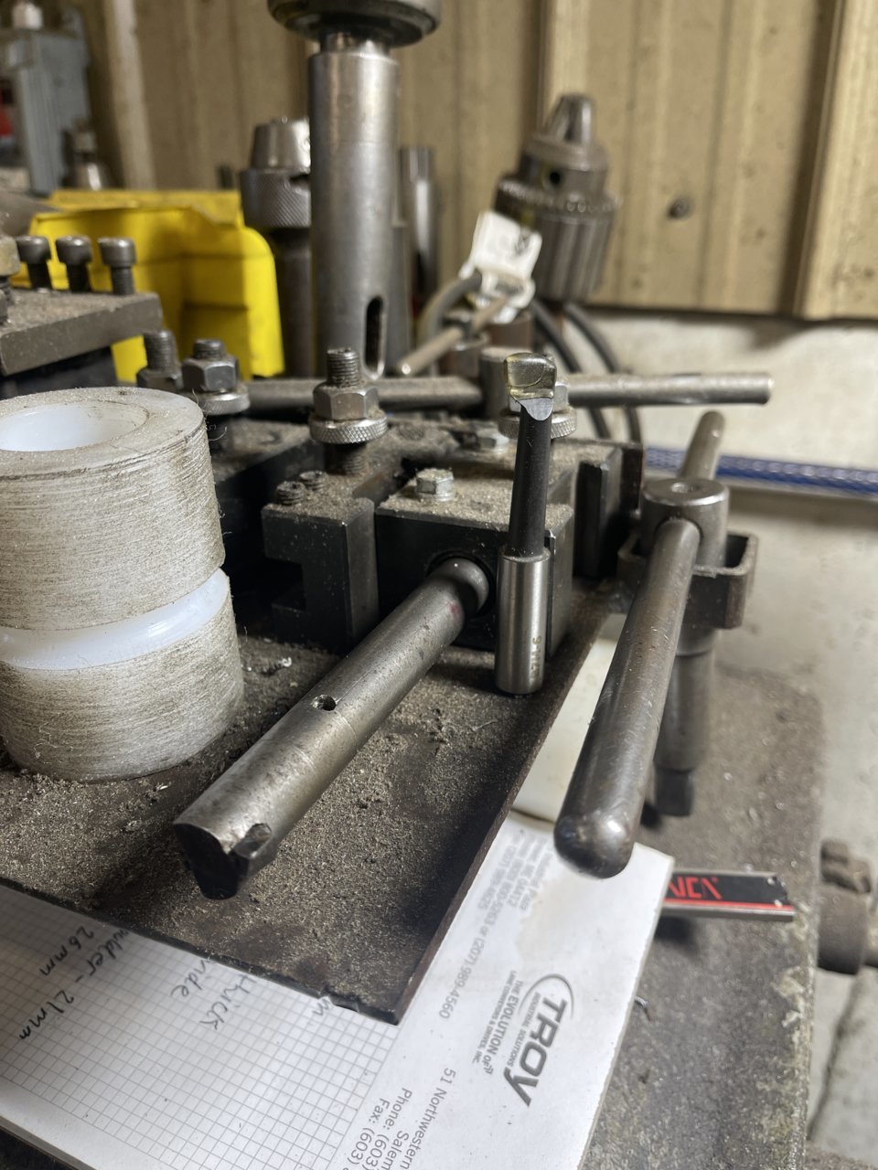

    Do these little boring bars require a special tool holder? I can't seem to find anything they fit in.
    Edit: the large boring bar in the holder is too big to fit inside the bushing. I need to bore it out to 18mm ID, and I've already drilled it out with an 11/16.

    There may be a bushing laying around to adapt the small boring bar in the big holder. We’ve done that before.

    No luck on a bushing... so fingers crossed! E472CD12-12CF-4767-B988-BEE295E836CE.jpg

    Holy shit on a shingle! It fits! :bananadance::dancingbacon::muscleflexing::headbang::humble::yay::yes:

    I was gonna suggest this way.

    That's just what I was going to suggest!

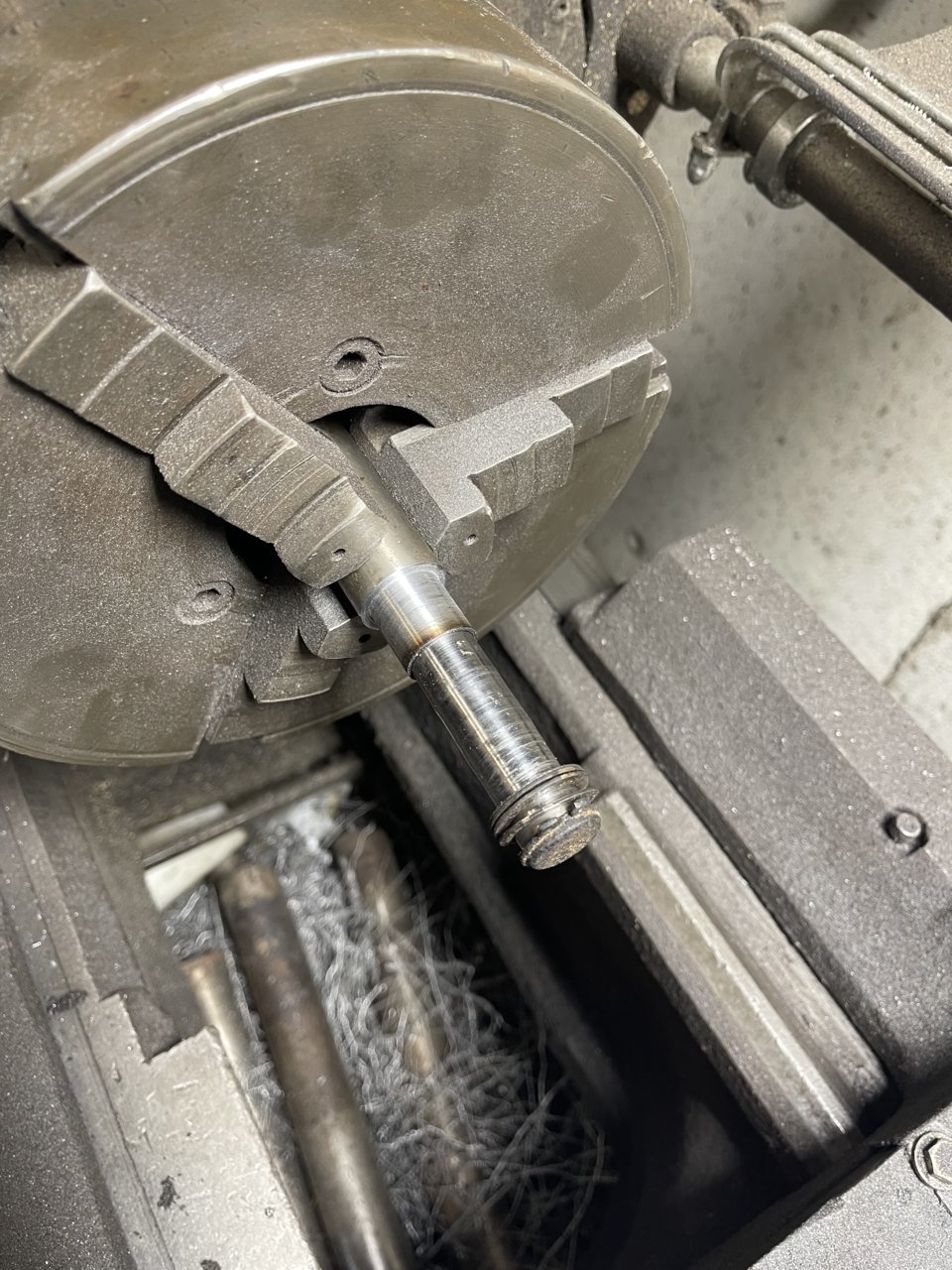

    One more question. Where on my part should the cut off tool make contact? Below center?
  19. Sep 3, 2021 at 3:33 PM
    tacotoe
    tacotoe Pastry Chef
    Nov 25, 2007
    #3593
    5,915
    Nebraska
    `17 AC Sport MT
    ARE Topper, Icon aal, OEM Audio+
    Slightly below. Spray some wd-40 or oil on it while cutting
  20. Sep 3, 2021 at 3:36 PM
    tacotoe
    tacotoe Pastry Chef
    Nov 25, 2007
    #3593
    5,915
    Nebraska
    `17 AC Sport MT
    Your going to want your parting tool pretty sharp too, and hopefully don't collapse the wall.
