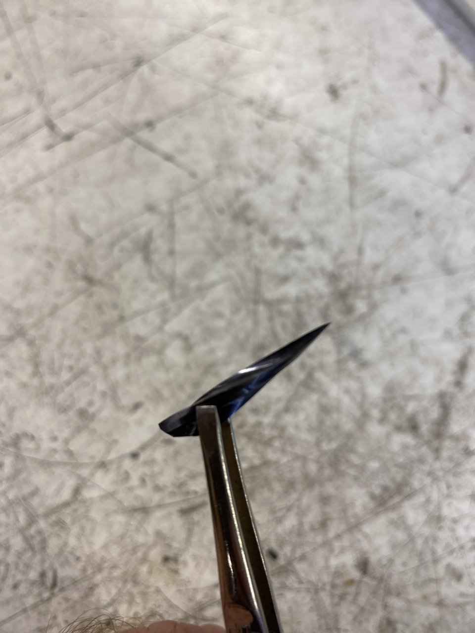

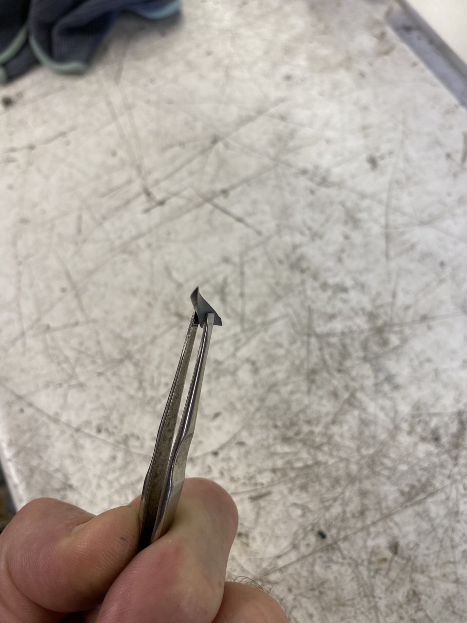

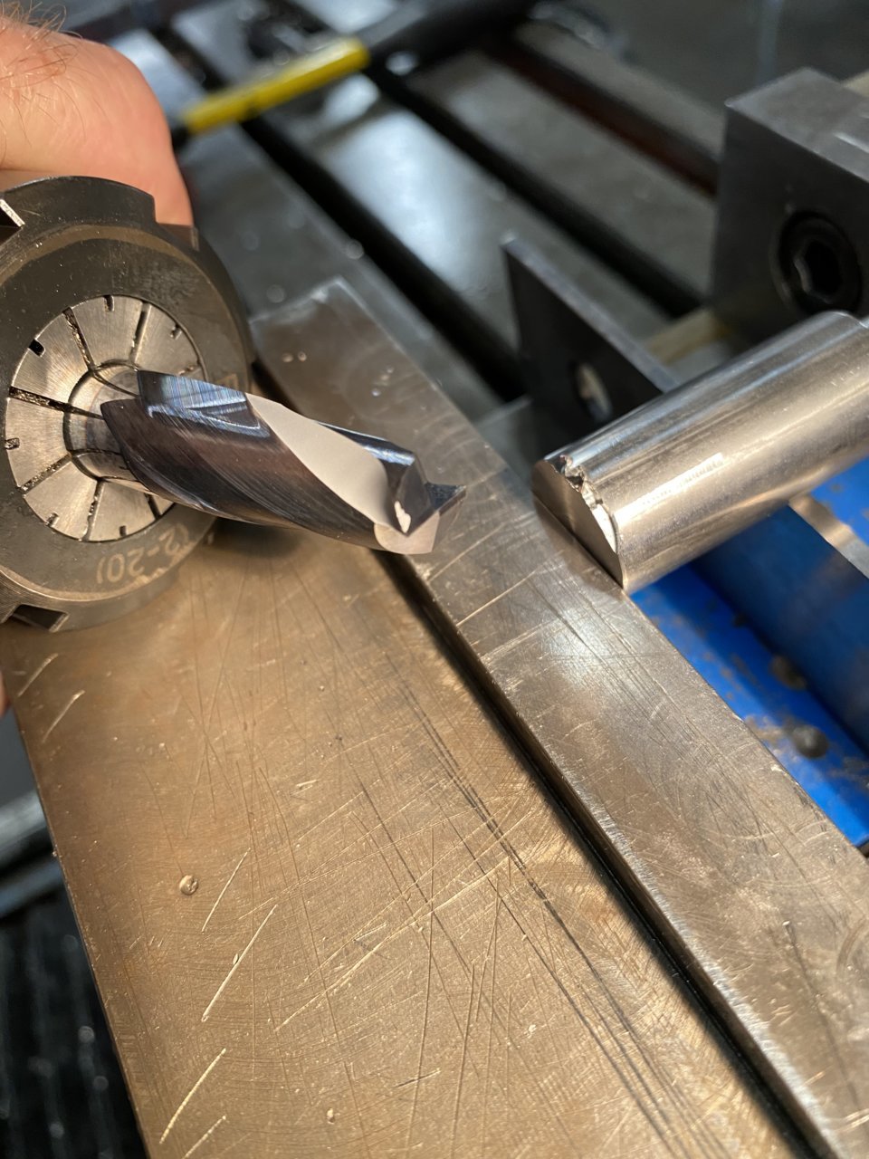

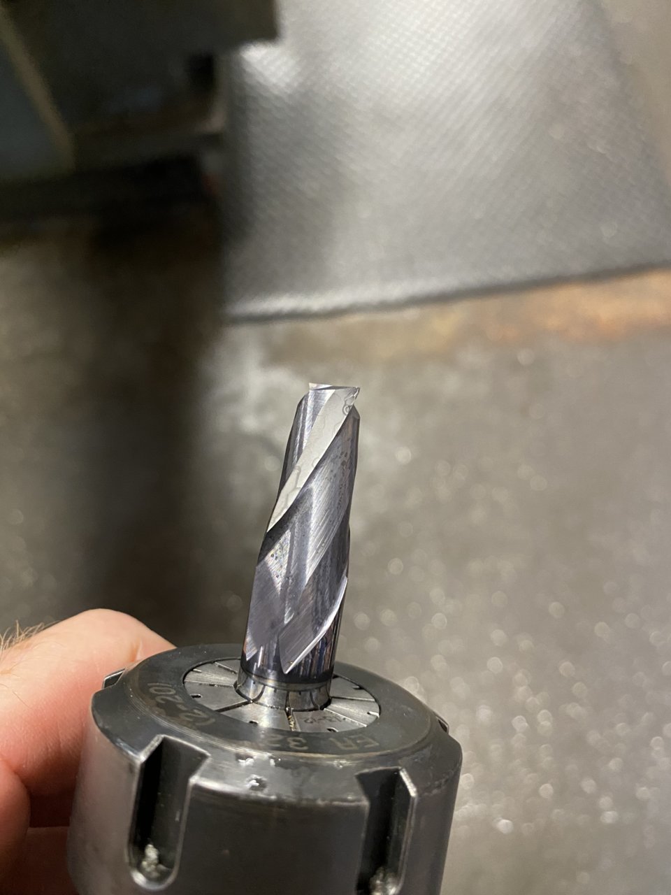

    Yes sir. Not sure why, it was tight (hammered it a tad). 1/2" solid carbide end mill, 1,000 rpm feeding it by hand .050" depth of cut. End mill shattered and part of it hit me in the stomach. Not much blood, lol.

    Found a piece of the end mill, thank God it didn’t go in me.

    I thought about that but there's a tapped hole in the small diameter I'd like to do while I have it in the vise. I'm going to try it again like I had it with a couple extra whacks on the hammer, more rpm's, and see what happens, may have to go back to the lathe for a minute :rolleyes:
