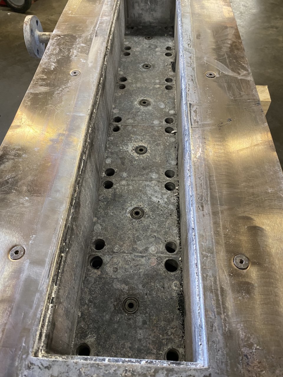

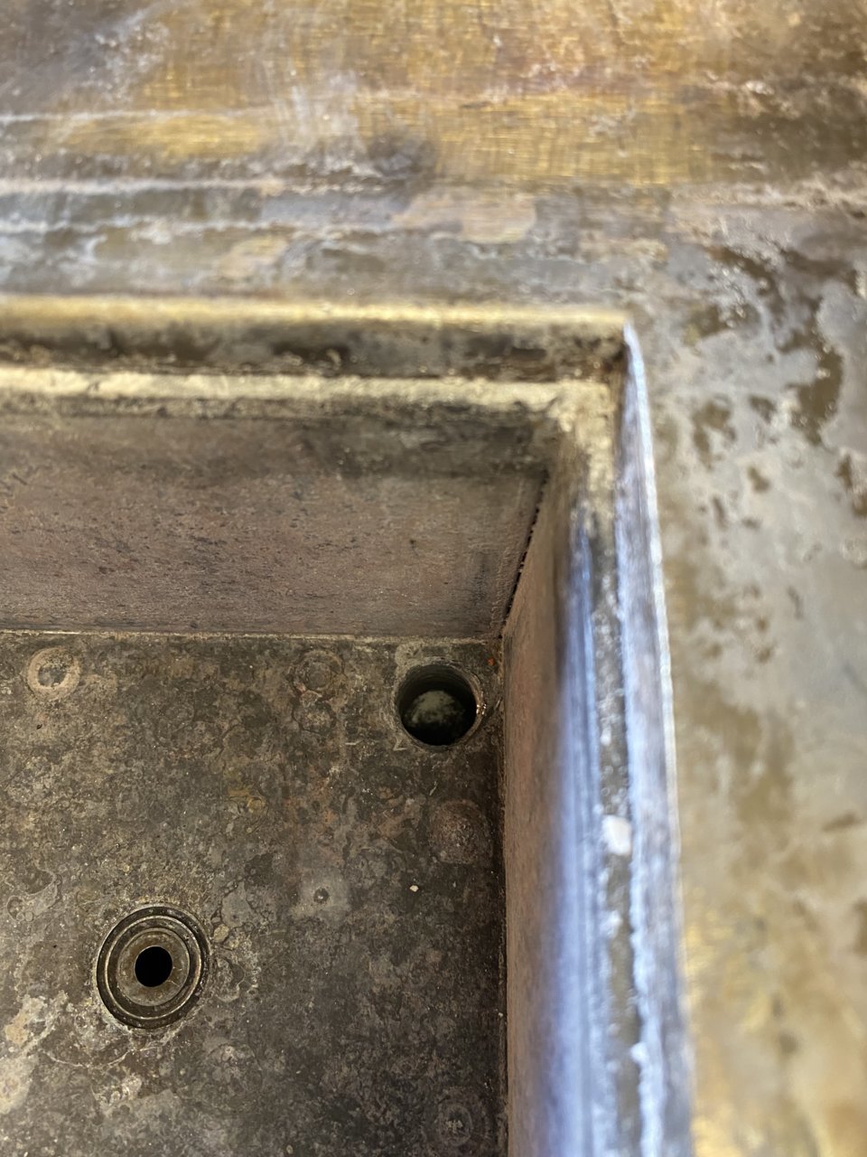

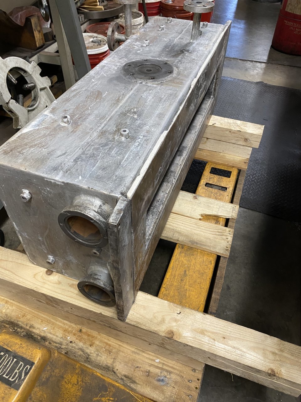

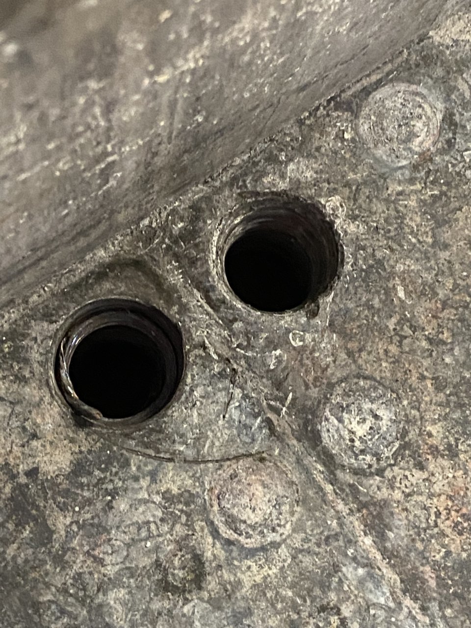

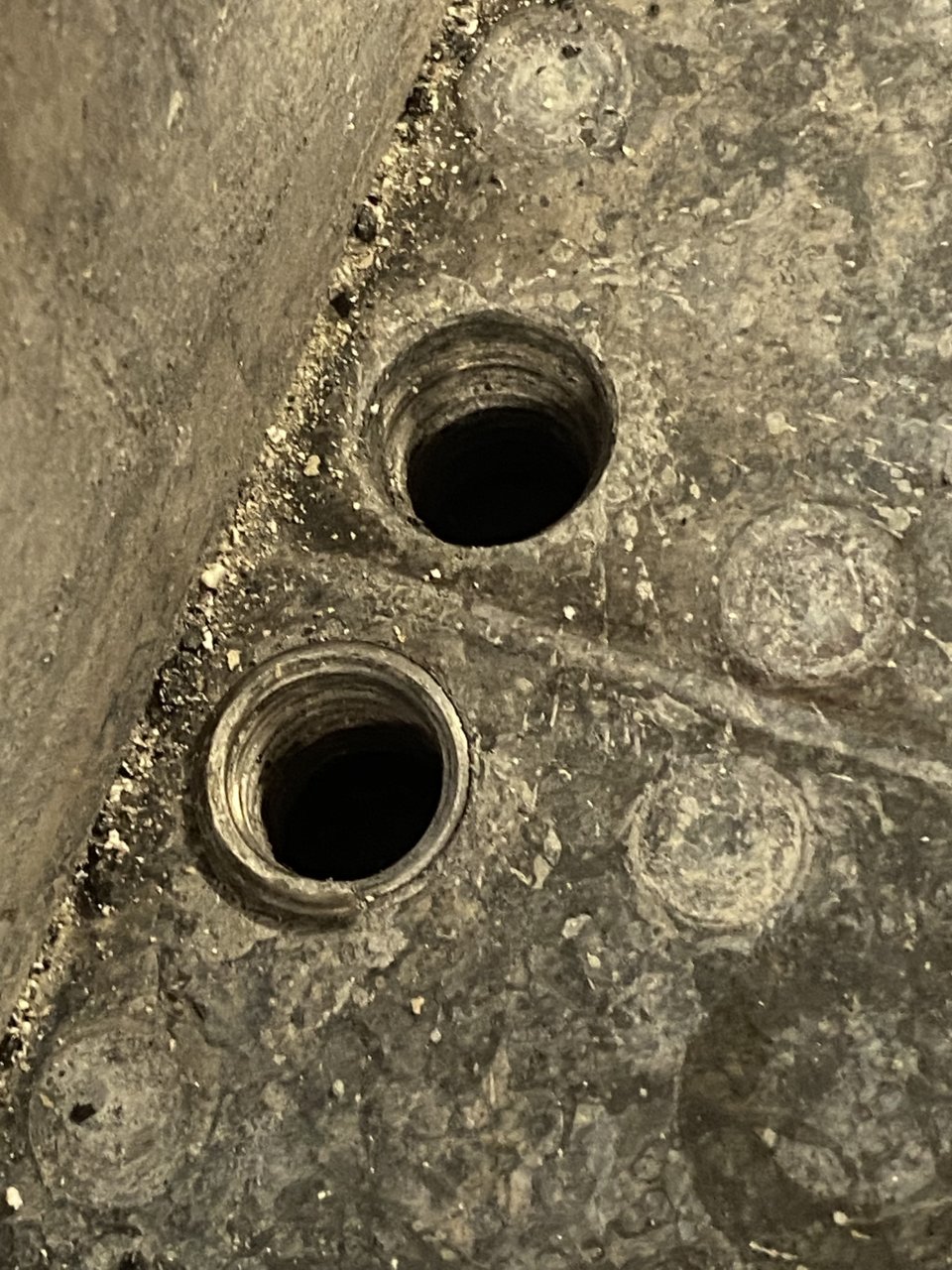

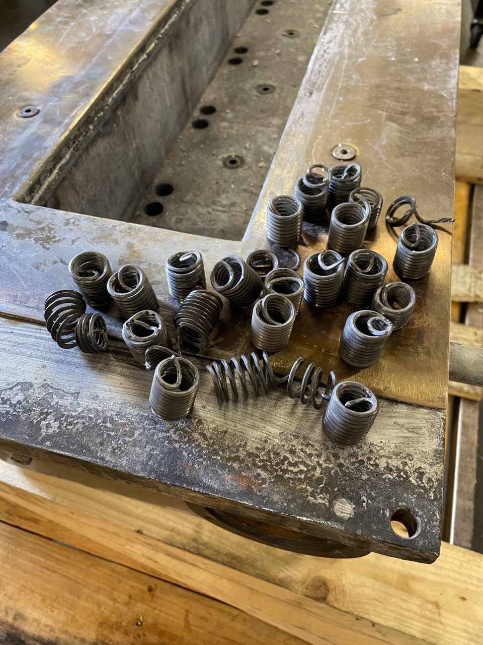

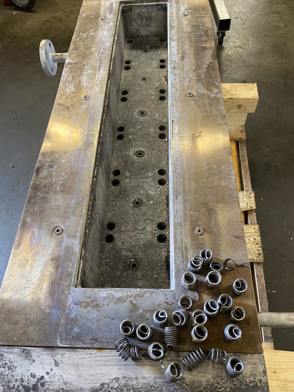

    Same thing I replaced the thread inserts the other day only this one had helicoils in it and the customer doesn’t like them. Got them out, now to drill them, tap them, and install thread inserts, X 24.

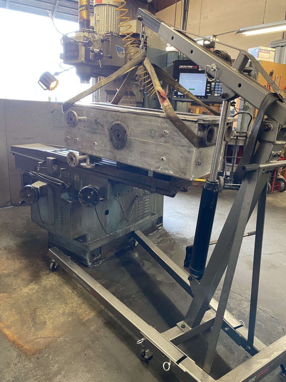

    Oh and we don’t have a forklift o_O
    Sitting on blocks it barely clears the guard for the limit switch.

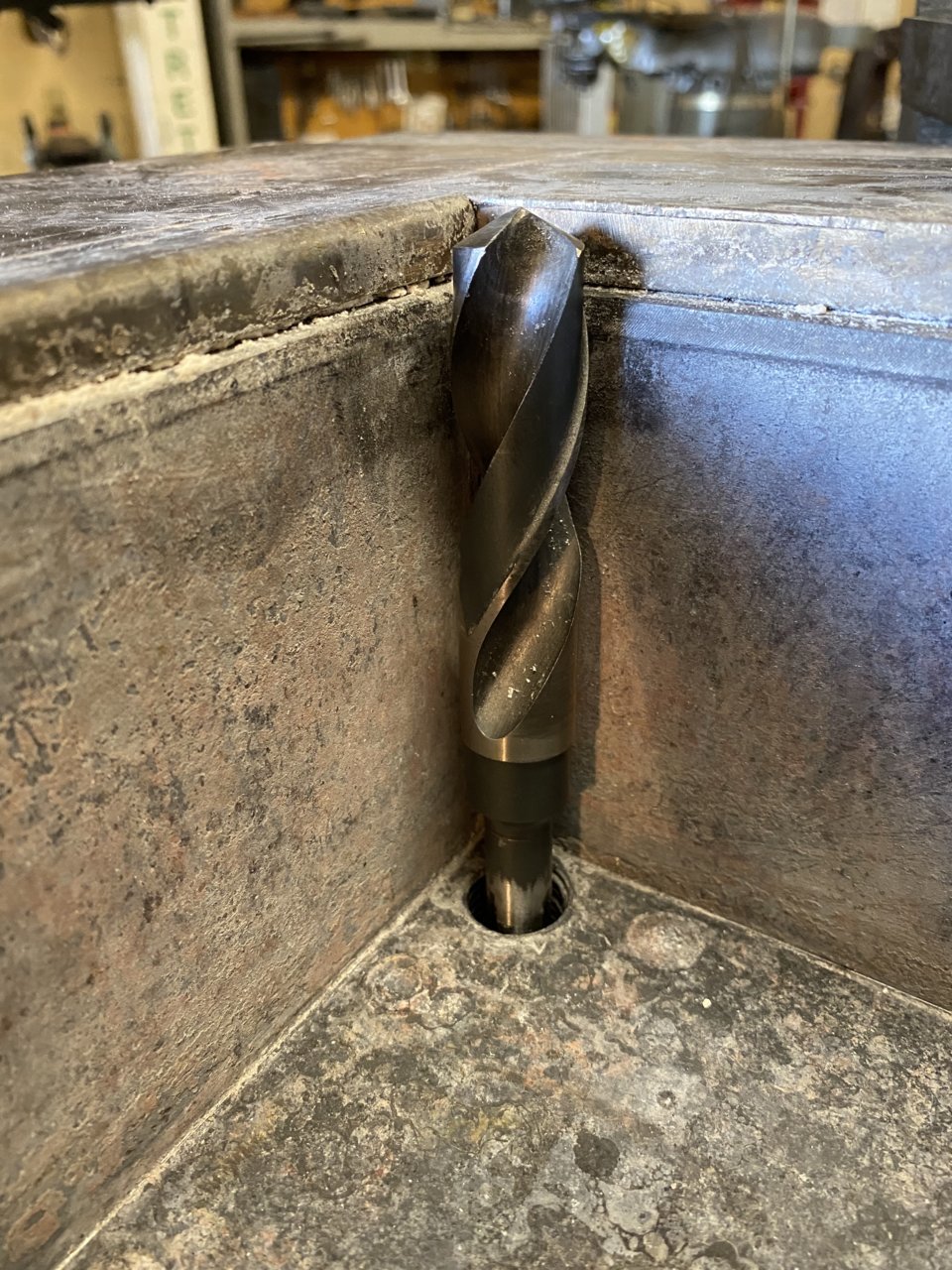

    I can’t remember anything anymore. Have no idea how I drilled and tapped the last ones unless they weren’t as deep as these. A 6” long drill but won’t work, not enough clearance on the sides to hold it and we don’t have a longer 13/16” drill. Plan B, or A. Haven’t figured A out yet :facepalm:

    Bit extender? The step on the shank should allow for the space of the extender's collar.
