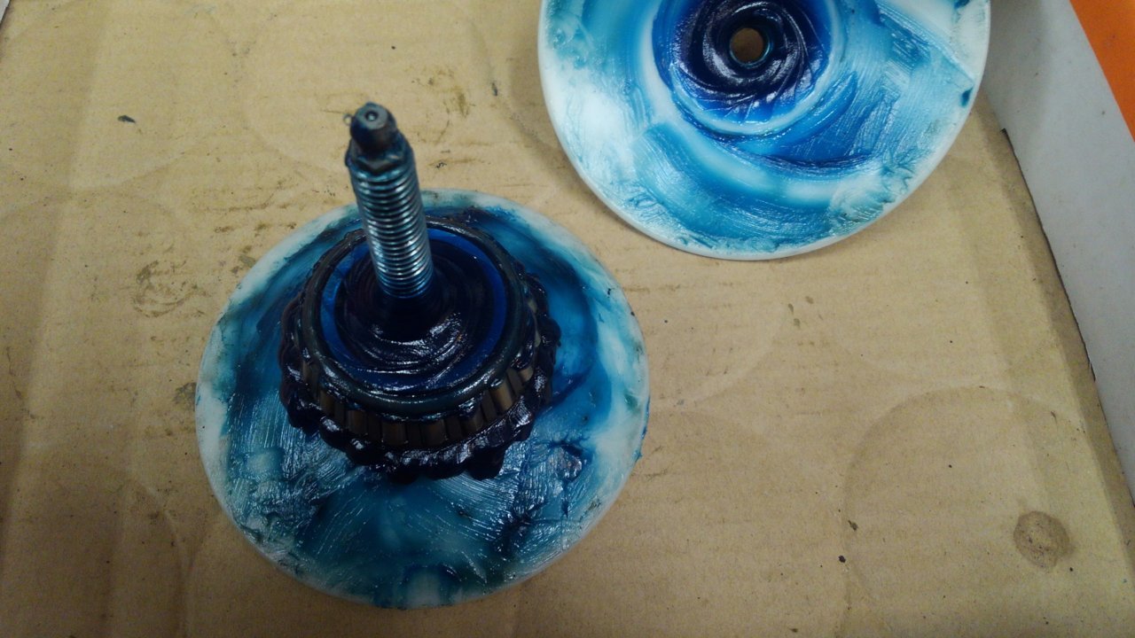

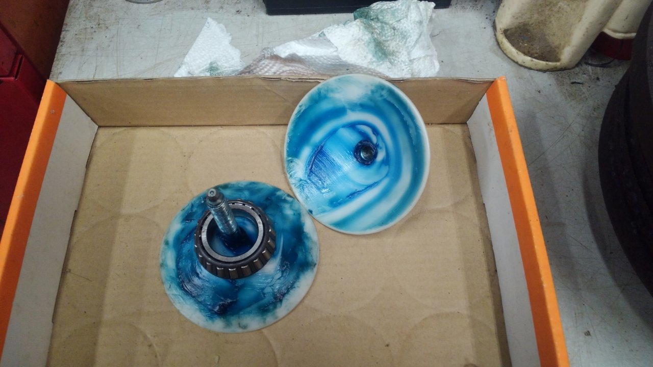

    Today's episode of Past Tech with Rusty has us finishing up the front brake repair on the old Ford wagon.
    One wheel cylinder had been leaking, combined with the brake dust the inside of the drum was a mess.
    Grease seal pops out then the inner bearing lifts right out.
    Kerosene cleaned up the bearings. You can use compressed air to gently dry the bearing but never spin them with air -- at best it damages the polished bearing surface -- at worst the bearing can explode in your hand.
    Said no guy ever "I like packing bearings" -- this tool makes the job less bad.
    You make a bearing sandwich and then use your grease gun.
    It is "less" messy than doing it by hand.
    New grease seals, use a small hammer with a block of wood over the seal to tap them in straight. Set the bearing (17-25 ft.lb and back off 1 castle for this application), use a new cotter pin on the castle nut and back on the road for another 55 years.

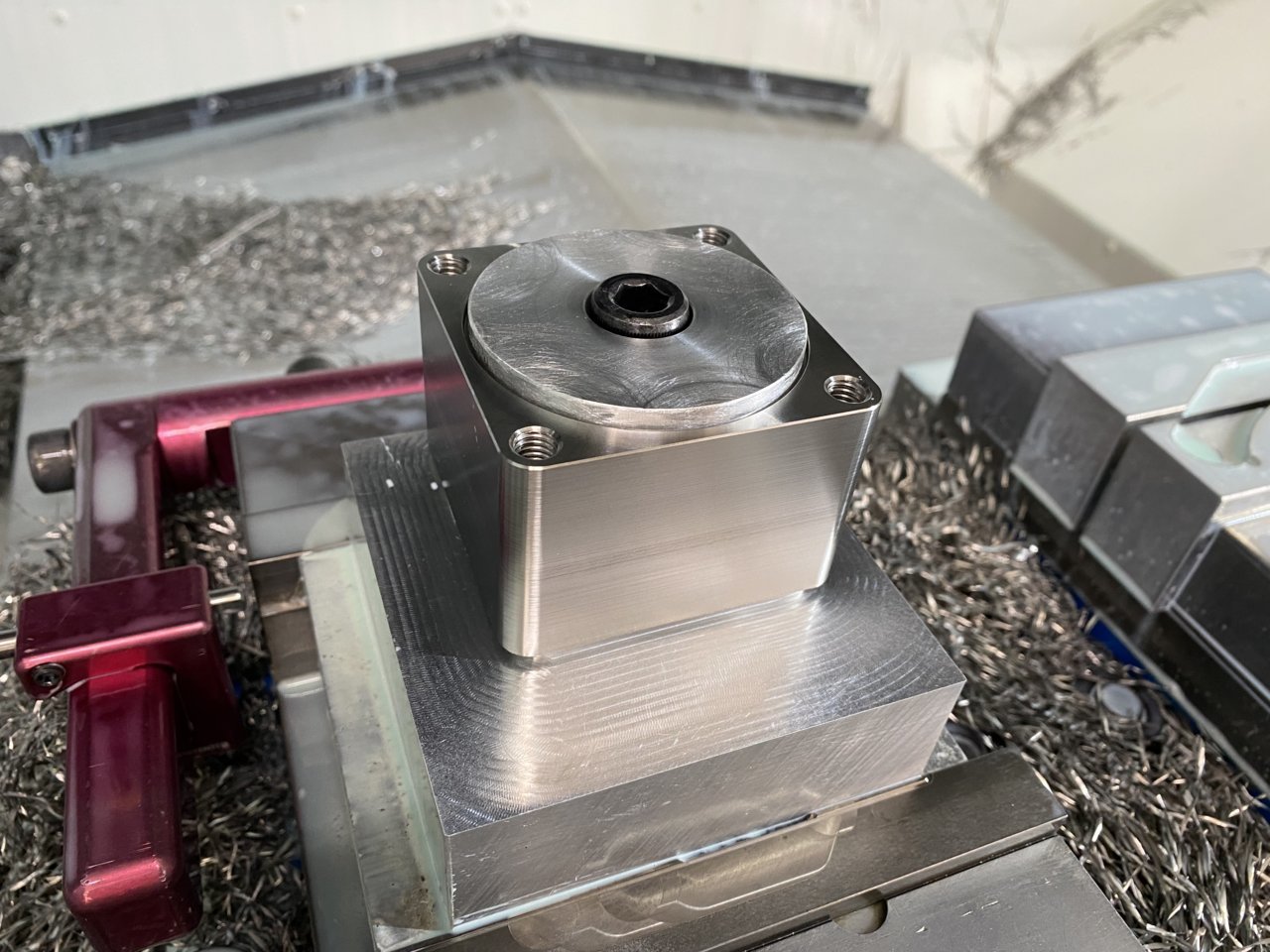

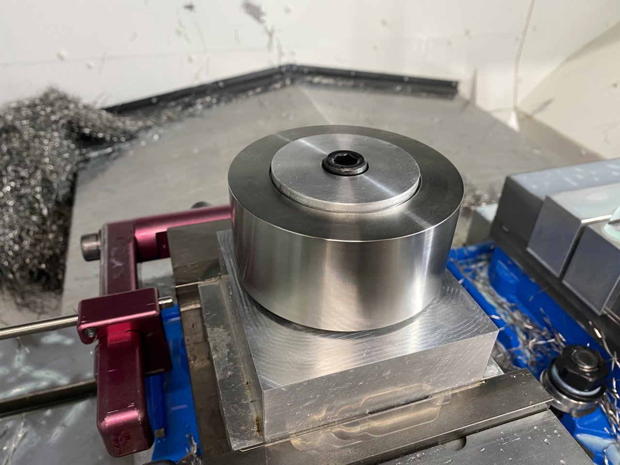

    Another day turning round parts into square. Started with 4” 304 bar, 1.8” thick. Finished size was 2.5” square. Lots of chips made on this one.

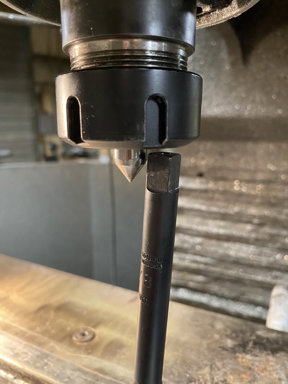

    There should be a 10” long 13/16” drill bit laying in front of my toolbox when I get to the shop :D
    I will have to make a tap extension.

    8 point socket or tap sockets. Saved my ass for years

    Yes sir, a 5/8” fits perfect, tried before I left yesterday :thumbsup:

    Drill bit problem solved, had to turn the shank to .750” so I could hold it, it was 13/16” like the bit.
