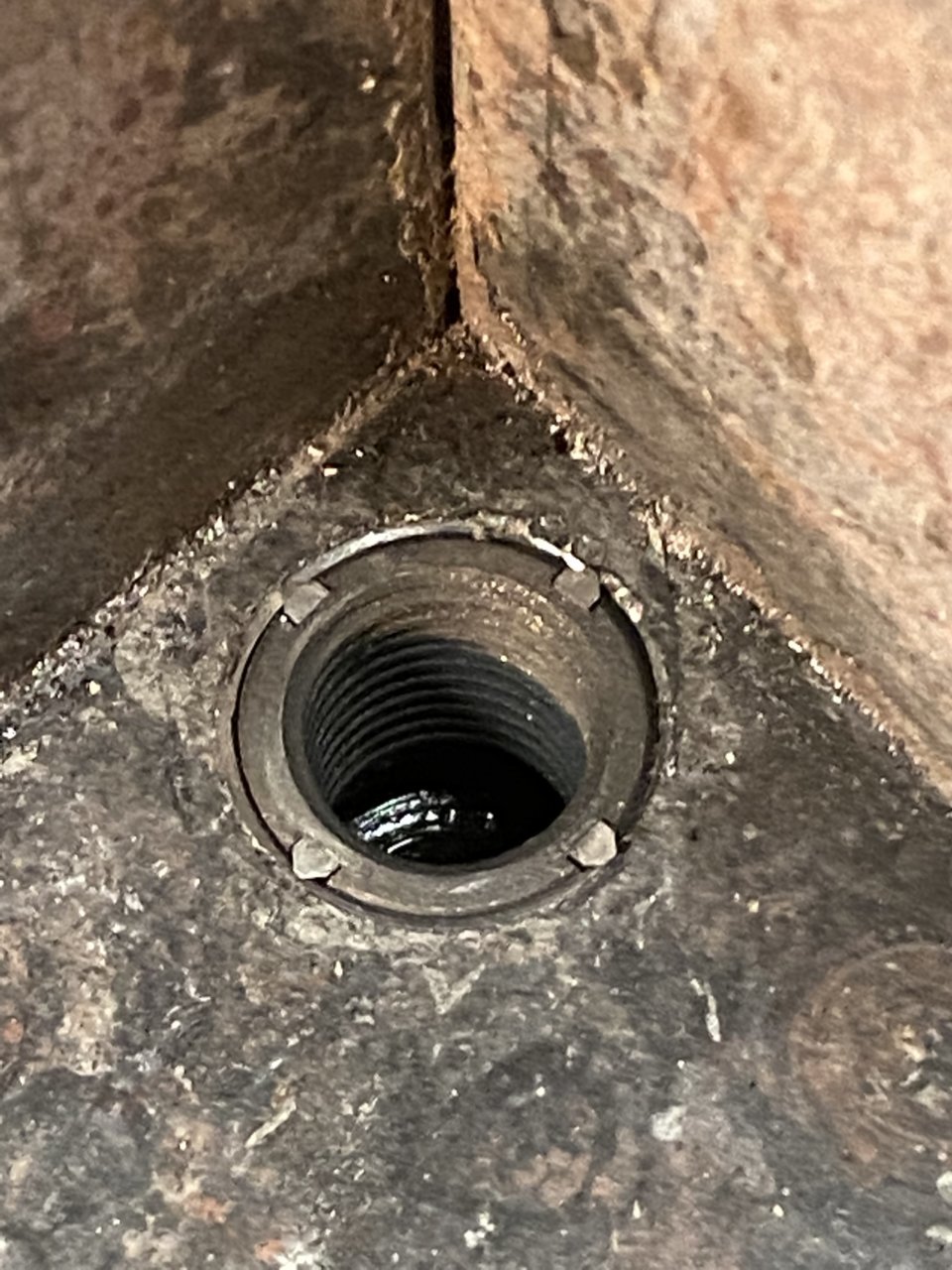

    You didn't mill 3 flats?

    Don't need them in a collet :rolleyes:

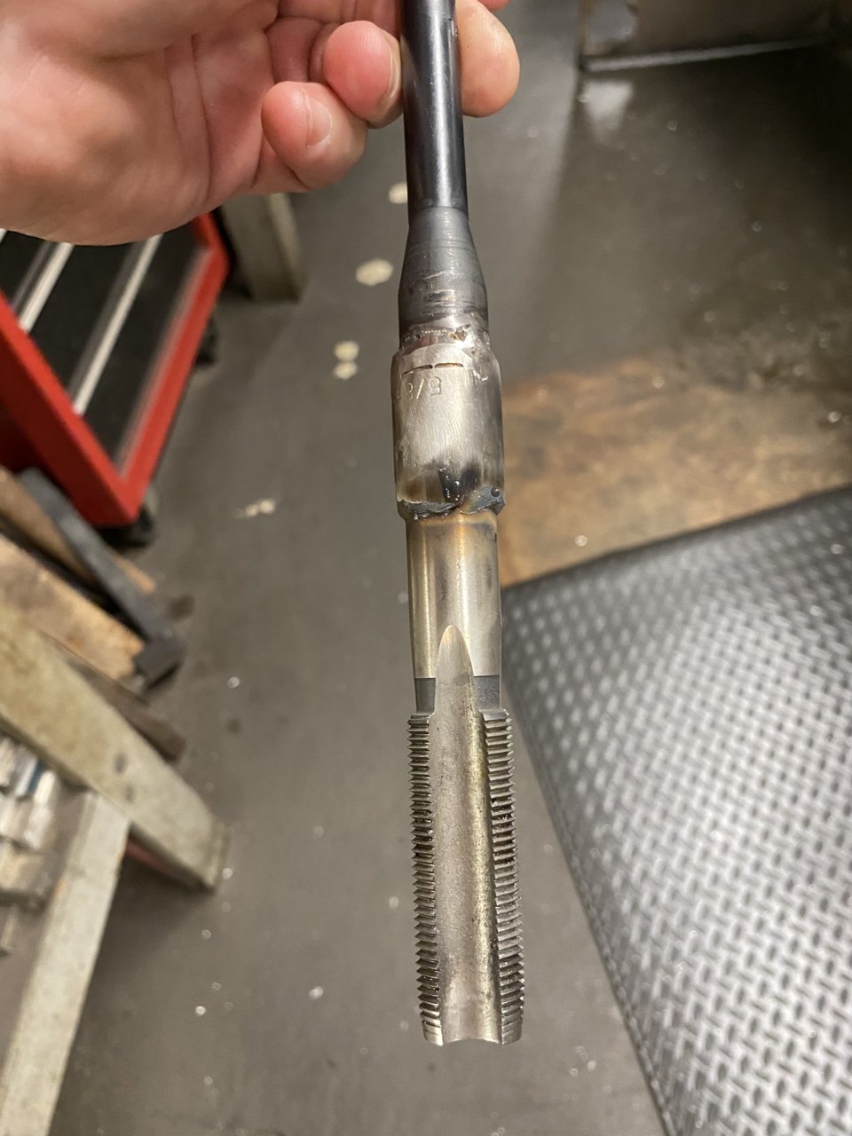

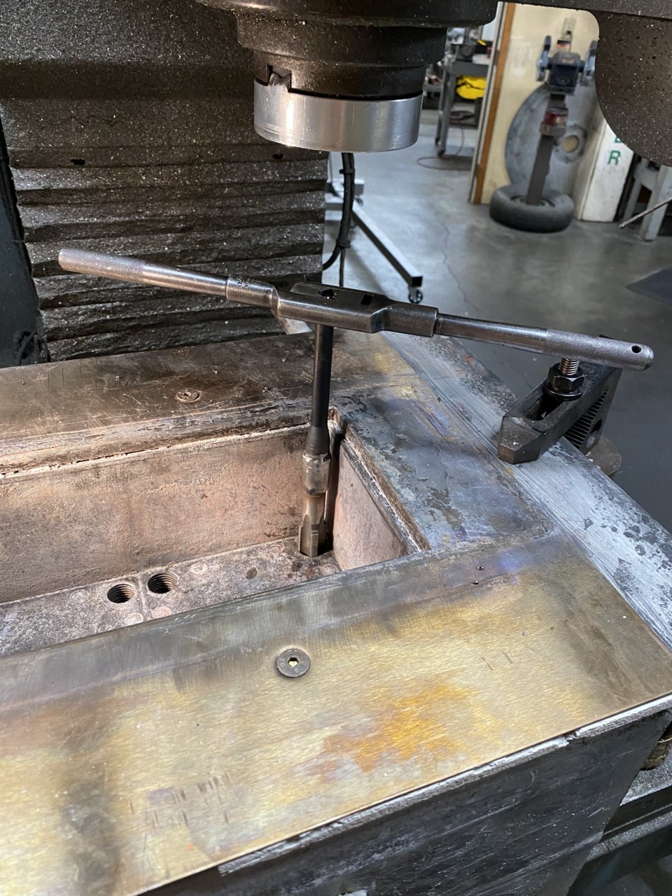

    Genetically modified the tap. Tack welded it then put it in the lathe and got it running true before welding it all the way. One done, 23 more to go.
