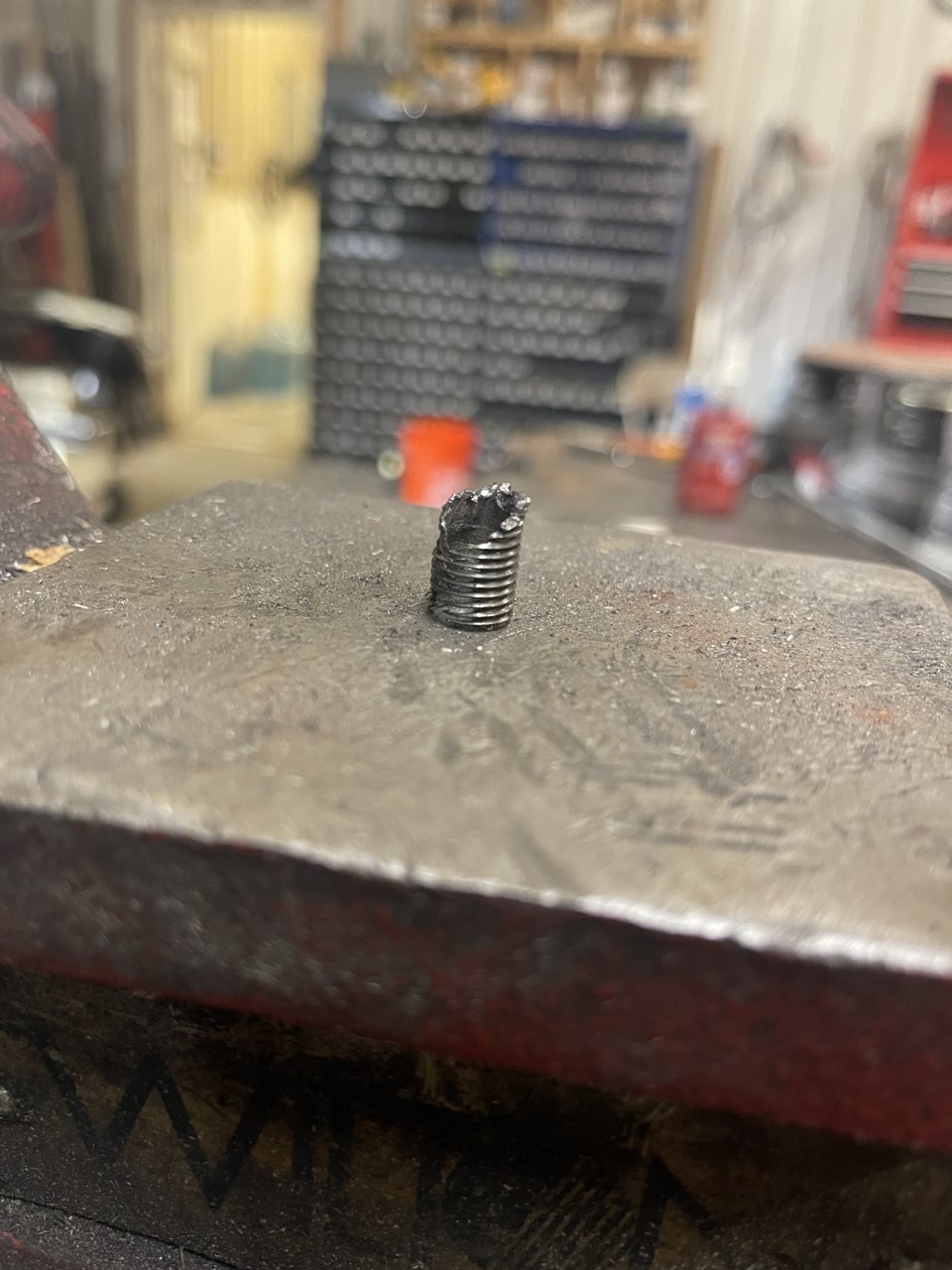

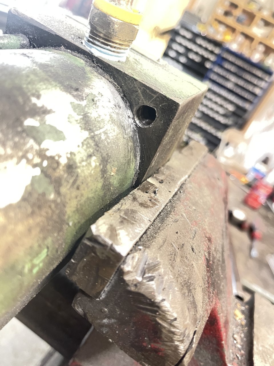

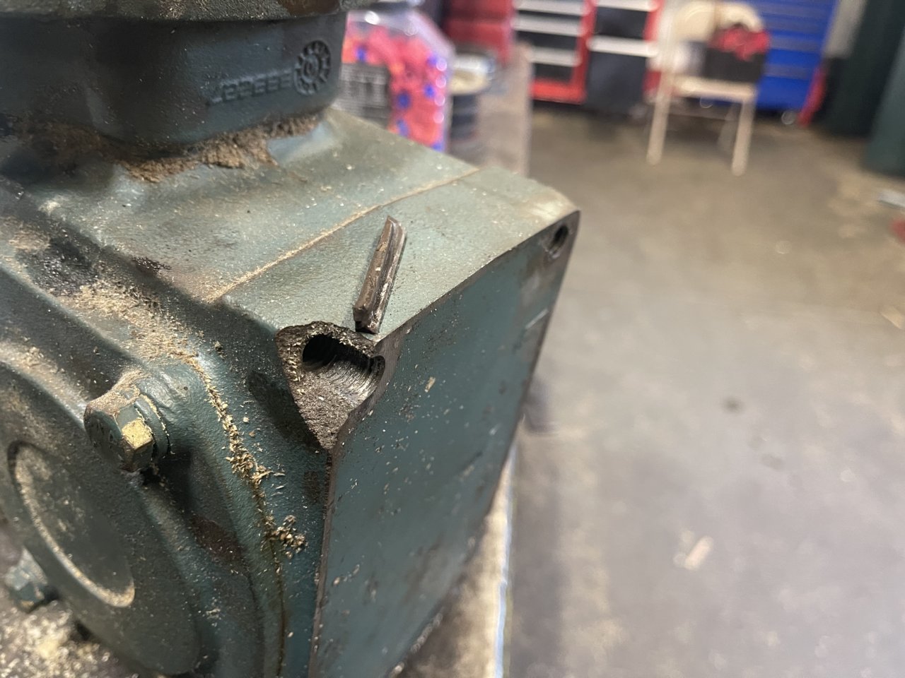

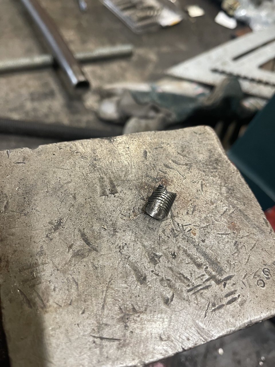

    Good way to start the morning. Having to do the classic hammer and chisel method to walk this sucker out. None of my easy outs fit due to the proximity to the barrel. It's coming... slowly.CB5A69AC-5823-4C99-B7C0-D418E6894459.jpg
    Edit: before anyone thinks I can't drill a straight hole, it came to me with the hole already drilled off center. I'm just the poor guy that has to finish the butcher job.

    Success! What a stubborn POS that was. As an added bonus, the new (used) trunnion rod threaded in perfectly! 452B6D04-DA1E-4BAE-BC80-982F3E05DD90.jpgF059FE29-7A1B-46F7-A793-48C5D2A02ED5.jpgF1681782-CAD7-490A-9F95-C4A8FCE486A4.jpg

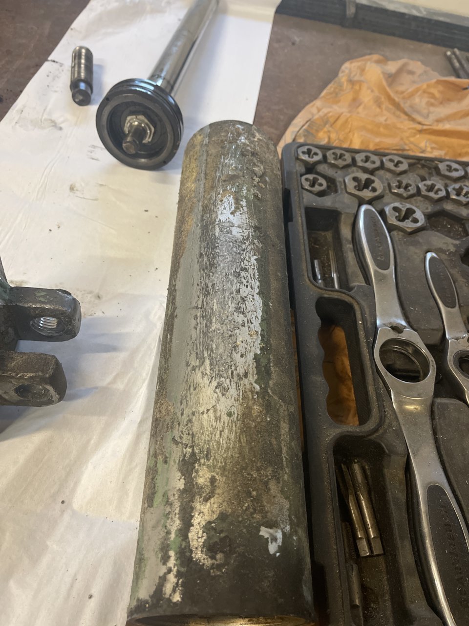

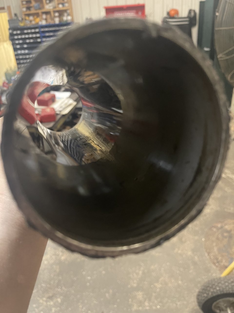

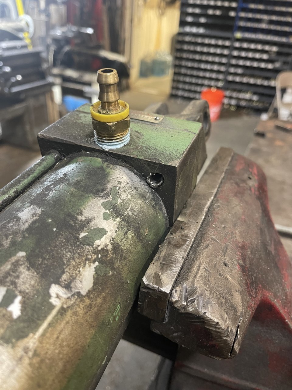

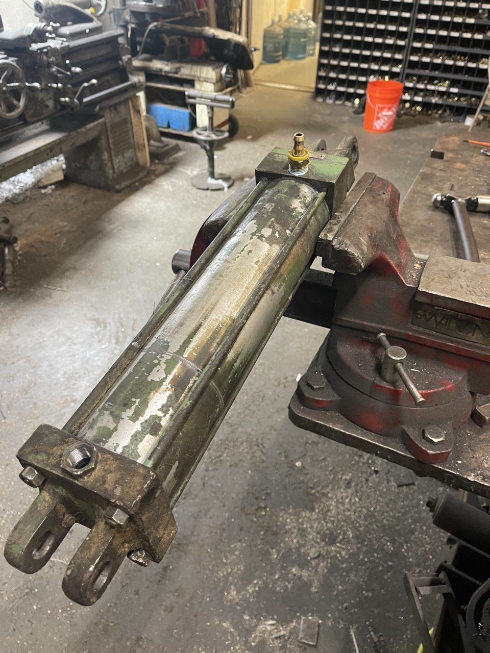

    The reason for this whole cluster f@$! is this was the replacement cylinder for one of our machines. The one on the machine started leaking air and we couldn't figure out why. Well I found the problem! Somehow the barrel of the cylinder cracked all the way through. 87B0B969-0964-4C65-BF7D-CF17E66A2A18.jpg

    Well, you are right at it bright and early on a Saturday morning! :muscleflexing:
    Looks like the cylinder is scored up pretty good along with the crack. Done in by contamination perhaps or damage on the outside in that area? Never know, someone in the past might have put the cylinder in a vice and made it egg shaped too.

    I've been at it for two hours already :rofl: the cause has been determined. At some point the mounting pin came out and the cylinder beat back and forth against a metal mount right on the barrel. Damaged the outside pretty well. Supposedly these cylinders are close to ten years old, so I'd say the scoring is minor given that. image.jpg

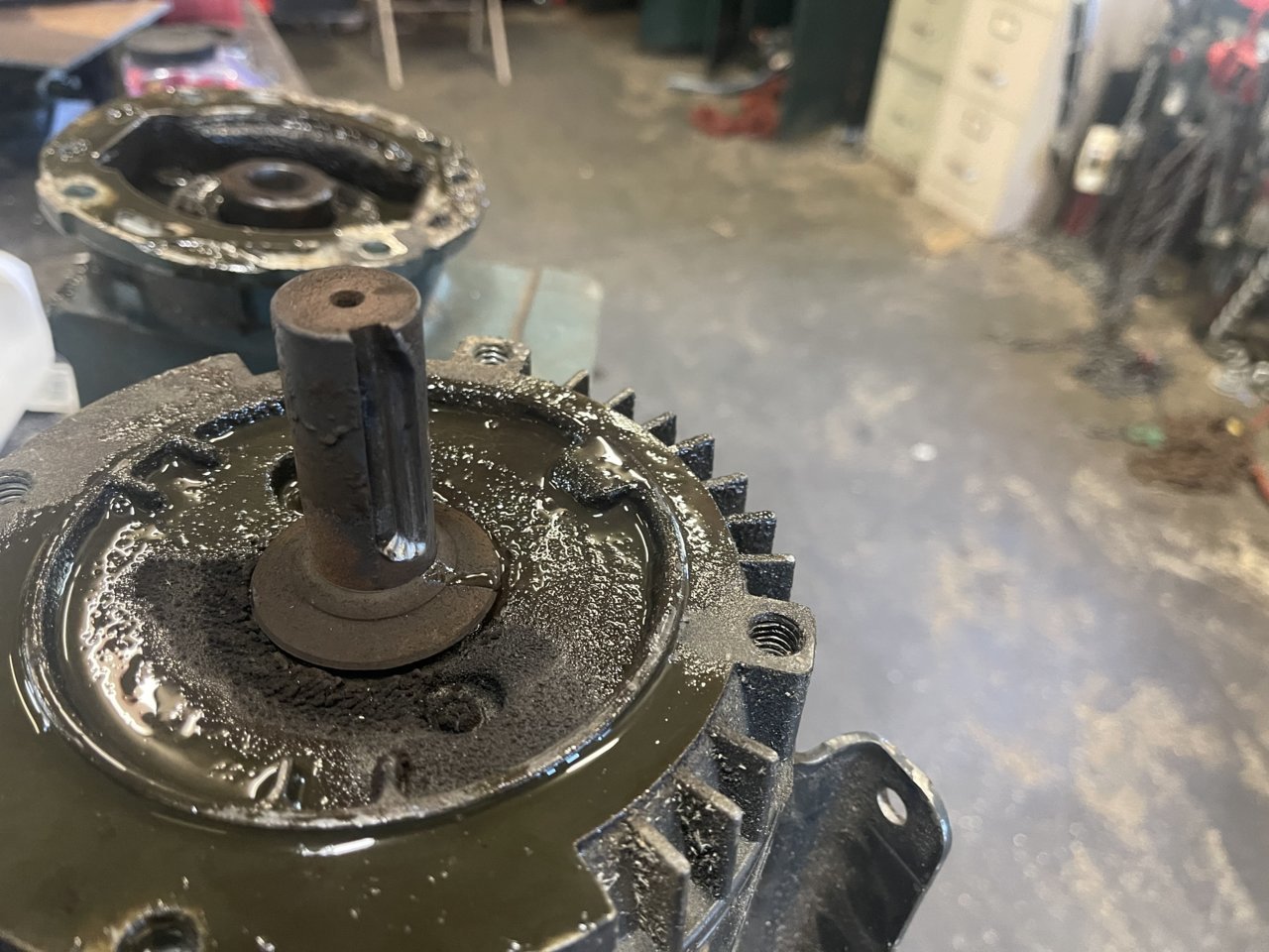

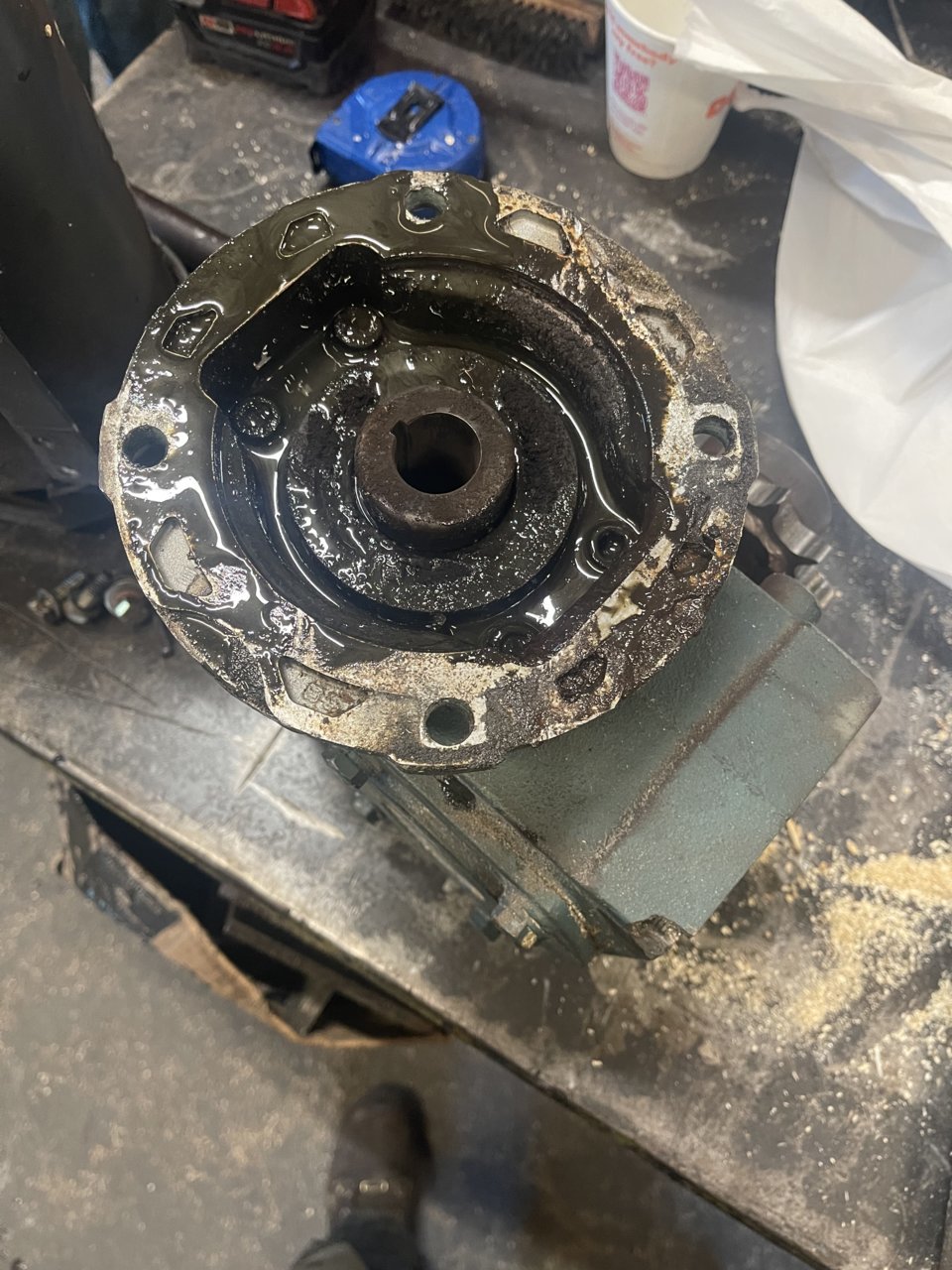

    Last fix for me today. Just replaced a gearbox and motor that committed suicide Friday afternoon. Blown seals and bearings in the gearbox, washed keyway on the motor. E944FF2D-2A53-4163-A4A2-50E68DC8F606.jpg1922C354-DA6F-47BC-A61D-F07F41B3B396.jpg36487C24-7C32-46E0-A0B6-6589F30D97DF.jpg
