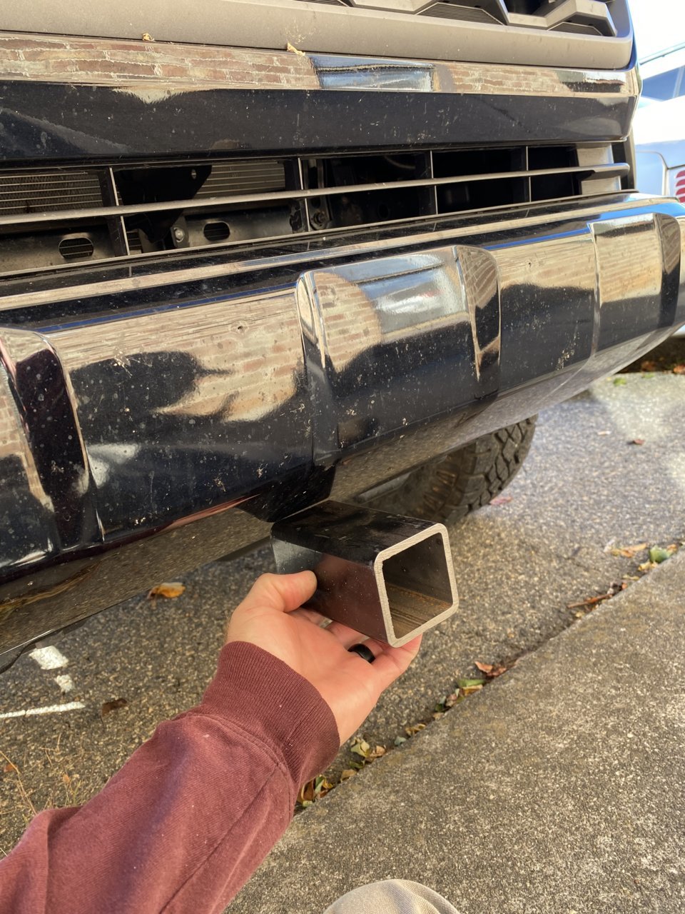

    I'm working on an idea for a front receiver for the winch and deer rack. I don't want it to high or to low......... :popcorn:

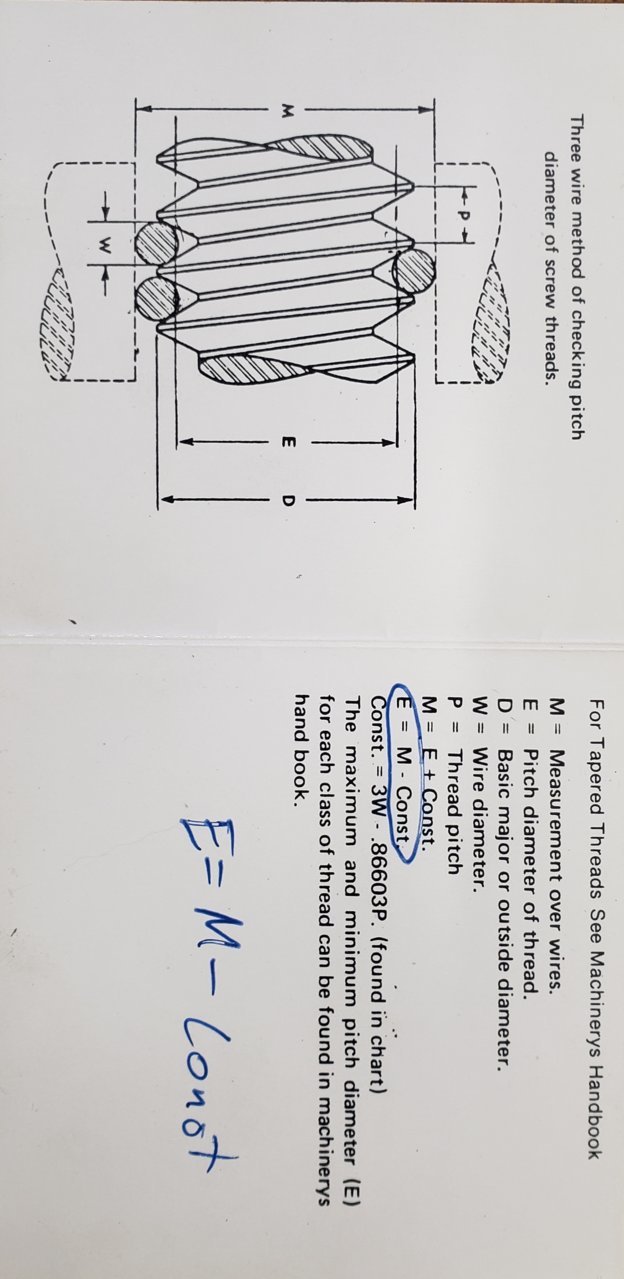

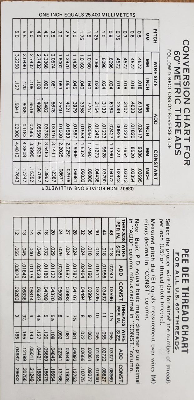

    That helps, thanks @nagorb
    I had a little more time to study that chart you posted, pretty much the same as with the wire set. I'll chuck that piece up afternoon and see if it, all adds up:thumbsup:

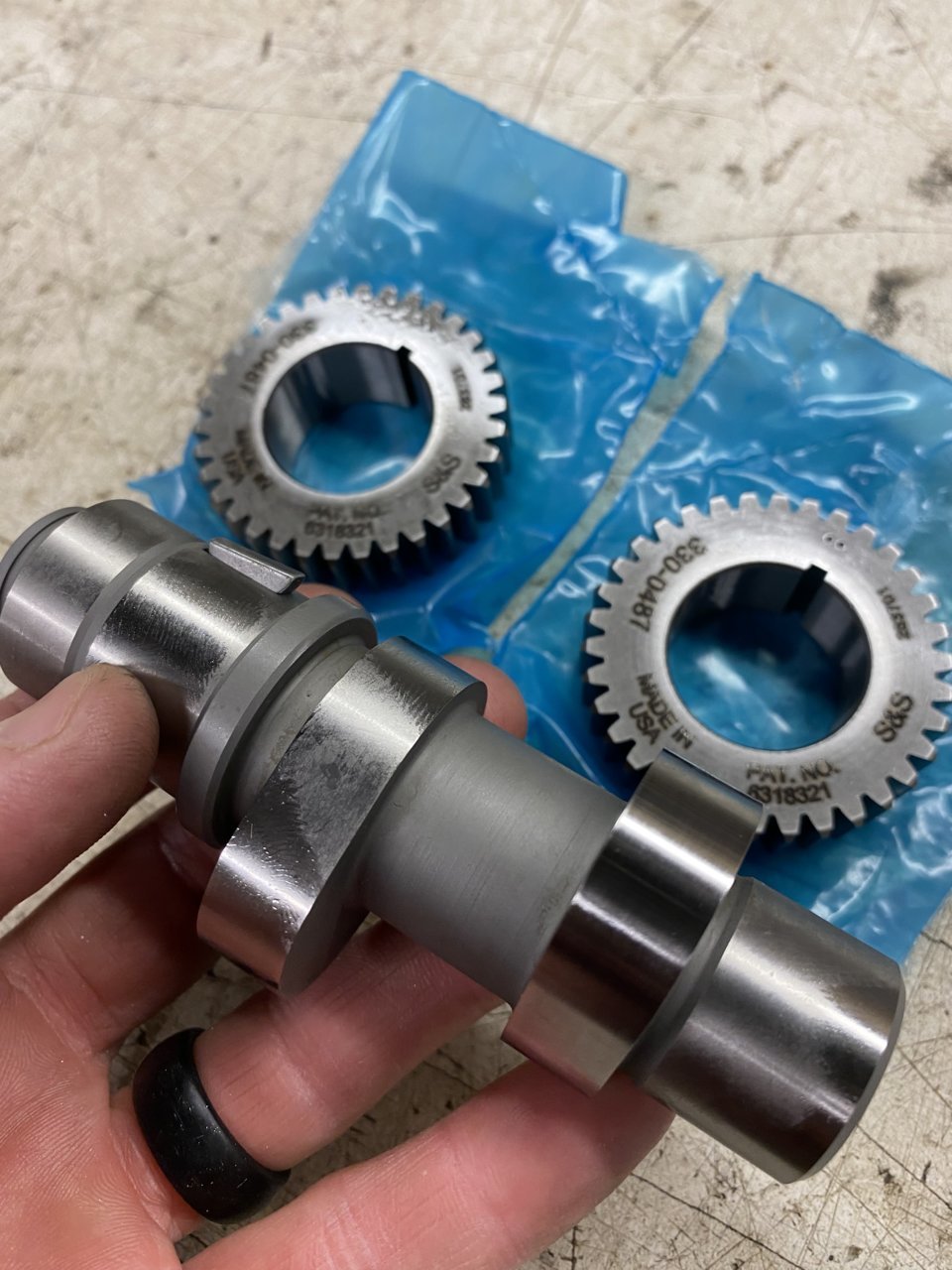

    Customer brought 2 of these S & S cams and gears by and wants me to press them on, I measured them and they have a .0025" press :eek:
    They also have a woodruff key to keep them from turning. I put the cams in the freezer, hopefully they shrink to about a .001" or less press :rolleyes:

    You can warm up the gears on a bearing heater too.
    If you don't have a bearing heater -- put a 60 watt incandescent bulb in a drop light with the hood removed, put the light in the vice bulb up and set the gear on the bulb.

    :eek: That's a lot of press! You know one thing; once they're on, they're staying on.

    He came and picked them up, he said he knows someone who knows how to get them on. I said I know how to get them on, you can keep all the pieces when the gear explodes too :D
