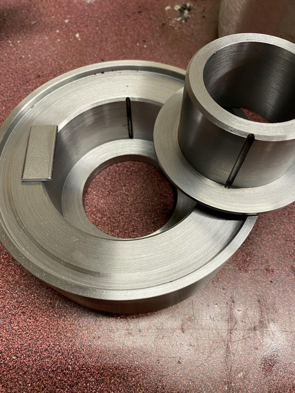

    Somebody tell me what I’m doing wrong. These have to be water tight. They are cooling jackets, tig welding them and this one just cracked. They have a hollow cavity inside and get machined after being finished in the lathe after welding. I cleaned them with lacquer thinner before welding, inside and out to get any trace of oil/coolant off.

    Here’s the inside, a little blocker plate is in there then it gets machined and two pipe thread holes for the coolant. :annoyed:

    I don’t know, I don’t think our tig machine has enough oomph to get good penetration. May send them to another shop, they have a big tig welder.

    irregular cooling?

    This is what I thought. He may have to heat the whole donut to 500º+ to be able to continuously weld it.

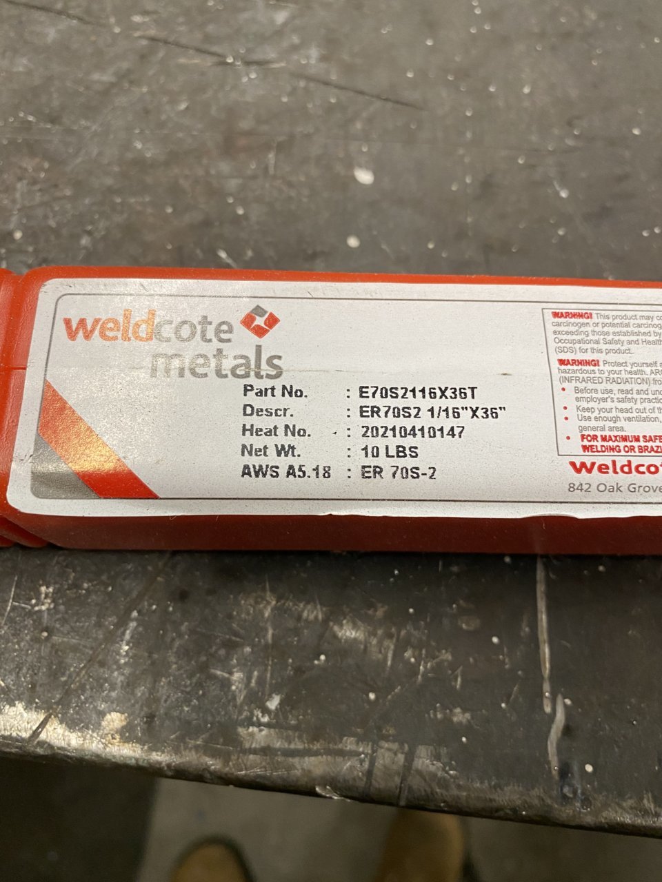

    What filler metal are you using ??
    A slow cool down might work the filler cooled faster then the piece causing the crack from what I see in the pictures

    WTF? That shouldn't crack like that. I agree with the pre-heat; toss it in the over for an hour on 450. Since that part is AFU, sacrifice it for analysis and see what the penetration is like.
    Edit: I see it now, on second look. The outer sleeve is so much larger it's heat-sinking the weld too quickly. It needs to be nice and hot, and then cool it in a sand/lime/ash bath.
