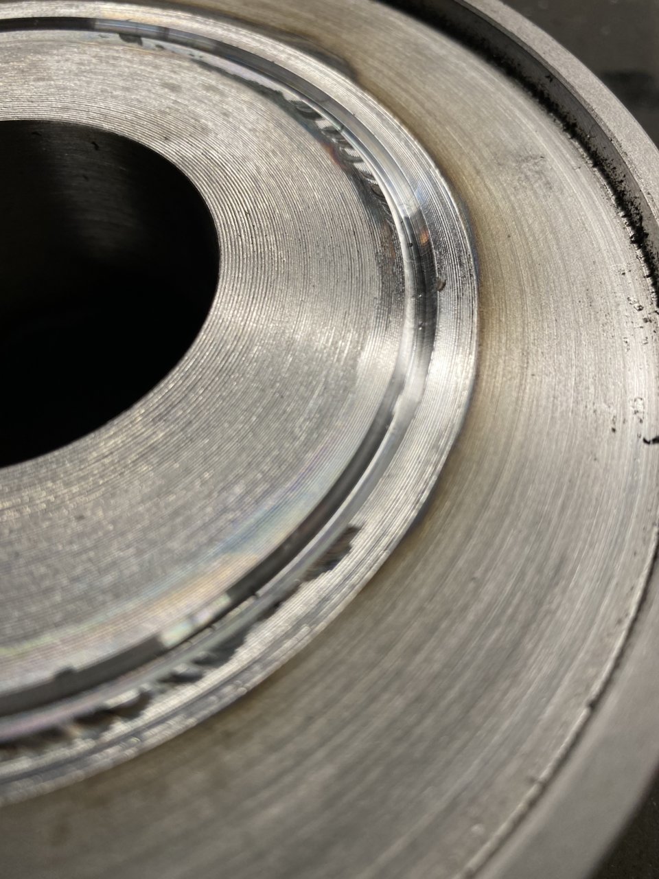

    Went back to the rim. First one almost done.

    We are gonna try and save it. Too much work to chunk. Lathe guy grooved it back out for me.
