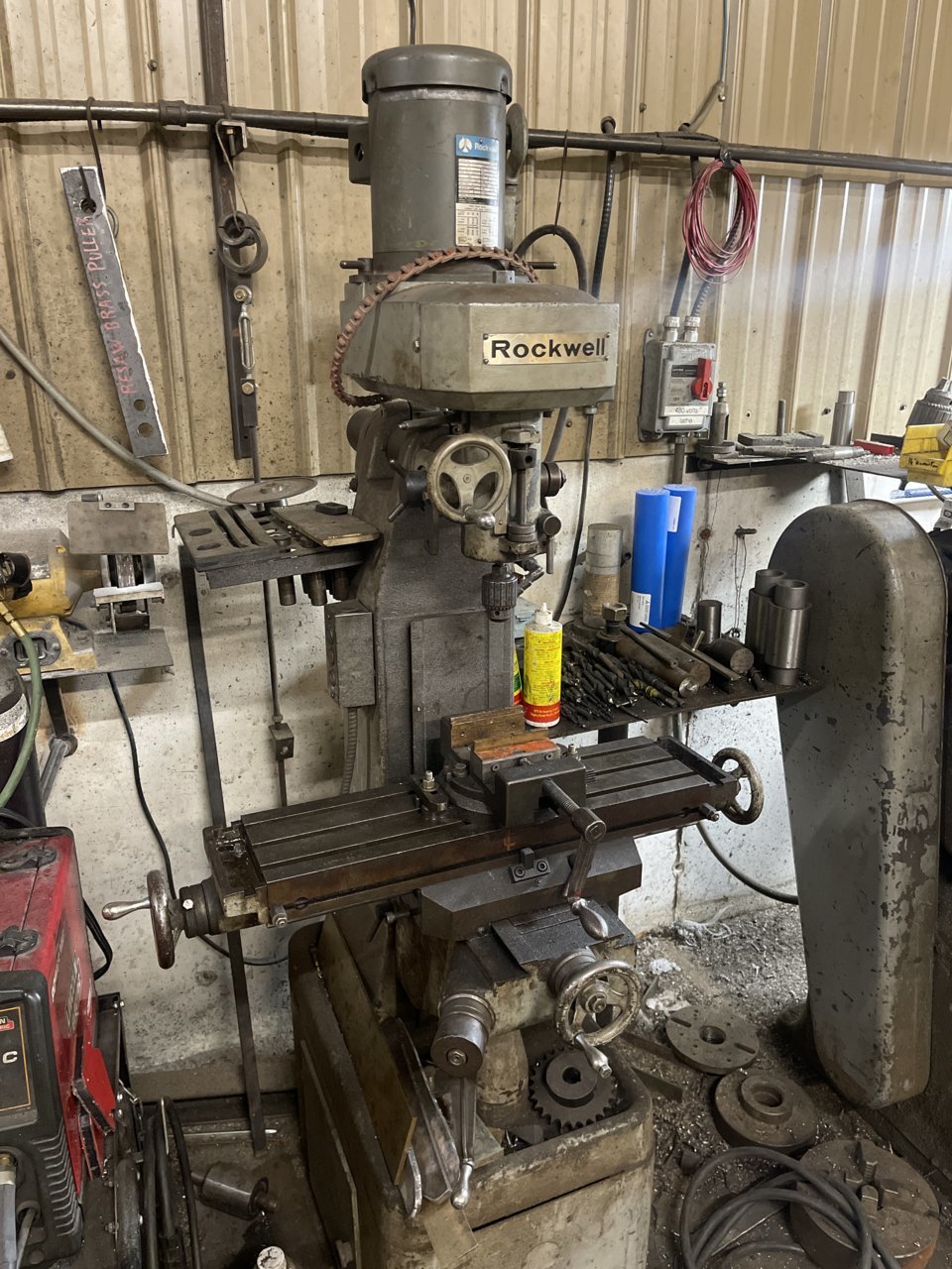

    It's also keyed to the roll, so I get to cut the belt apart, pull the entire roll, and make a new shaft. Here's hoping the endmill is sharp!

    Could try weld build up and turn that one back down. Just a thought. Weld lengthwise beads 180° out from each other work your way around.

    I thought about doing that, but it would probably take me longer to do that than it will to make the keyways on a new shaft.

    Its worth mentioning I've never used an endmill before... and our milling machine is all manual. It's a 1/2 in keyway and I've found five 1/2 in two flute endmills. We'll see if AVE and this old tony have taught me enough to make it through this.image.jpg

    I always touch my end mill to the shaft and get it to where it’s touching/cutting full width before going half the depth of the key, just in case you didn’t know. Not trying to tell you what to do :thumbsup:

    No better time to start. Got edge finder? If not there's other tricks to get you on center.

    Nope, sure don't. I figure between a plumb bob and my eyeball I can probably get it close enough for a BFH and grinder to do the rest.

    Got a longer dowel pin or something to touch on the side of the part? Raise up and go diameter of pin should put you in ballpark to edge, zero again and go half shaft diameter.
    Edit, HALF DIAMETER OF PIN, sorry

    And since going full 1/2" width right away, and possibly not the best EM, could go less than half depth. Few passes. Speed Kills a old timer used to tell me. Dial caliper depth of keyway on old shaft, generally they're 1/2 key width so .250 in this case but that's not always true.
