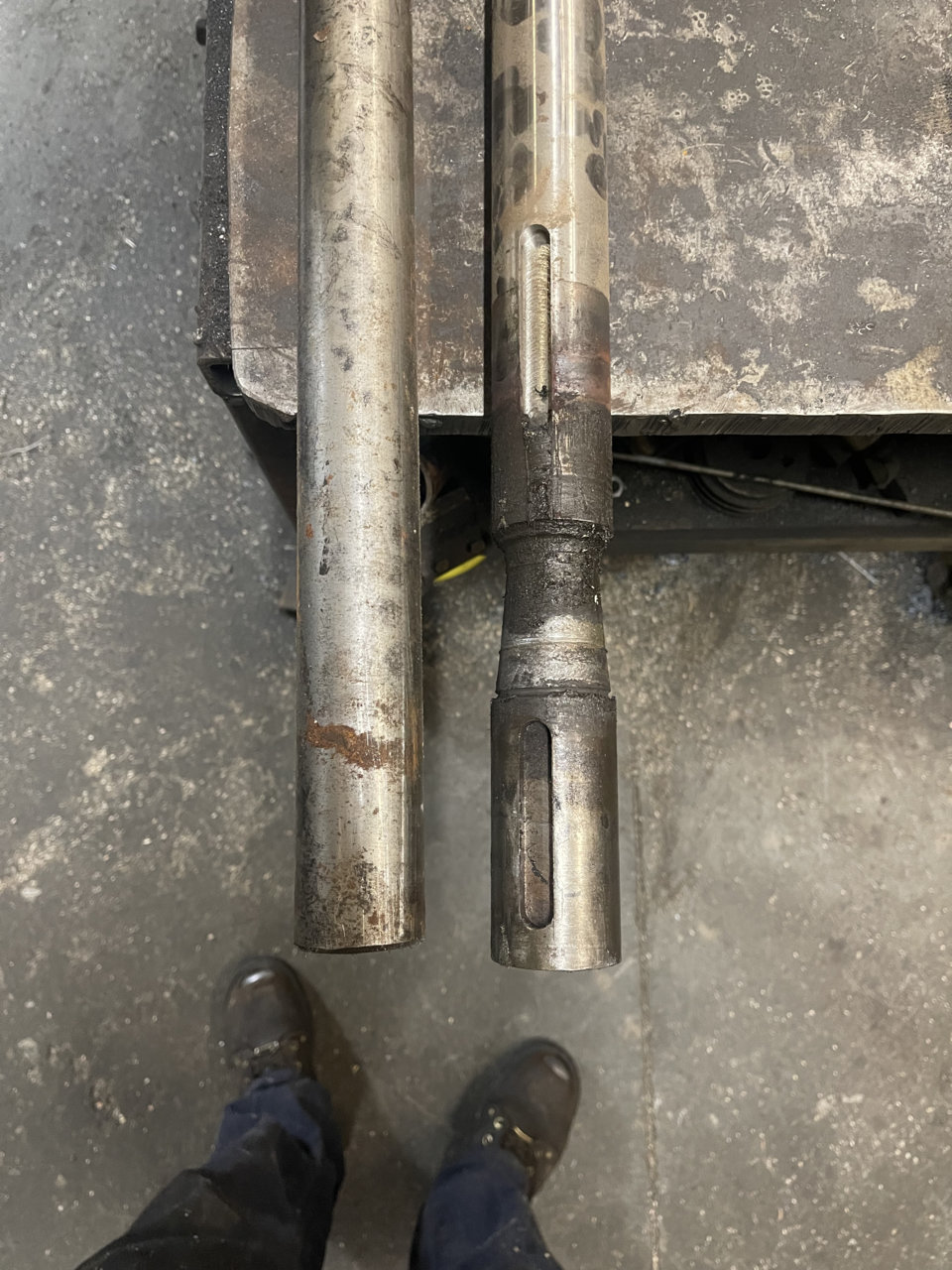

    It is indeed .250 deep.

    Cool. I edited my post but you probably knew, if you use a pin to go against the side of the part the half the distance of pin.
    Another thing is drop the spindle down a couple inches and lock it, feed up with the knee.

    In addition to locking the quill, you could run that threaded stop up against the upper stationary piece. Just keeps the quill from creeping down, and get endmill tight in collet, I've seen end mills suck down too. Most 2 flute endmill are center cutting but if not you can ramp depth...lol, bananaman prolly scratching his head now.

    I mean... I follow 80% of it. Still getting the old roll and shaft apart. Had to cut the other bearing off as well.

    Just holler if you need help. I'm assuming you have 1.9375" bar stock and don't have to turn a piece of 2" the entire length. ?? You may reconsider a weld up patch job?? You'll get it done.

    I do have the stock, here's the new piece next to the old. E1943399-9147-4C1D-8905-700711E10F0B.jpg

    At least look at the cost of those frame repair patches? A local shop to weld them in? Might be the cheapest fix and get you by for awhile.
