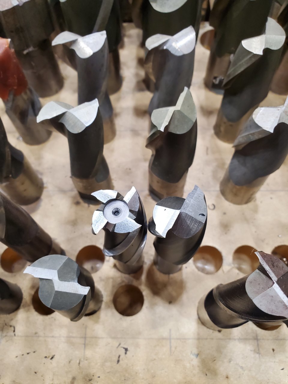

    Looks like this one.

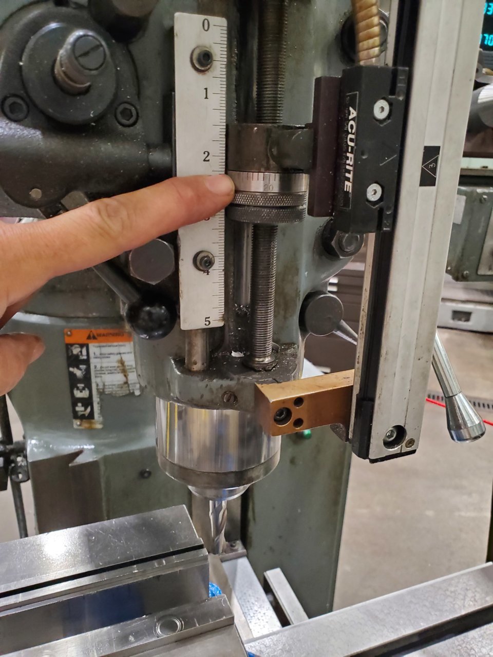

    Non center cutting and center cutting end mills.
    Unless I'm hole drilling or tapping, I keep the quill up or not down more than a few inches when milling, it's all about rigidity. And the knee is more accurate with it's graduation more so than the rule on spindle.

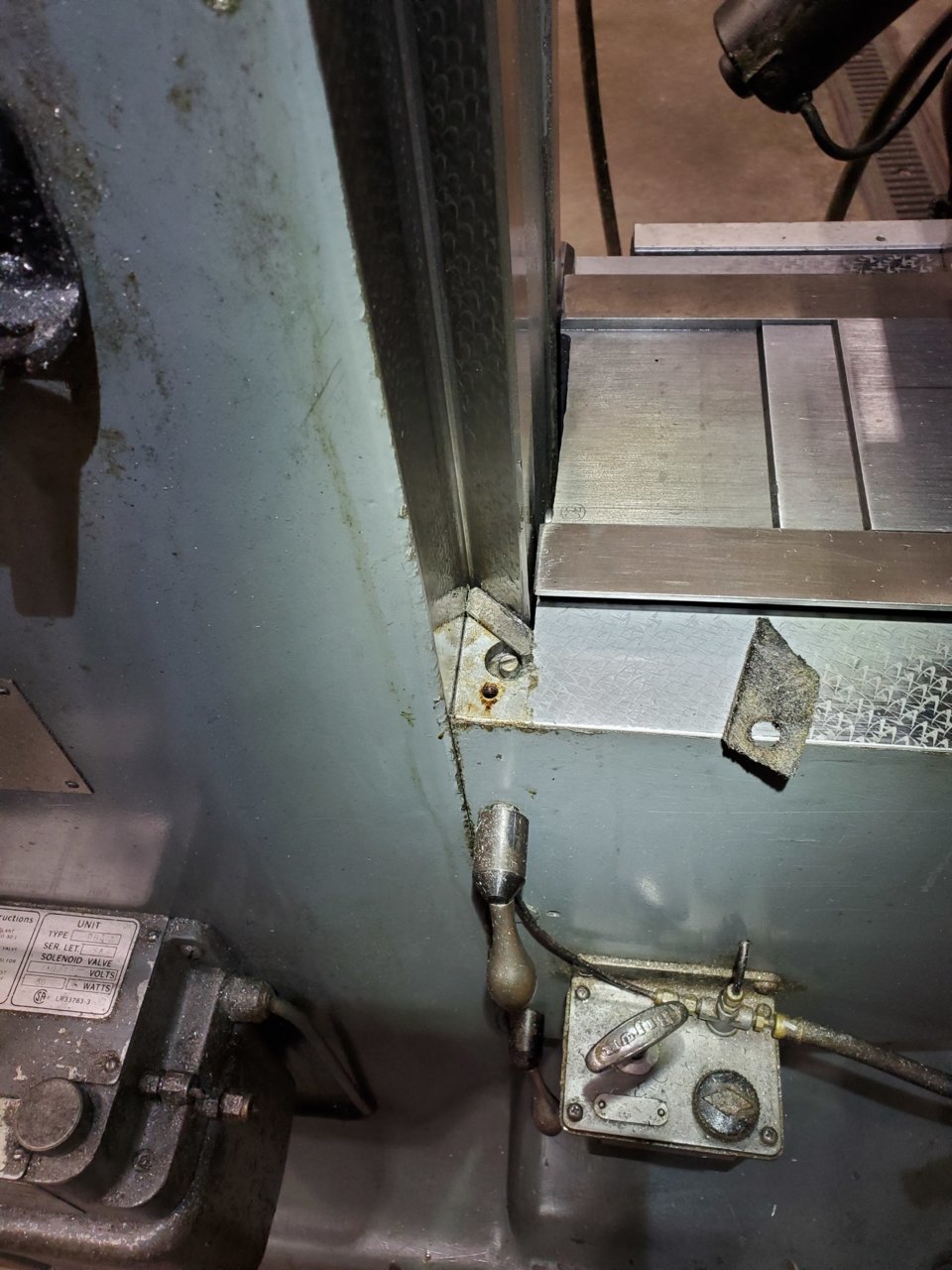

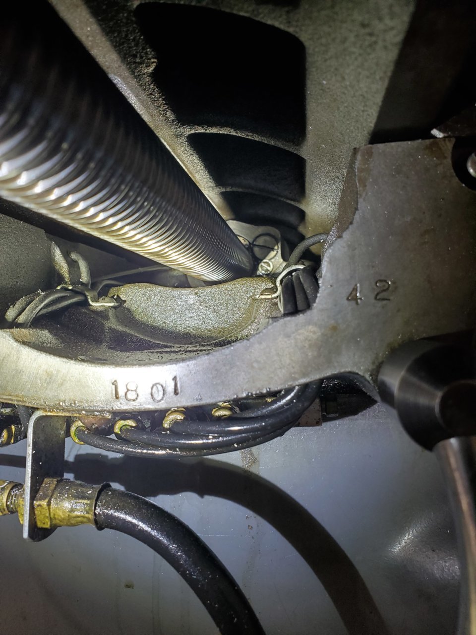

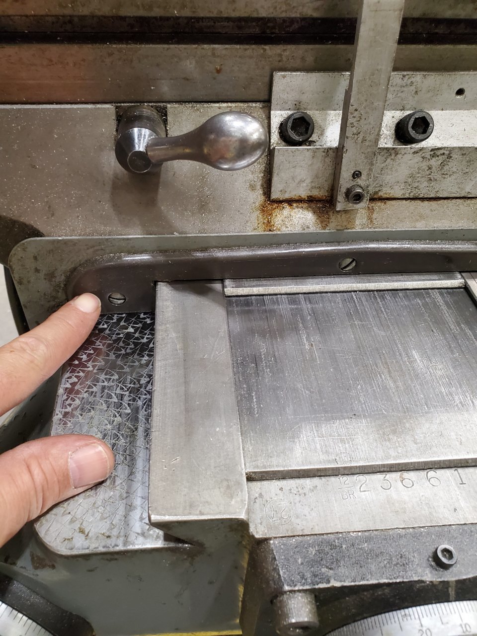

    Here's a couple of adjustment points on a Bridgeport Mill. Adjustments will remove someone the slop. 20211124_111112.jpg 20211124_111150.jpg 20211124_111325.jpg

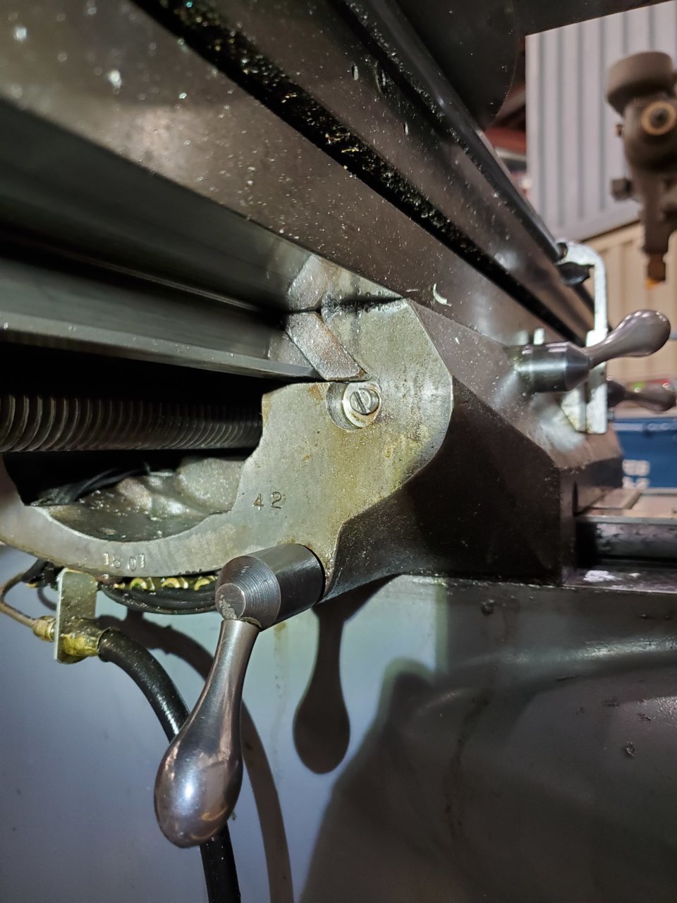

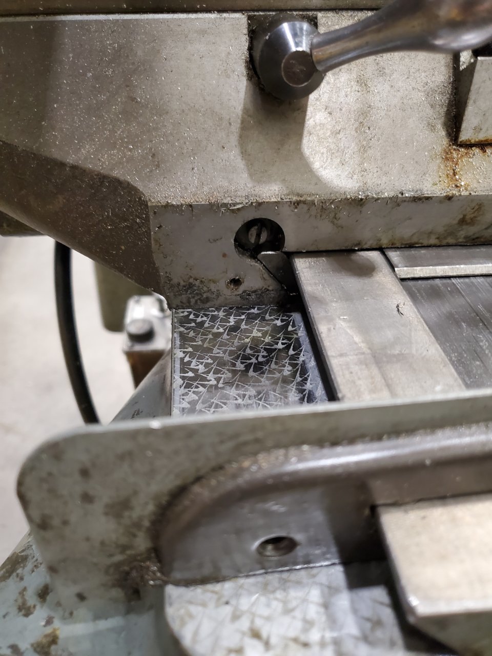

    And the last point of adjustment on the knee. They need to be tighten down a little at a time and run through the range sometimes. Otherwise they'll be to tight to move in one spot.20211124_113739.jpg

    This mill has .130" slop in the x axis. Not good at all! I've replaced the nut before but now I'm thinking there is a way to get more adjustment by taking it back apart and splitting the nut, then put a screw in it to drive the two halves apart. Uncharted territory for me....but I'm not scared. A different day though.
