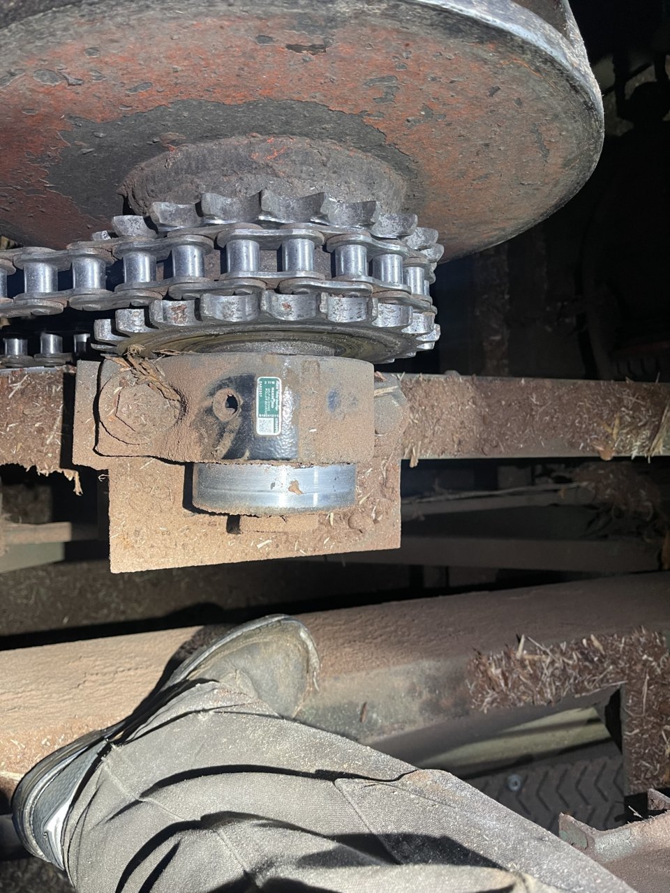

    This bearing has decided it's old enough to leave its house and strike out on its own... D72260CA-AD37-4F55-85E2-846BC3632EE3.jpg

    I know I’m stating the obvious buttttttt, that’s not how a chain goes bud..
    May I suggest sprocket’s

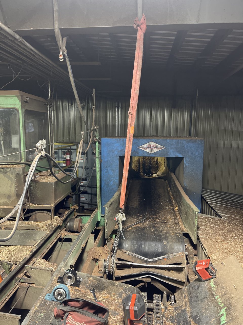

    Doing my level best :Dimage.jpg

    This is true. Although now I have all my methods of bearing removal up here minus the torch. Thankfully the classic 3 jaw worked out. Sadly this is what lay underneath. Looks like the person before me decided to just slap a pillow block bearing on this shaft after this damage was already done from a previous failed bearing. 2975C8C2-2ADB-499D-B5FA-3CFD409F4787.jpg

    Change the roller or another weld it up and turn it back down job?

    I wish I could say I was in a position to fix it properly with a new shaft and sprocket. Alas I'm in the same position of "just get it running" as I'm the only guy here, this is 20 feet off the ground outdoors, and shift starts again in 10 hours. New pillow block, grease, and new hardware to make it run until we can try to remember it needs to be fixed.

    Weld the journal and machine Finding a shaft or making one might prove interesting.
    Then with the cost of bar stock unless there is enough on the rack then it is just the labor time.
