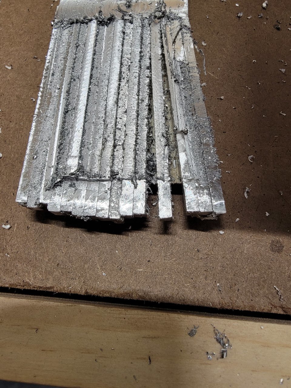

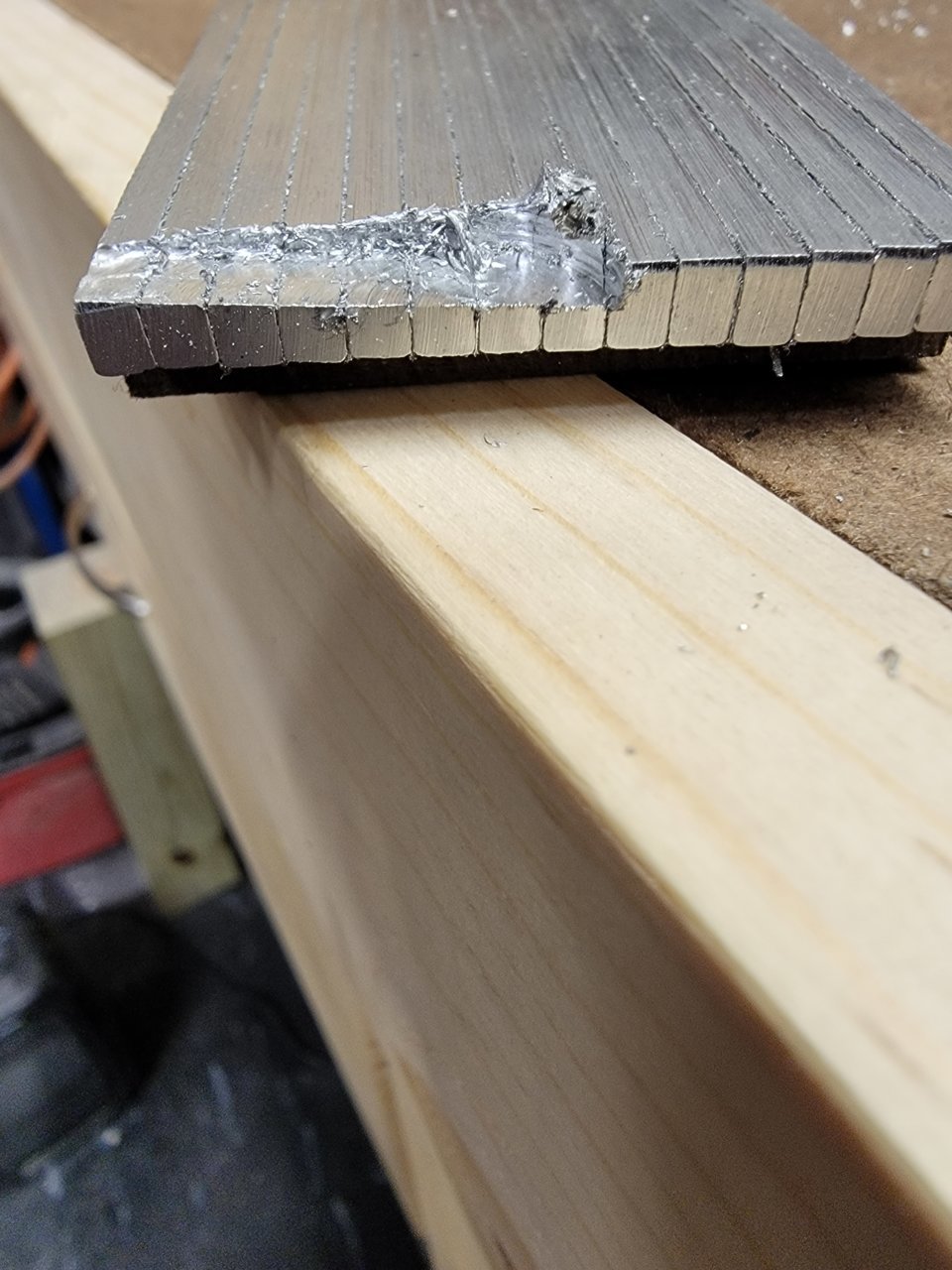

    I thought of a fly cutter when I seen the pictures earlier. So much though is in set up of your work piece. Always need parts as ridged as possible when setting up. Like the picture of that large piece of aluminum in the mill that didn't get finished. I would have clamped the area where I was milling in the vice or at a minimum have some jacks underneath it way out there. It's also convenient if you have 2 precision vise like Kurt, that you can use 2 if needed.
    On those small aluminum strip, if they weren't directly clamped in a vise near there, then clamp them together.
    Edit; like a C-clamp holding the pieces together, if you can get one on there below depth of cut of course.

    Yes.. I likely rushed the set up to see what I could do.. and definitely rushed the second set up after I got the second set ready to go.
    Definitely have to slow down. I like the two vise set up idea. The other ideas as well.
    Thank you all !

    Just partial with that cutter as well; if it's 1" end mill then take a smaller bite. WD-40 is your friend when cutting aluminum. Depth of cut too, start out slow, take a 1/16" depth of cut until you get a feel for it.
    You have X,Y, and Z axis, keep the axis direction you AREN'T feeding tight. Also look up climb milling vs conventional milling. No climb milling unless your on a machine that has ball screws, like CNC stuff
