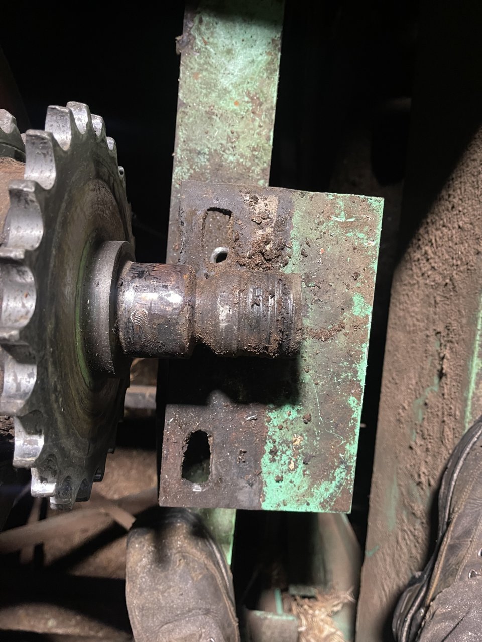

    We occasionally run into this. Best part is when you don't have a shaft, especially nowadays. We'll take thin metal shim stock and center the shaft in the bearing. If needed two decent welds 180° across from each other with an 1/8 7018 rod. Although at the time of day you were doing this and all the sawdust, that's not an option... Now if the shaft is really worn, then we have no option but weld the shaft up, but typically we keep something similar in stock and can cut down if need be...
