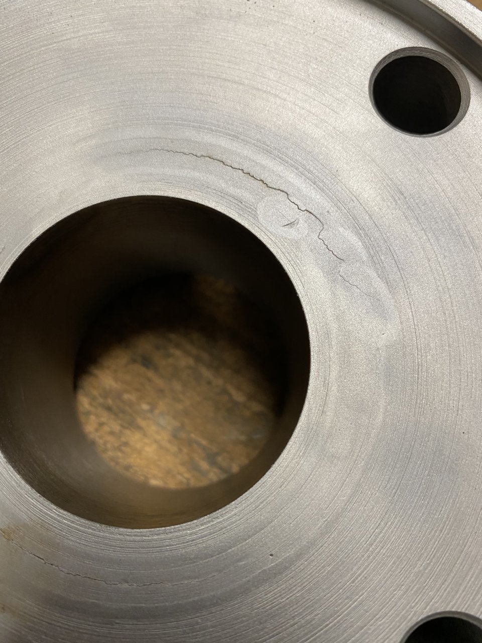

  1. Jan 11, 2022 at 12:51 PM
    tacotoe
    tacotoe Pastry Chef
    Nov 25, 2007
    #3593

    `17 AC Sport MT

    I have to go take some measurements on vendor supplied parts, bearing sleeve and bushing they're saying is not the correct clearance. When I get back I want to ask one of our welder guys what he thinks.

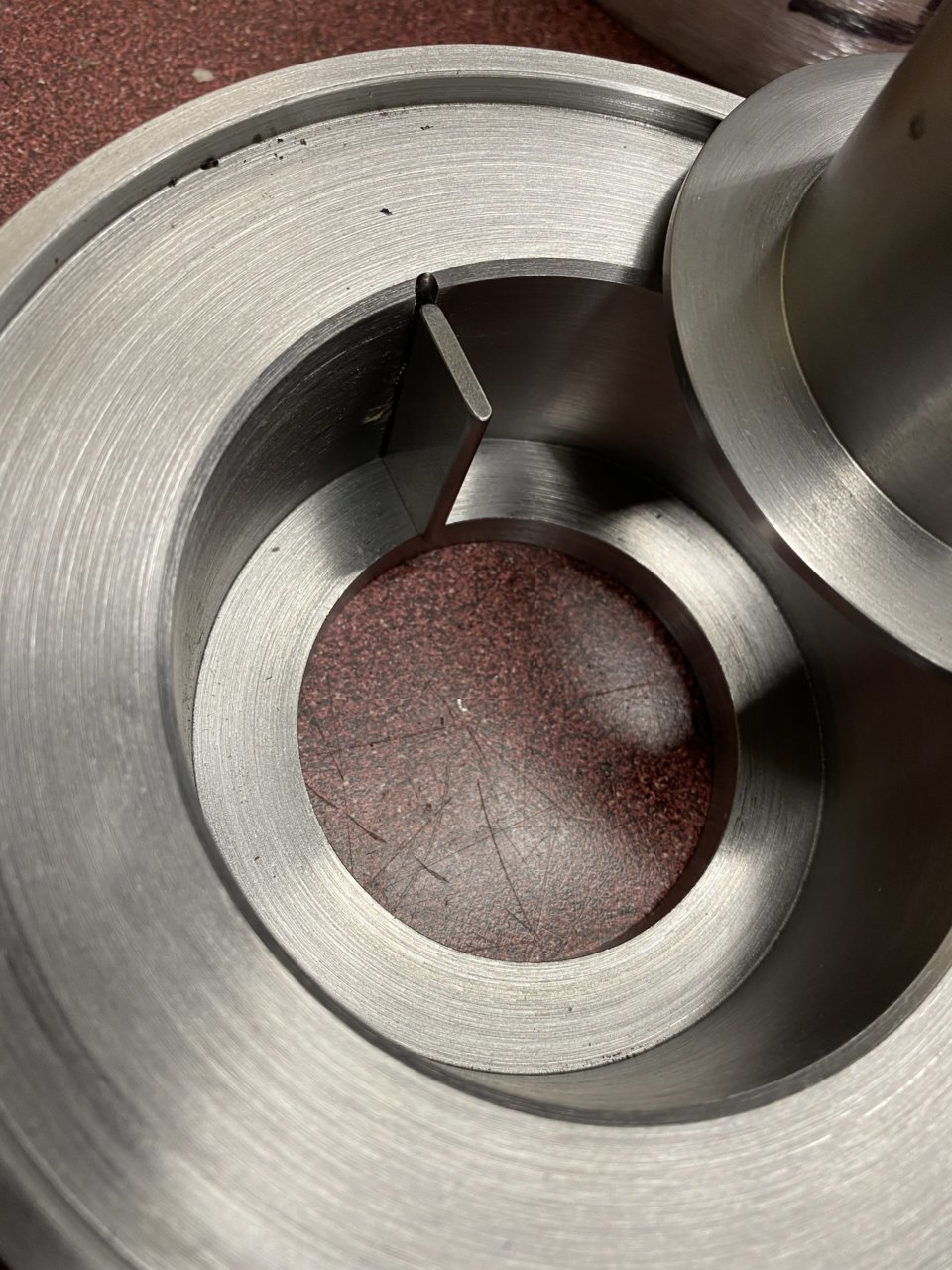

    It’s a cooling jacket, it’s hollow in the center with a small stop to make the coolant flow in and out. If that makes sense.

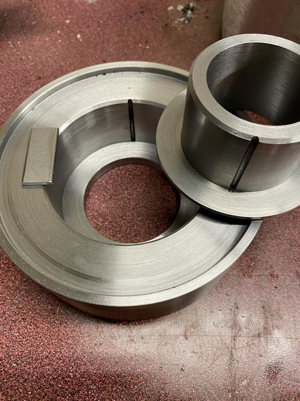

    8 lugs no plugs
    Here’s why they are 3 piece :thumbsup:

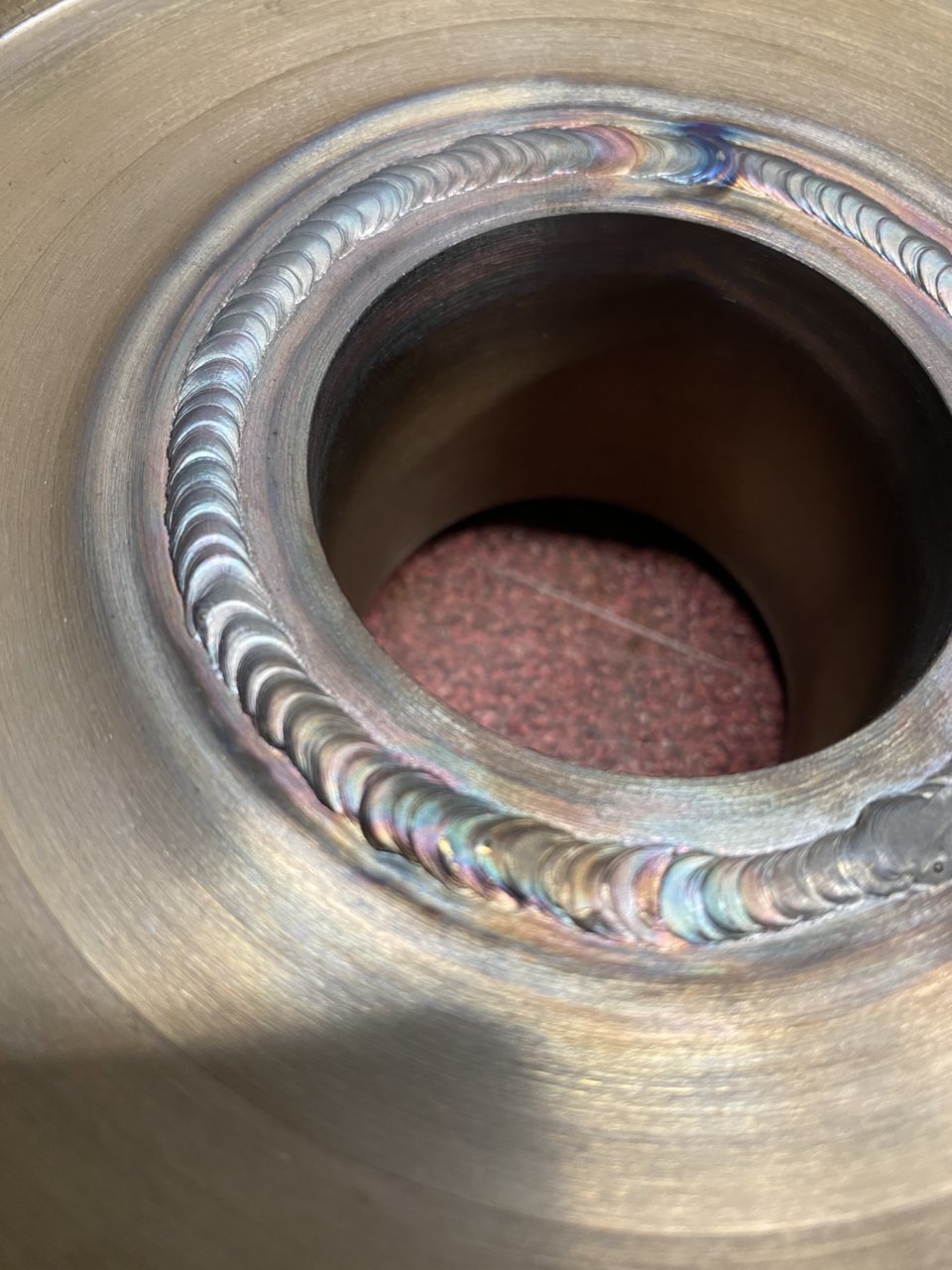

    Odd. You would have thought it would be xrayed
    Ah, so no root; just filler. I wonder if someone opened a garage door and blew the gas shield away while the welder was going over those spots?

    8 lugs no plugs
    They looked great when they came back from welding. No holes or anything.

    '13 Barc. Red Tacoma SR5 4X4
    No use trying dye then.

    8 lugs no plugs
    Don’t know that it would have shown anything. They looked good, even after we turned the weld smooth on the lathe and aired em up with 120 psi.

    ARE Topper, Icon aal, OEM Audio+
    Welder dude says preheat has much to do with it and more of a chamfer for filler wouldn't hurt either.
    :notsure:
    I told him I think the weld shop did preheat them.

    22,105
    I wonder if turning them added in stress that only showed up after it went to get chromed?
