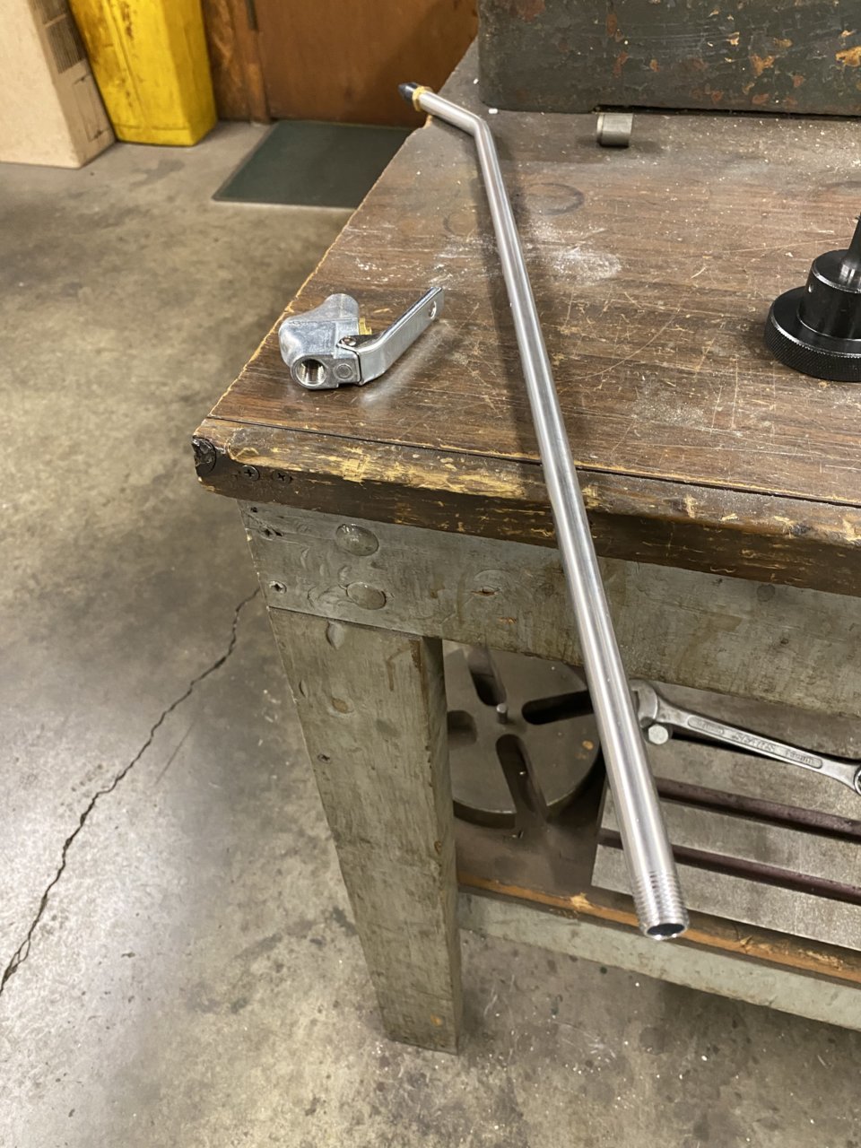

    Customer brought two of these by and wants 8” cut off and rethreaded. They are 1/2-18 thread. Had to order a die.

    My Name is Rahl
    Jul 5, 2018
    #258370
    22,105
    Cut it off then solder the tubing back on? :notsure:
  15. Jan 21, 2022 at 10:38 AM
    six5crèéd
    six5crèéd [OP] Be the light
    Jul 9, 2019
    #298734
    36,231
    Southern Virginia
    8 lugs no plugs
    It's aluminum :D
    If the lathe guy was here he could single point it.
    If we had a manual lathe I could single point it, I don't know how to use the thread cycle on the cnc lathe.
  16. Jan 21, 2022 at 10:44 AM
    My Name is Rahl
    Jul 5, 2018
    #258370
    22,105
    I thought you could solder aluminum? Have I been lied to? Or is "soldering" aluminum called brazing?
  17. Jan 21, 2022 at 10:47 AM
    tirediron
    tirediron Well-Known Member
    Jan 19, 2019
    #279864
    3,891
    John
    Victoria, BC< Canada
    2022 4x4 Sport, Auto, BCM
    That's one that doesn't come up too often.
  18. Jan 21, 2022 at 10:51 AM
    tirediron
    Jan 19, 2019
    #279864
    3,891
    John
    It's called 'welding'. Soldering normally refers to the use lead/tin alloy which is melted and forms a bond between either copper/brass/tin. Brazing is essentially soldering with brass vice lead/tin. Neither soldering nor brazing involve melting the parent materials, welding on the other hand means that the two parent materials are melted and flow together, usually with a filler material. AFAIK, there's no way solder/braze, or anything else aluminum, except to weld.
  19. Jan 21, 2022 at 11:00 AM
    tacotoe
    tacotoe Pastry Chef
    Nov 25, 2007
    #3593
    5,915
    Nebraska
    `17 AC Sport MT
    ARE Topper, Icon aal, OEM Audio+
    Not 1/2-14 NPT ??
    Or 1/4-18 NPT ??
  20. Jan 21, 2022 at 11:02 AM
    six5crèéd
    Jul 9, 2019
    #298734
    36,231
    Southern Virginia
    8 lugs no plugs
    No sir, pipe is spot on .500" My first thought it was 1/4-18 NPS cause its not tapered, 1/4" pipe is .540" od though. (had to look that up)
