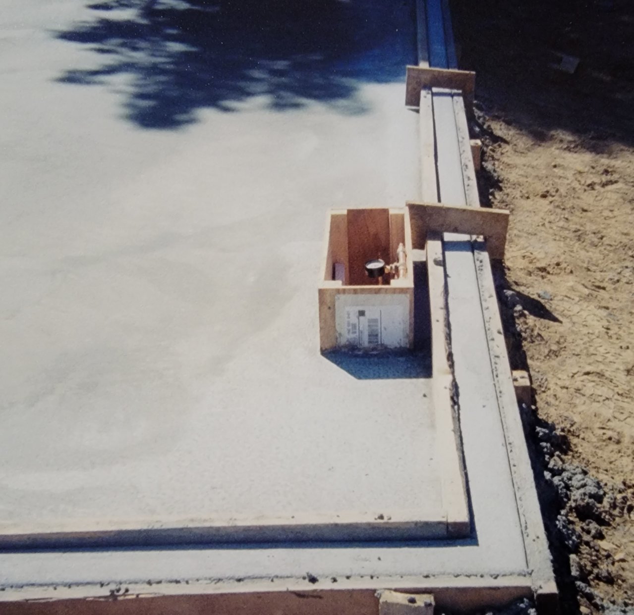

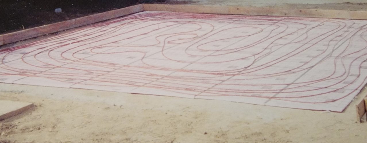

    I dug out some old pictures and took pictures of my pictures haha.
    My layout. Instead of doing 3 different zones I ran redundant zones.

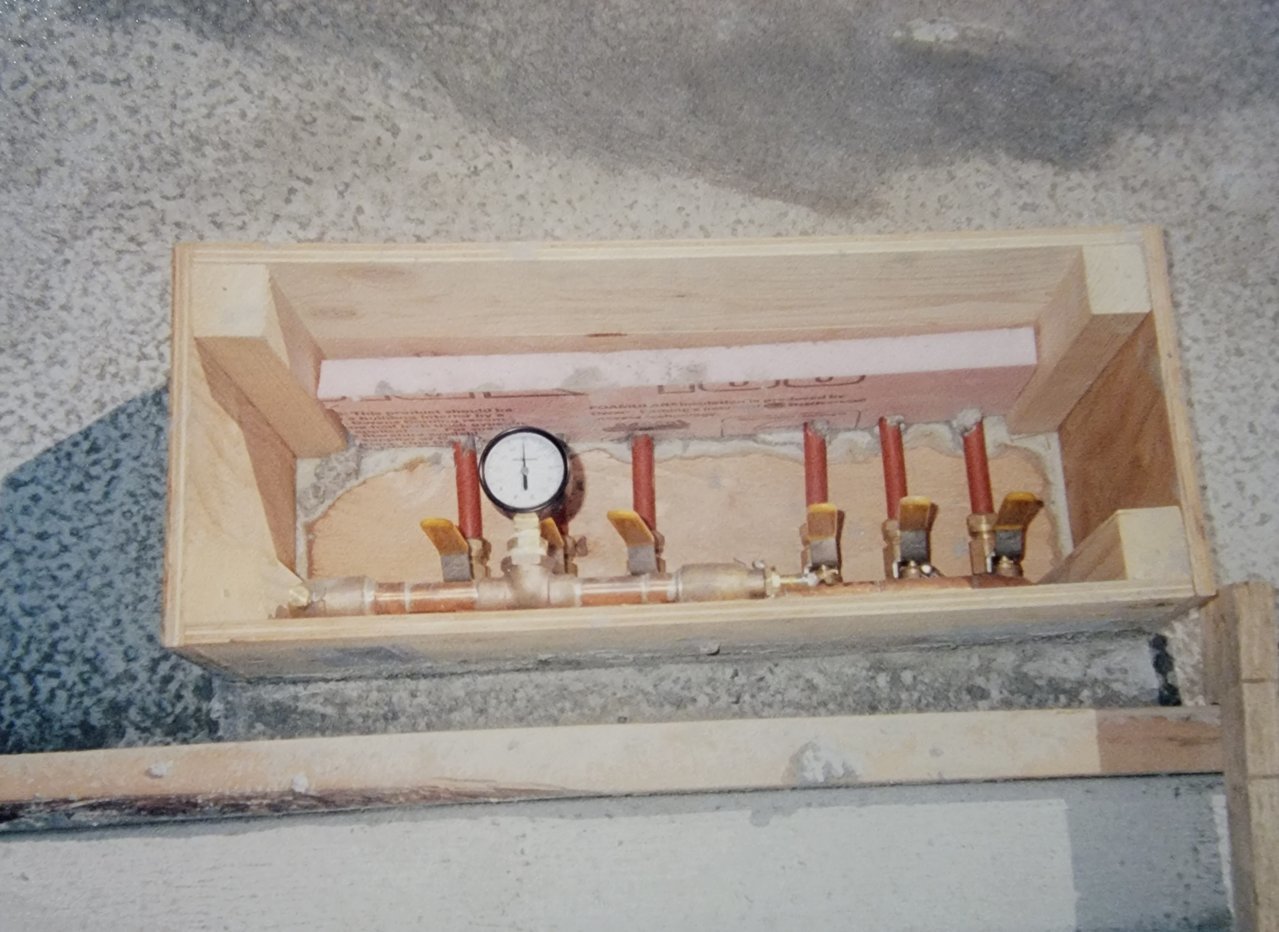

    The pex lines come into a box that was sunk in the concrete. The lines were pressurized when the concrete was poured to protect them. The box comes apart from the inside so when I get around to setting this up, it will all be copper and no chance of cutting a line.
    A side view of the box set in the concrete.
