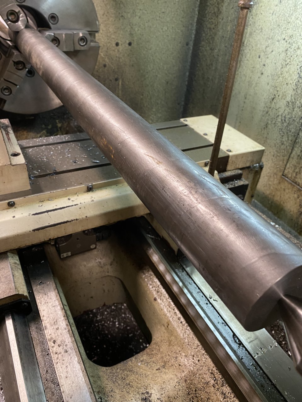

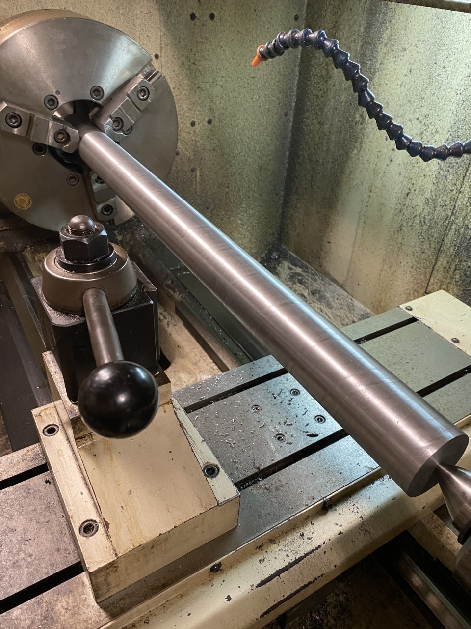

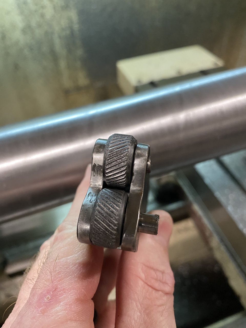

    I watched that video, we don’t have a knurl tool like his. Any suggestions for me tomorrow when I knurl this? I did polish it with some sandpaper.
    I know to get it centered, probably run coolant.
  10. Jan 24, 2022 at 11:35 AM

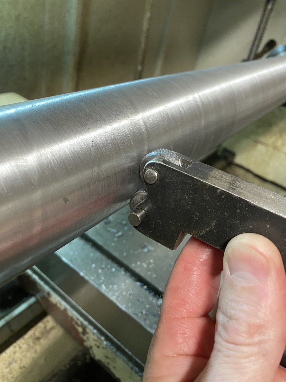

    Knurling is hit and miss for me too. I usually run a practice piece first. Make note of feed rate and depth. That's a long piece, consider a follower rest.
    I use oil in a squirter can and keep air chuck near to keep tool somewhat cleaned out.
    I've also been shown to angle tool ever so slightly at leading edge. Bottom line; practice runs with same diameter material.

    Don't know that there's a huge need for coolant, but definitely make sure you run a follow-rest. That knurling tool looks a little small for that stock IMO.

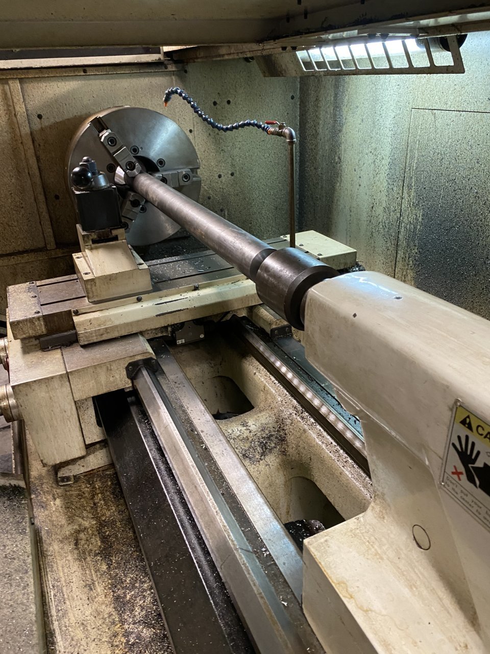

    We don’t have a follow rest with this lathe. That material is 2 1/2” OD X 36” long, I need a 30” piece out of it so I’ve got 6” to play with. That’s also the only knurl tool we have.

    That example piece wasn't a real aggressive knurl anyway. IDK, without a follower rest may get by with just a couple thousands extra towards the middle :confused:
    Just make sure not to push it out of the live center..
    :bananadead:
    I have faith you'll do a fine job.

    I'd wire brush that garbage out of the knurl tool too before starting. Not that it would make a difference but just the way I am:anonymous:

    I will brush them out for sure.
