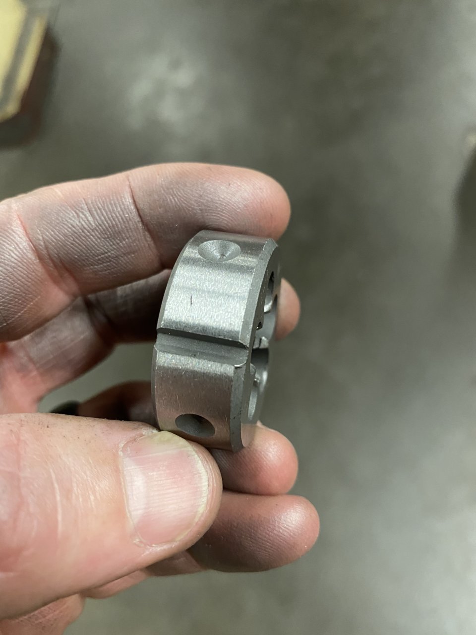

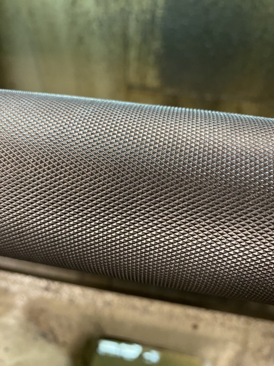

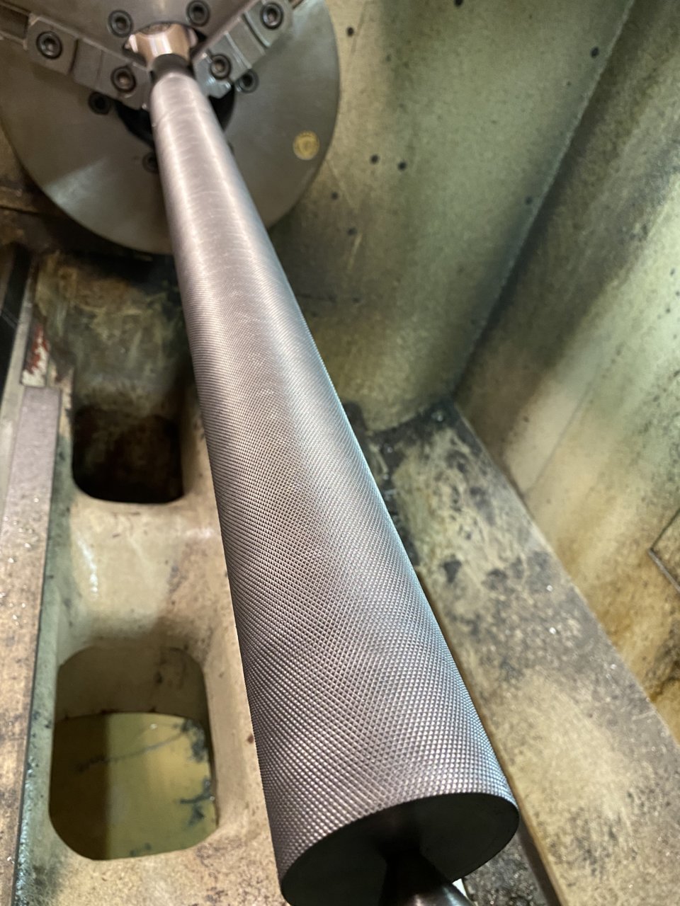

    Thats a lot of knurl...whats it for?
  2. Jan 25, 2022 at 7:09 AM
    six5crèéd
    six5crèéd [OP] Be the light
    Jul 9, 2019
    #298734
    35,999
    Southern Virginia
    8 lugs no plugs
    It goes on a machine that does something with fabric, when it gets back from paint I'll put a photo on here. The only part of this knurl that gets used is a small portion on the bottom that pinches the fabric.

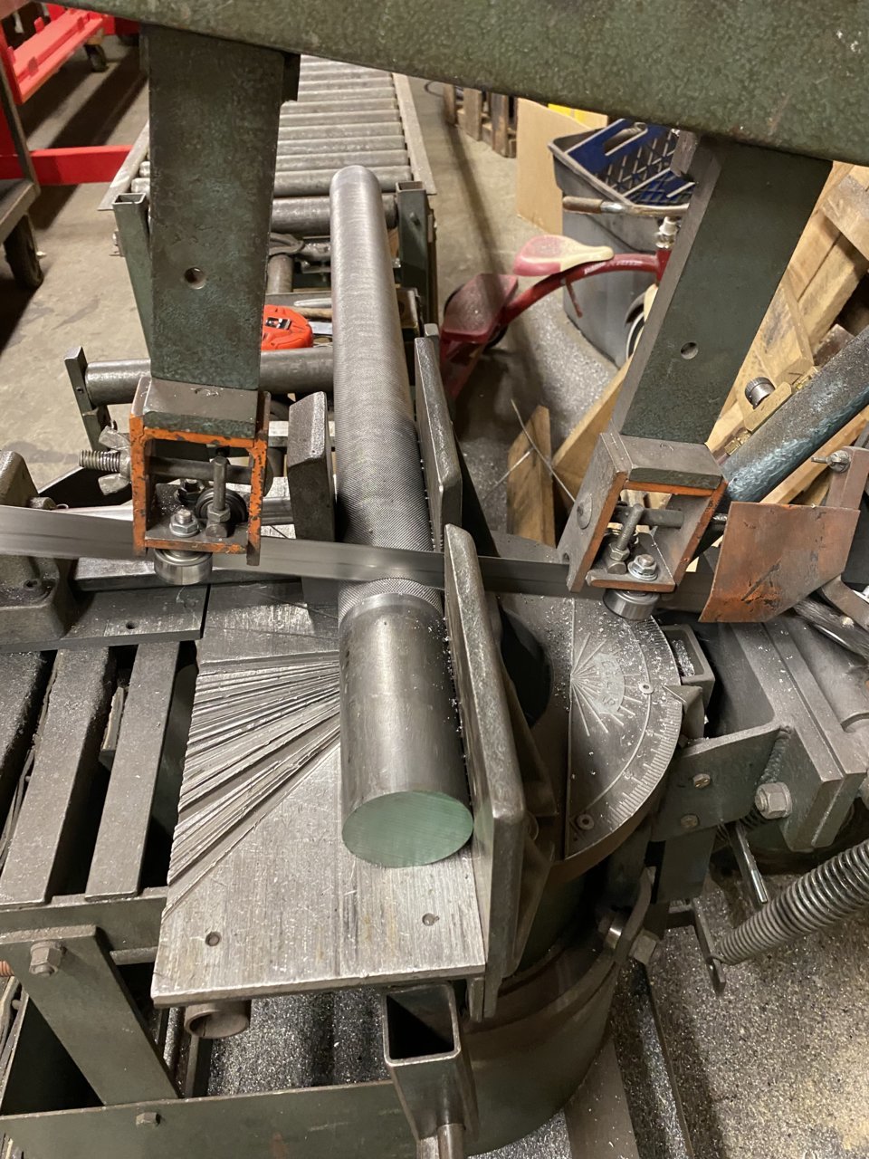

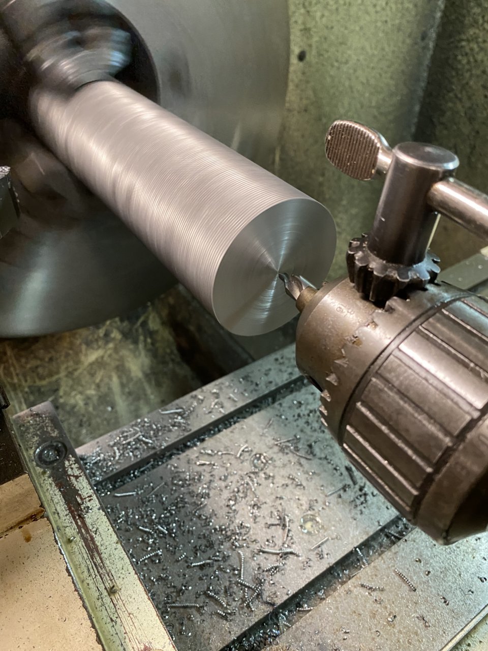

    Sawed, faced to length and center drilled. Didn’t need a center drill in this end but my ocd won’t let me have one in one end and not the other. Now to the mill.

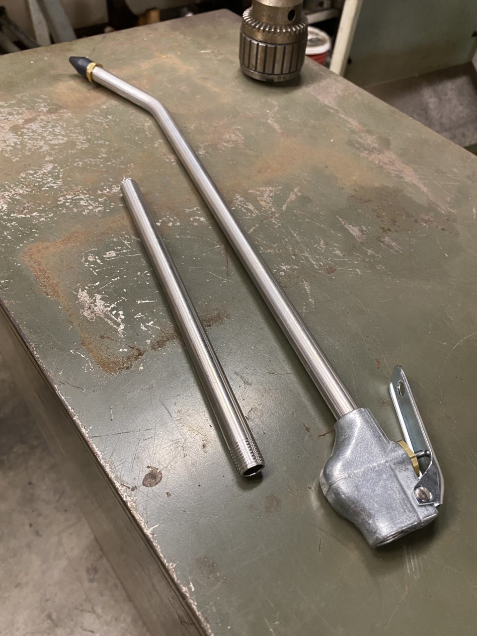

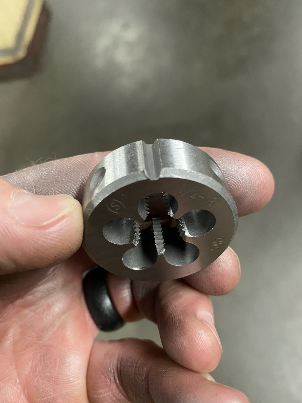

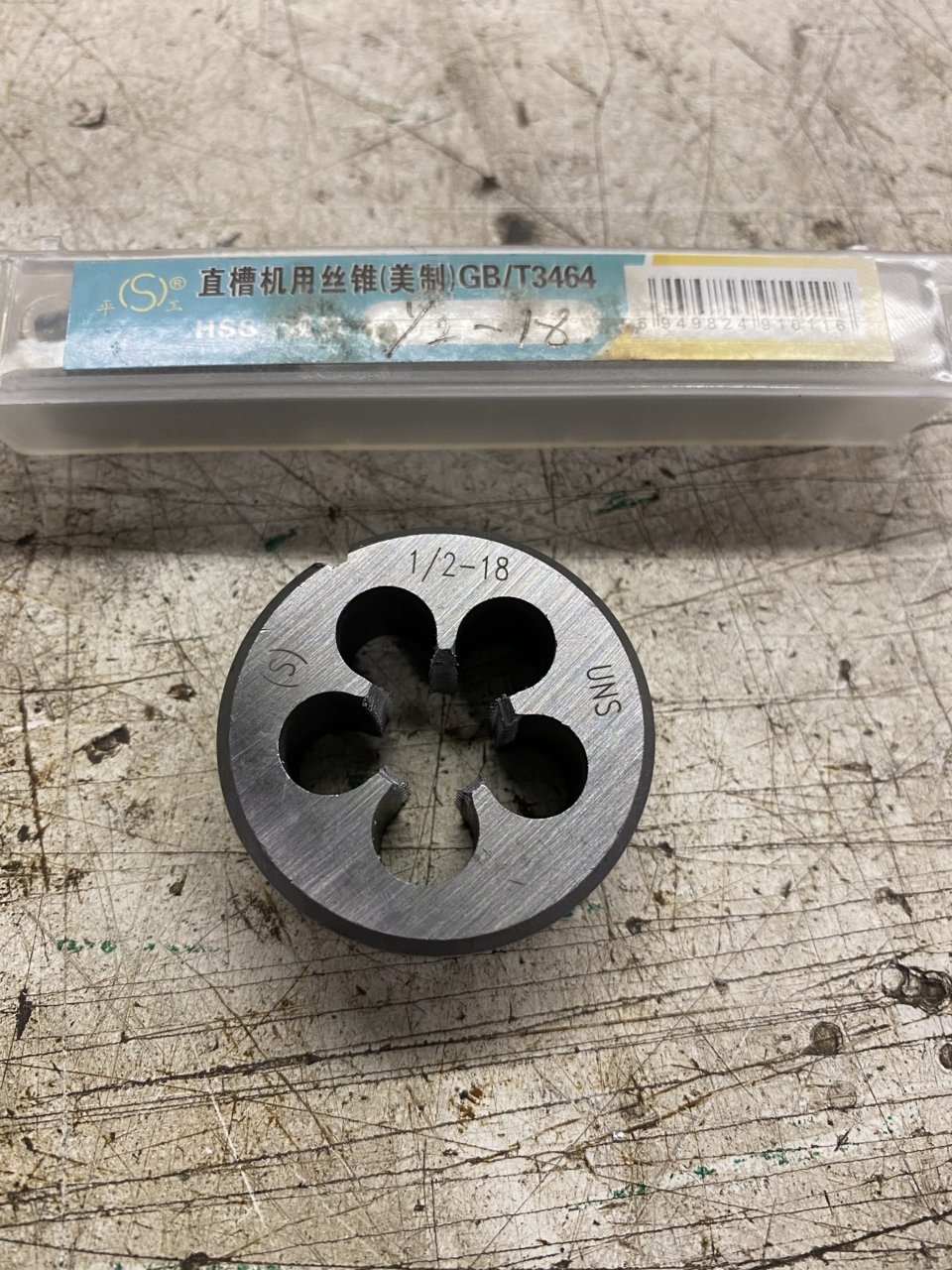

    While the lathe is on I figured I’d knock this air nozzle out with the 1/2-18 die. Never seen a 1/2” die that wasn’t split and an adjusting screw in it. I guess this one slipped through QC. Had to shorten it 8 1/2”.
