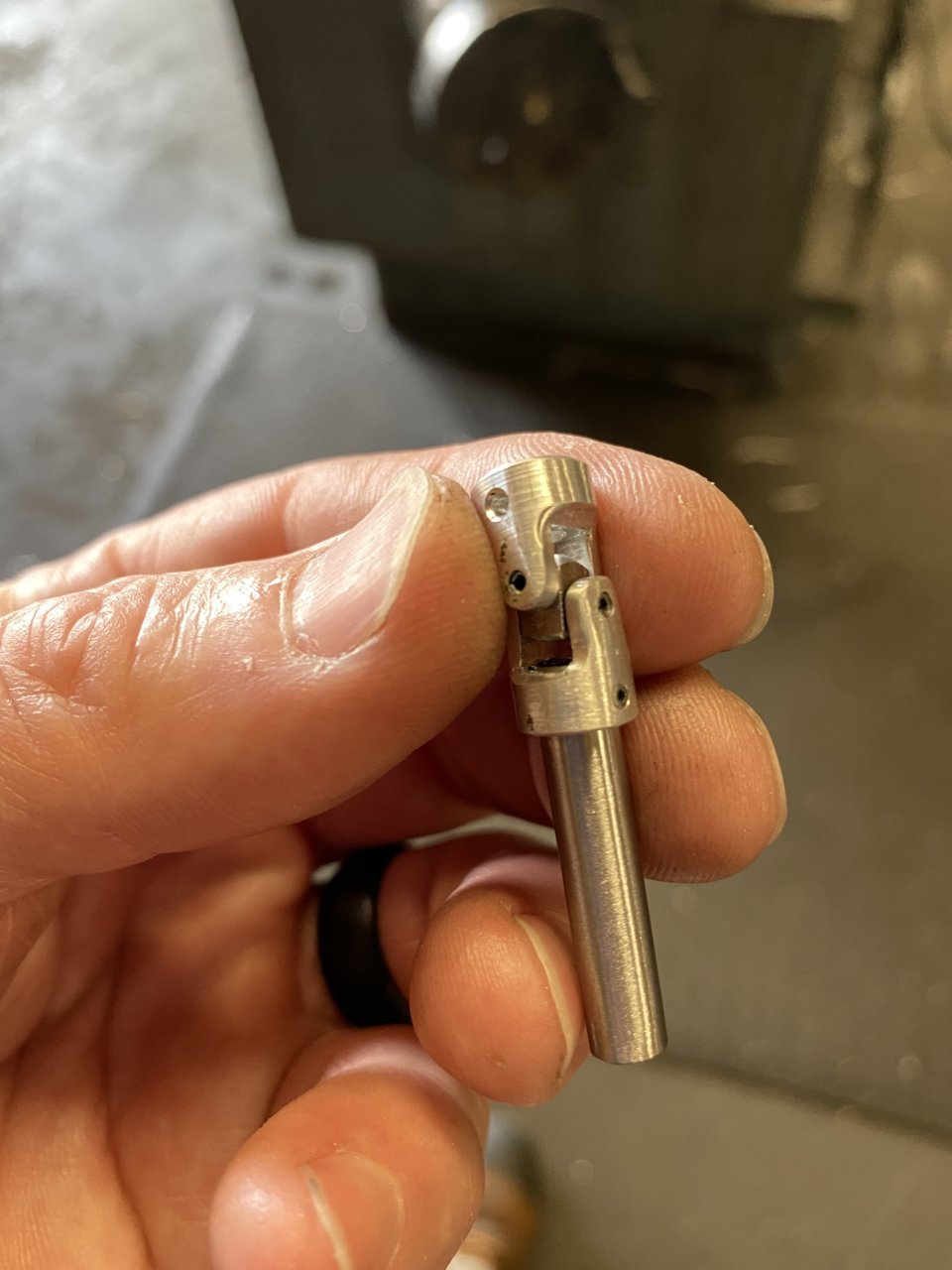

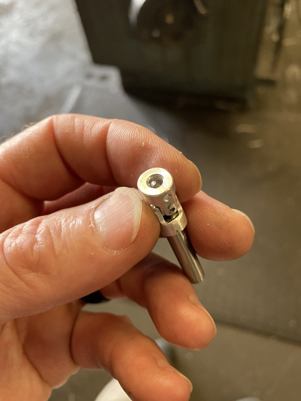

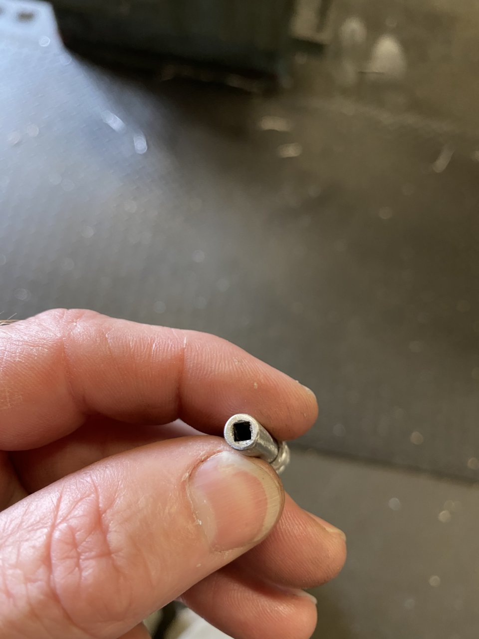

    First half of the PTO shaft is done. Square file in a round hole makes it ready for a 1/8” square for the other half.

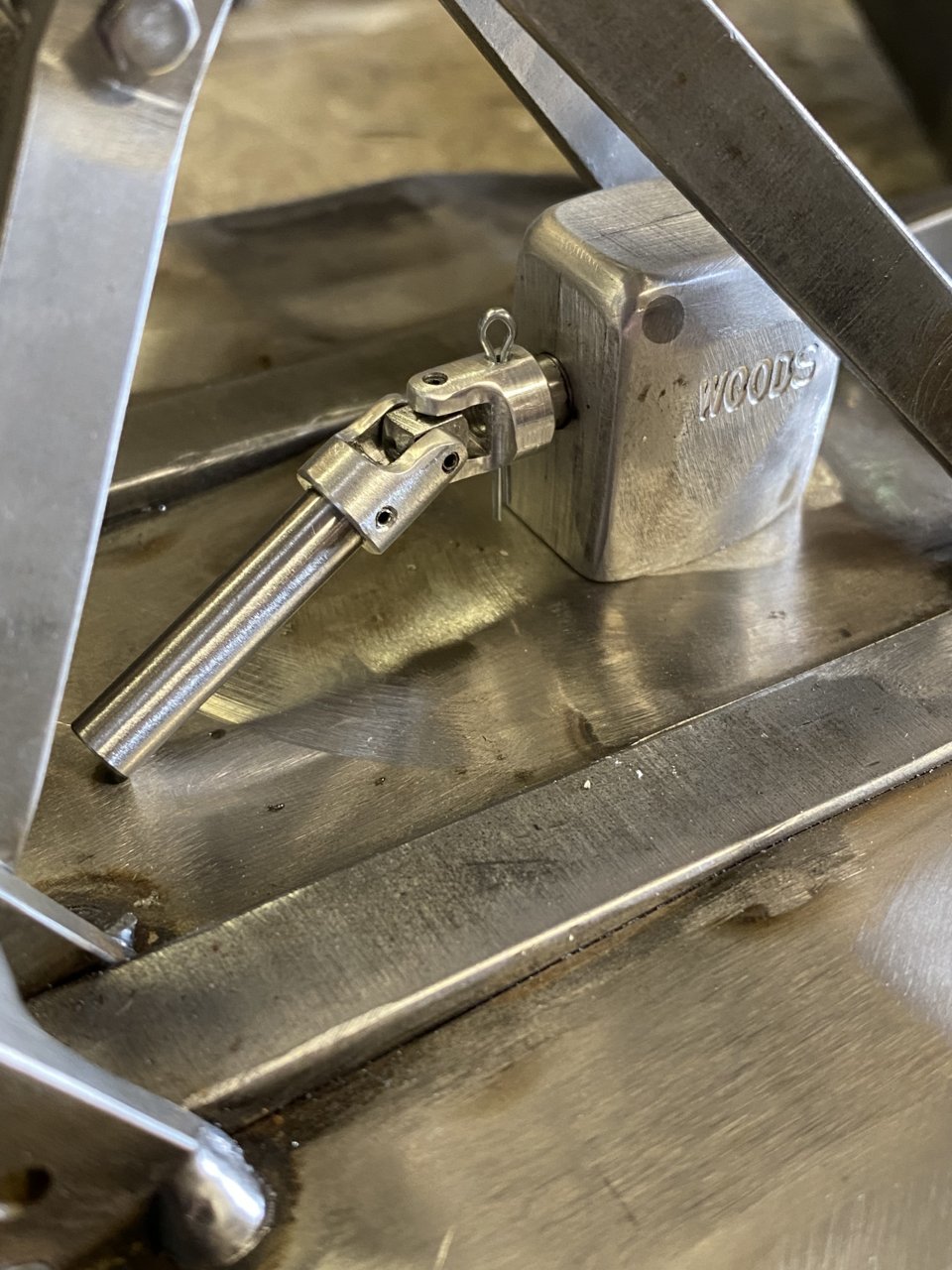

    I respect the fuck out of you but couldn’t you have used a 1/4” drive flex?
    Looks about the same size..

    Then it wont be hand made:notsure:
    looks more like 1/8" size to me

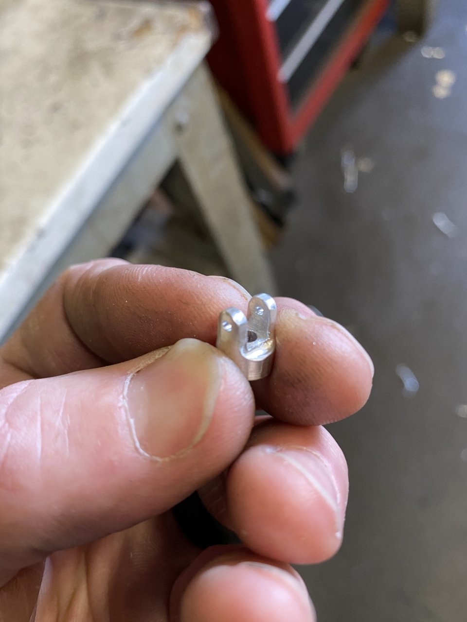

    I could have bought some universals and also found a shaft with universals already on it but I wanted to see if I could do it. The shaft is 1/8" square. The universals I turned to .350" O.D.
