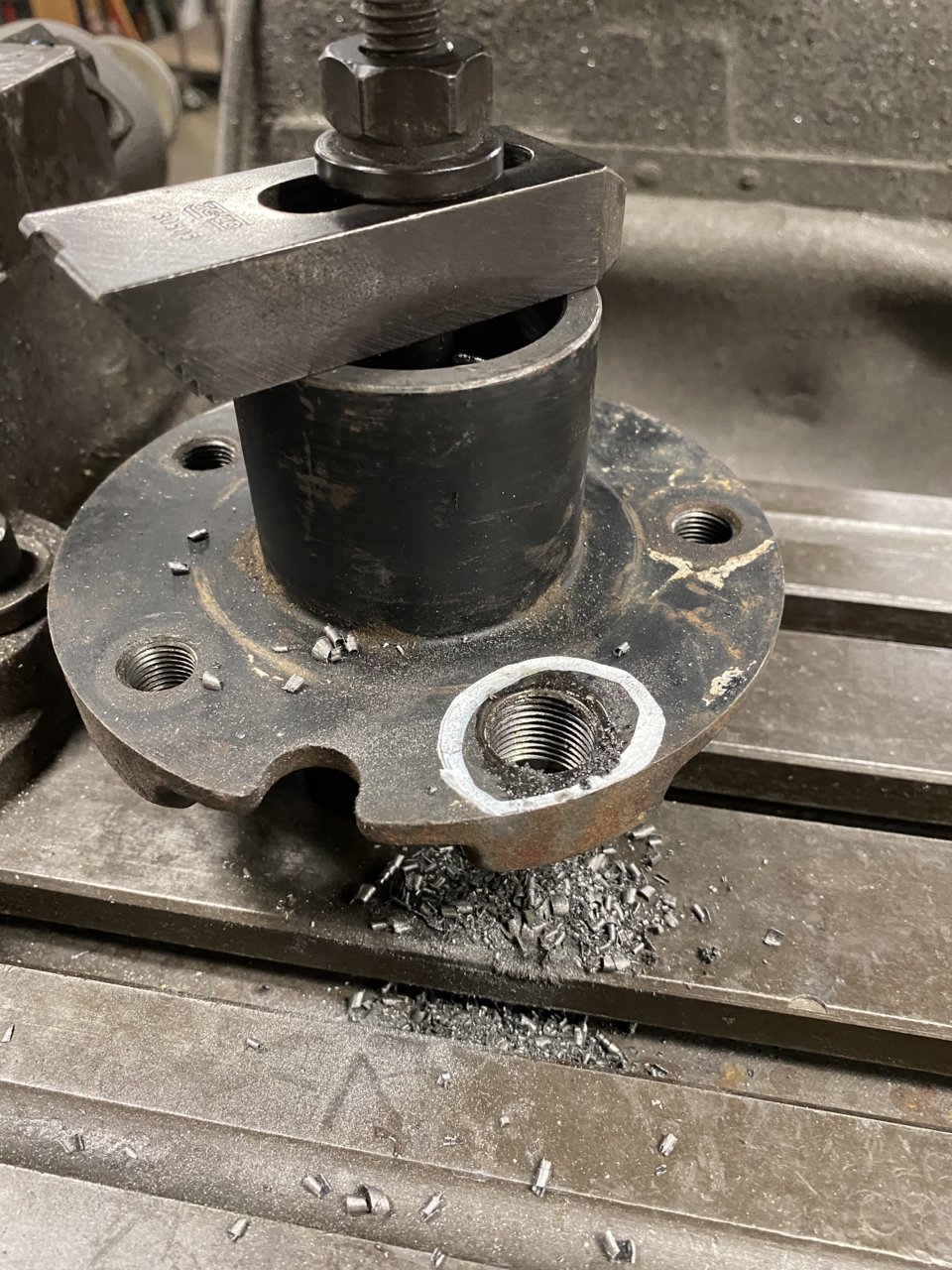

    Is the stainless work hardening?

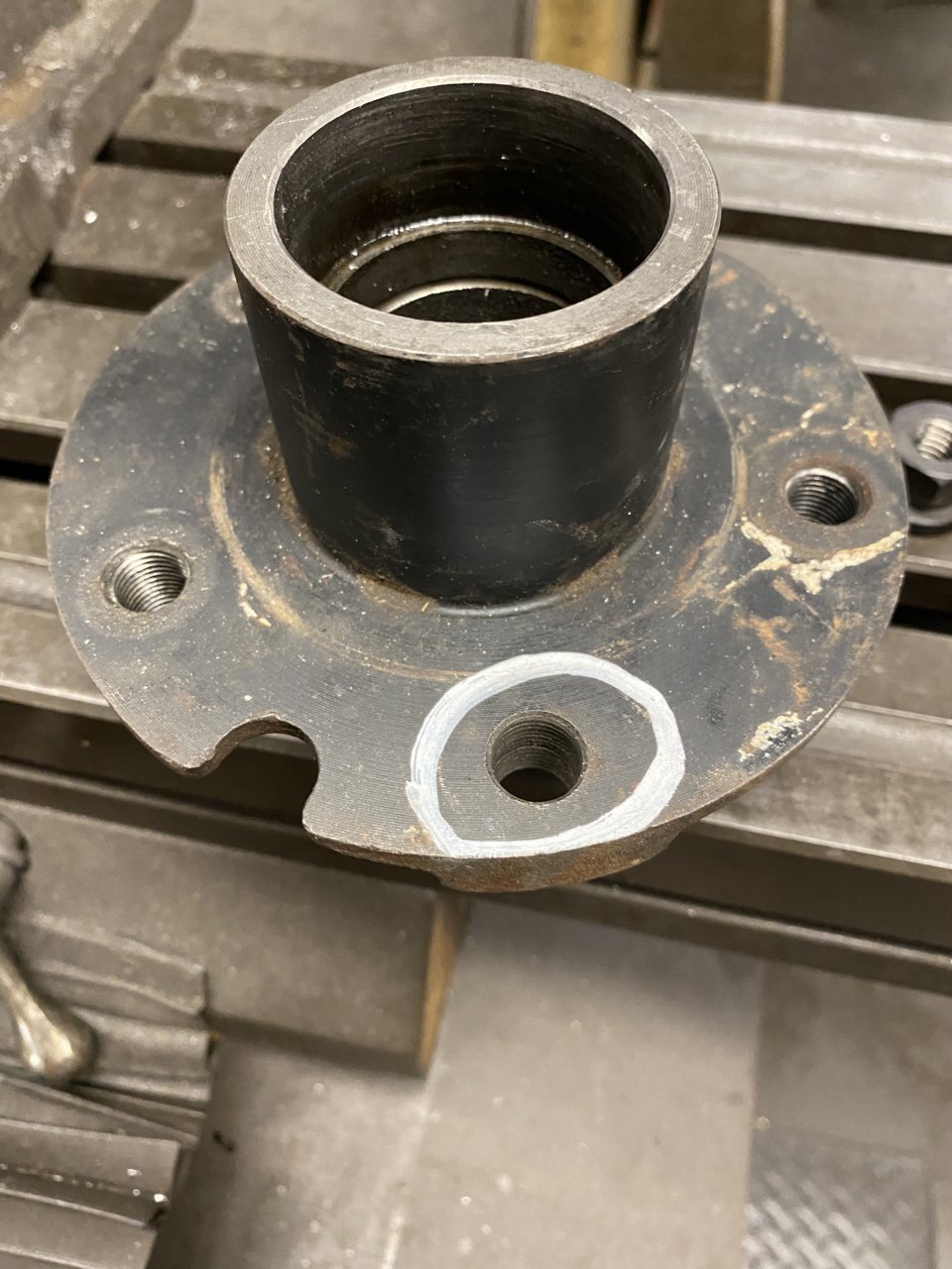

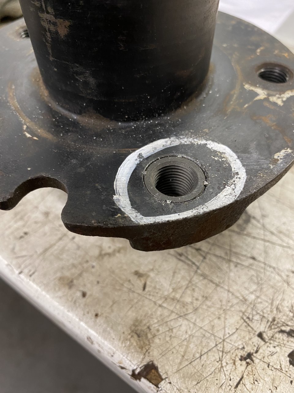

    Just tiny end mill, and stainless. I don’t like stainless.

    Substitute 4041? Maybe they won't notice?

    Could you do the bulk of the cut with a slitting saw and just use the end mill to tweak the start and finish of the slot?

    It’s not bad, I’ve done 20 slots already, only got a few more. Just got to feed it slow.

    REALLY slow; what's your depth of cut?

    I’m taking it all, whatever the wall thickness is. Probably around .125”-150”

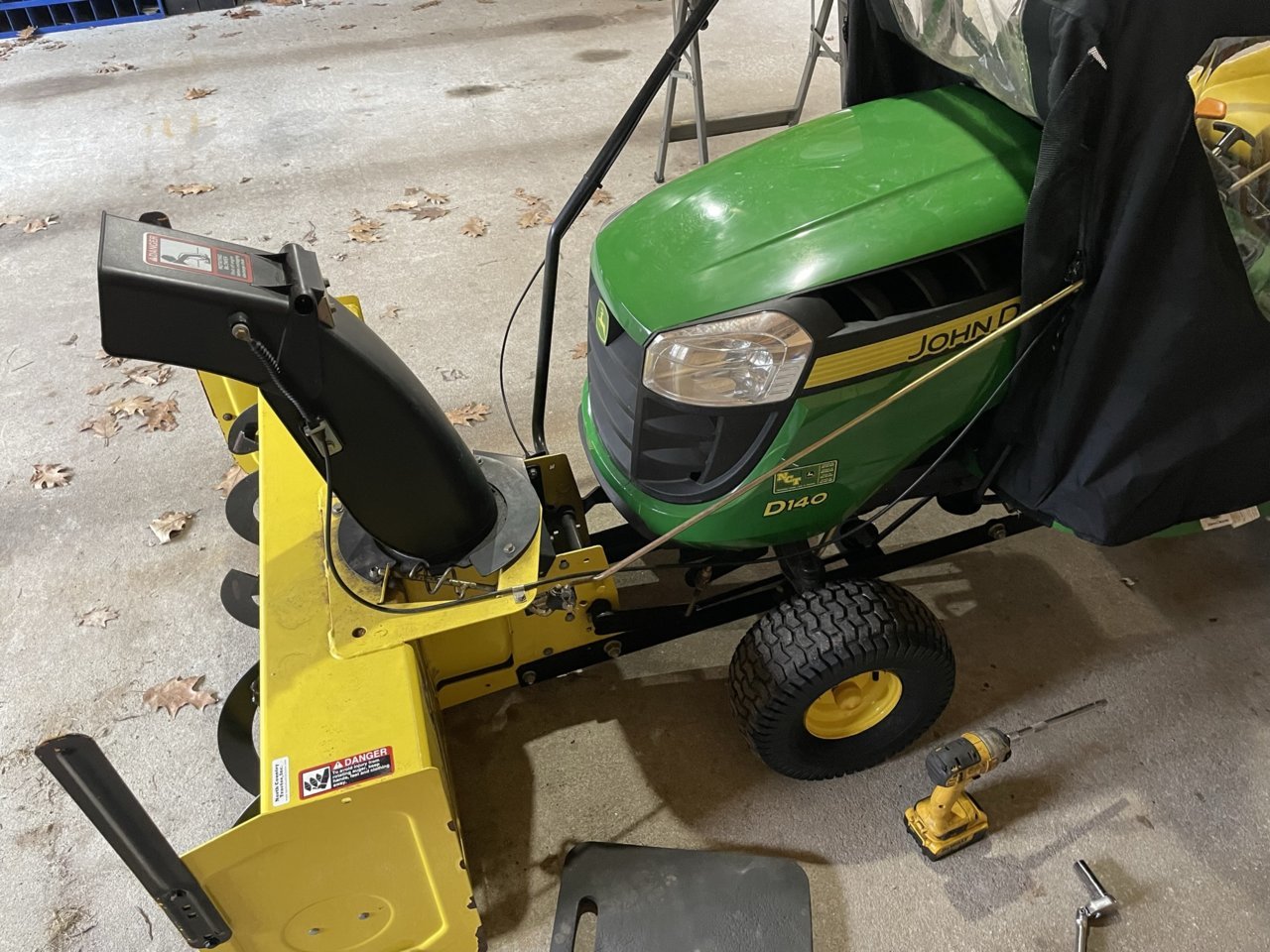

    31,495
    Southern Maine

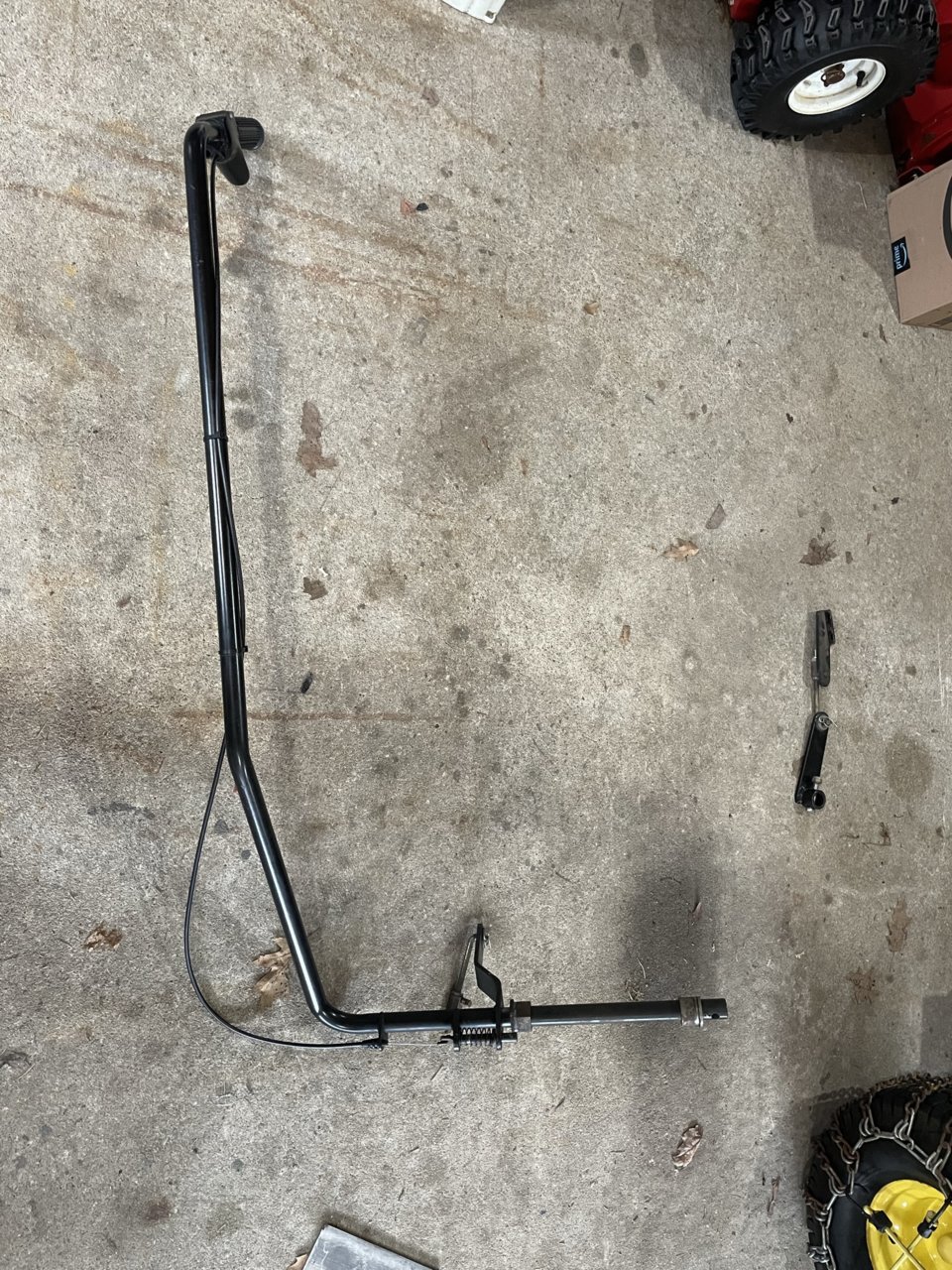

    Time to modify and design.
    Removal on parts I hope never go back on.
    Time to make some brackets.
    Measuring vertical height and spacing
    Cut, align, center, and double check side to side guides.
    Weld

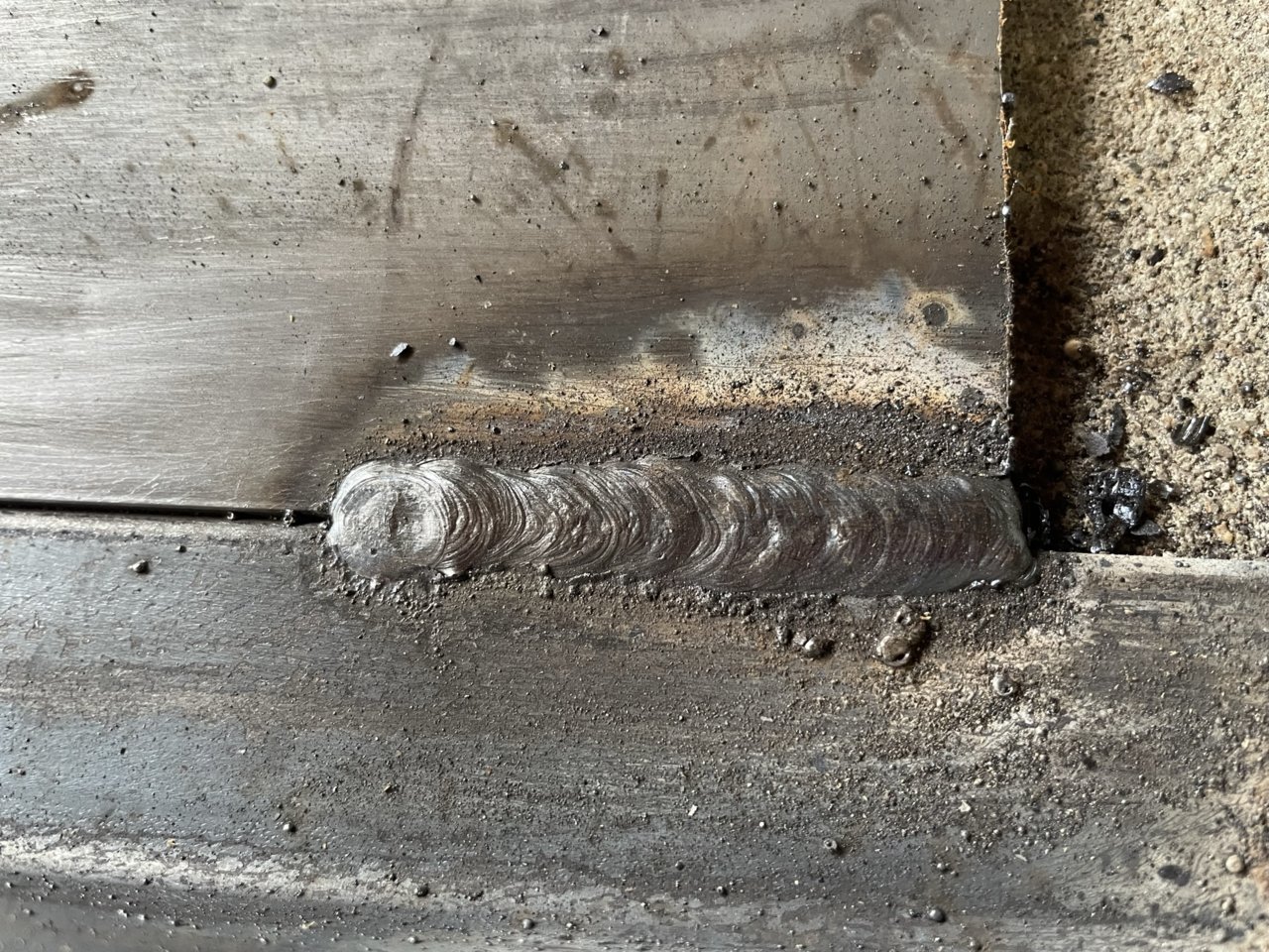

    Who in the fuck needs new equipment when you can use a welding machine that’s 40 something years old and 6011 rod 30 years old and haven’t used it in 10 years and throw beads down like this.
    I rewired the box last year so long leads to the winch
    it works good. Now to disassemble and grind and clean and paint..
