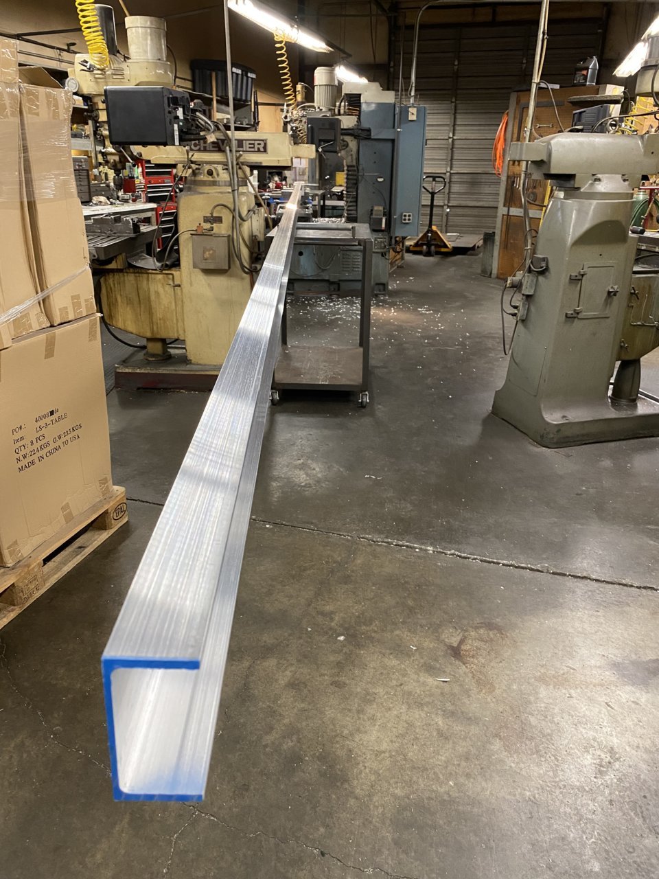

    Been working on this job for a month, this is the one I’ve been looking for. Last piece :goingcrazy:

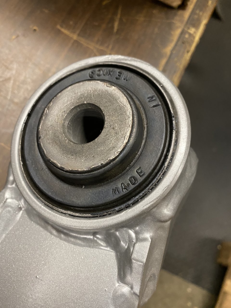

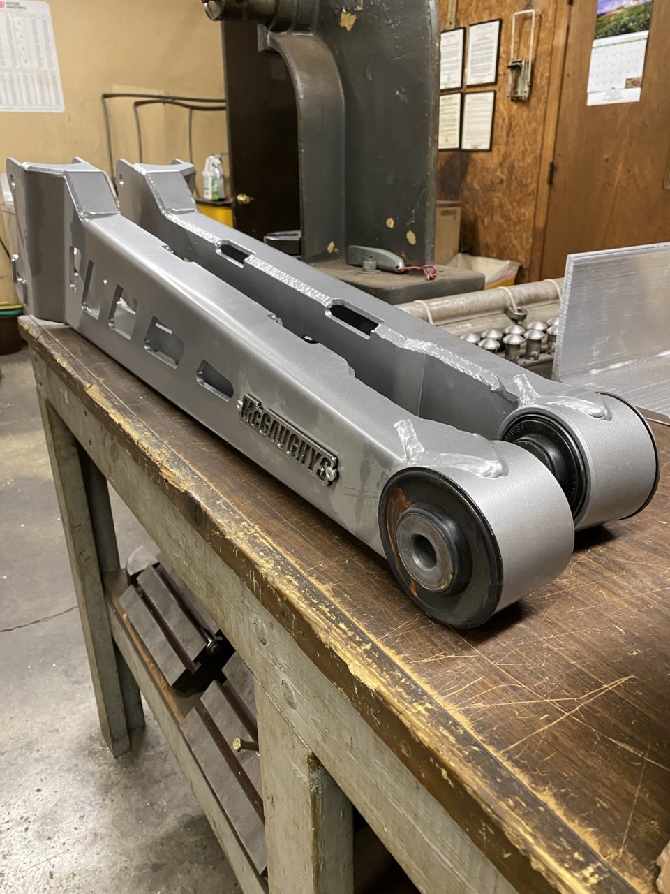

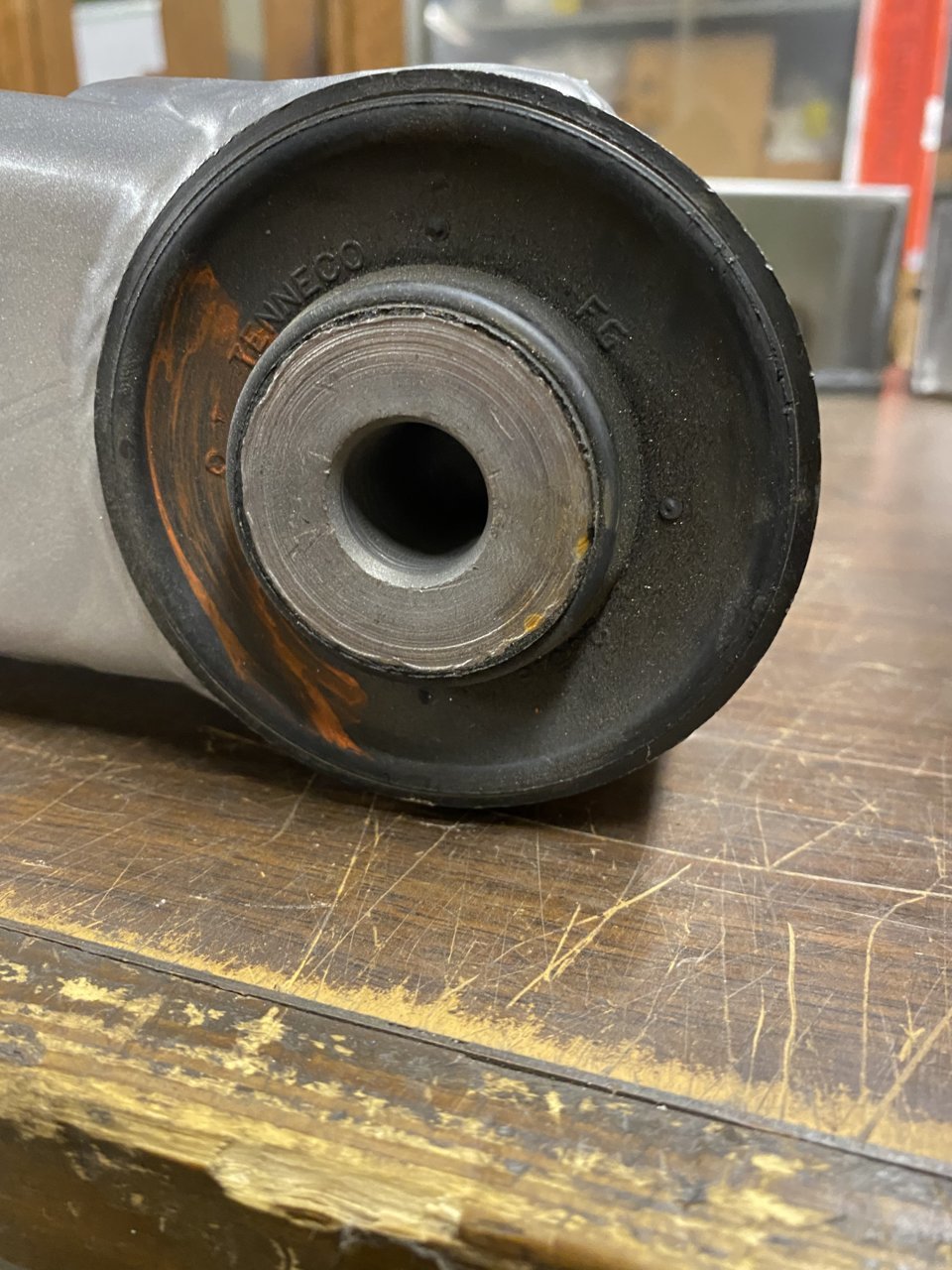

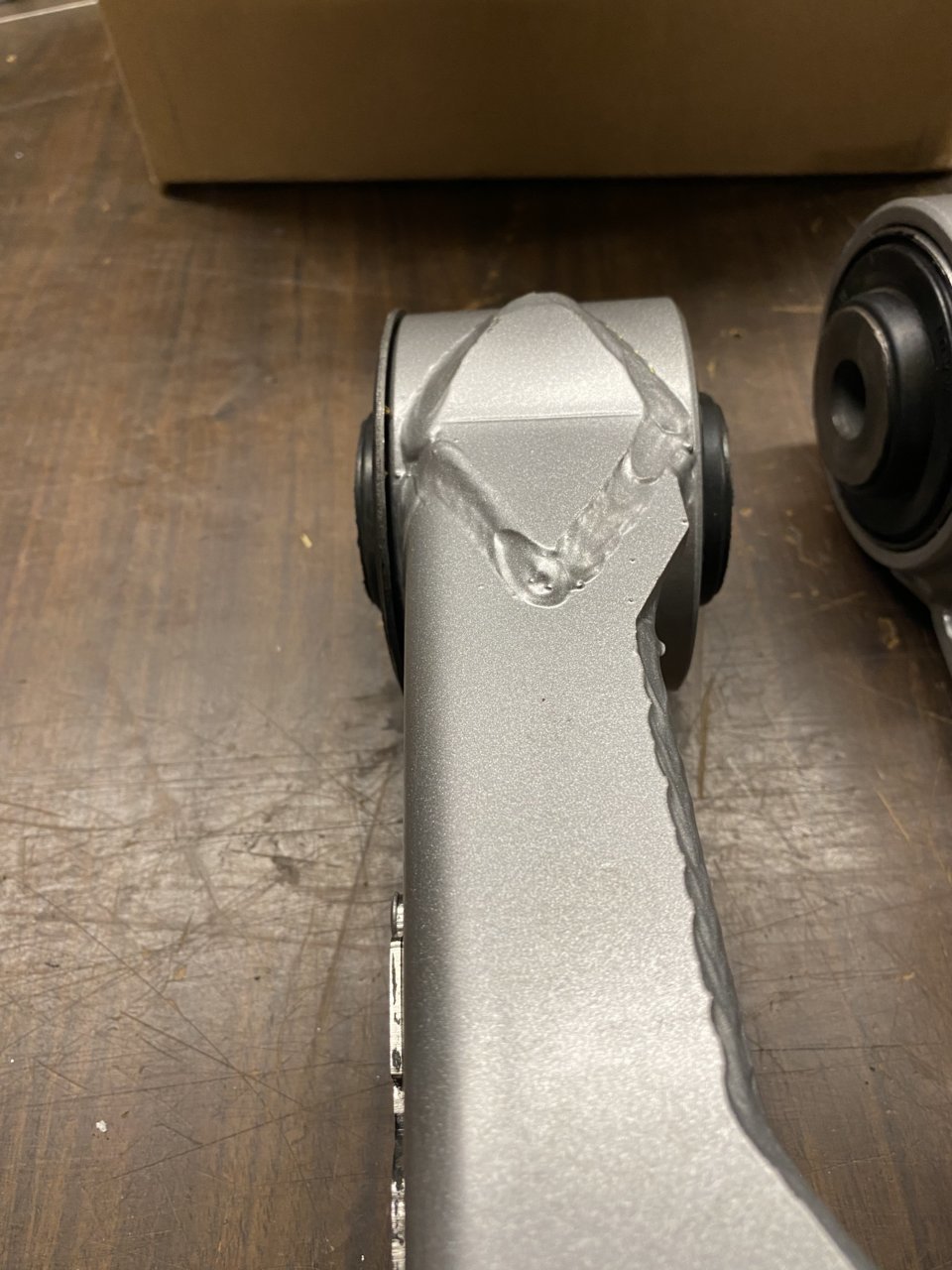

    Guy brought these in Thursday at 2:45, wanted the bushing pressed out so he can sandblast them and paint them. They are on an angle and there’s a flange on them. Told my boss how I would do it and left for the beach. He said we’ll see if we can get them out. They didn’t touch them, guy wanted to install them today :eek:

    Mmm that’s a lot of undercut.

    Negative. There is no way to hold it cause the bushing part is welded on at an angle and the bushing flange is the same as the O.D. of the piece it's pressed into. I told them I would weld two legs on it, press the bushing out and cut the legs off. Guess that's what I'll have to do. They are brand new parts for a lift kit, customer wants to change the color.

    Hope you don’t fry them bushings.
    He must be powder coating..
    No way is it worth to do that for paint..

    He is powdercoating them, this is another coater than the guy across the street. He said he thought about burning them out since they are in such a rush :D

    Doing that will keep the visual. Air hammers are your friend lol
