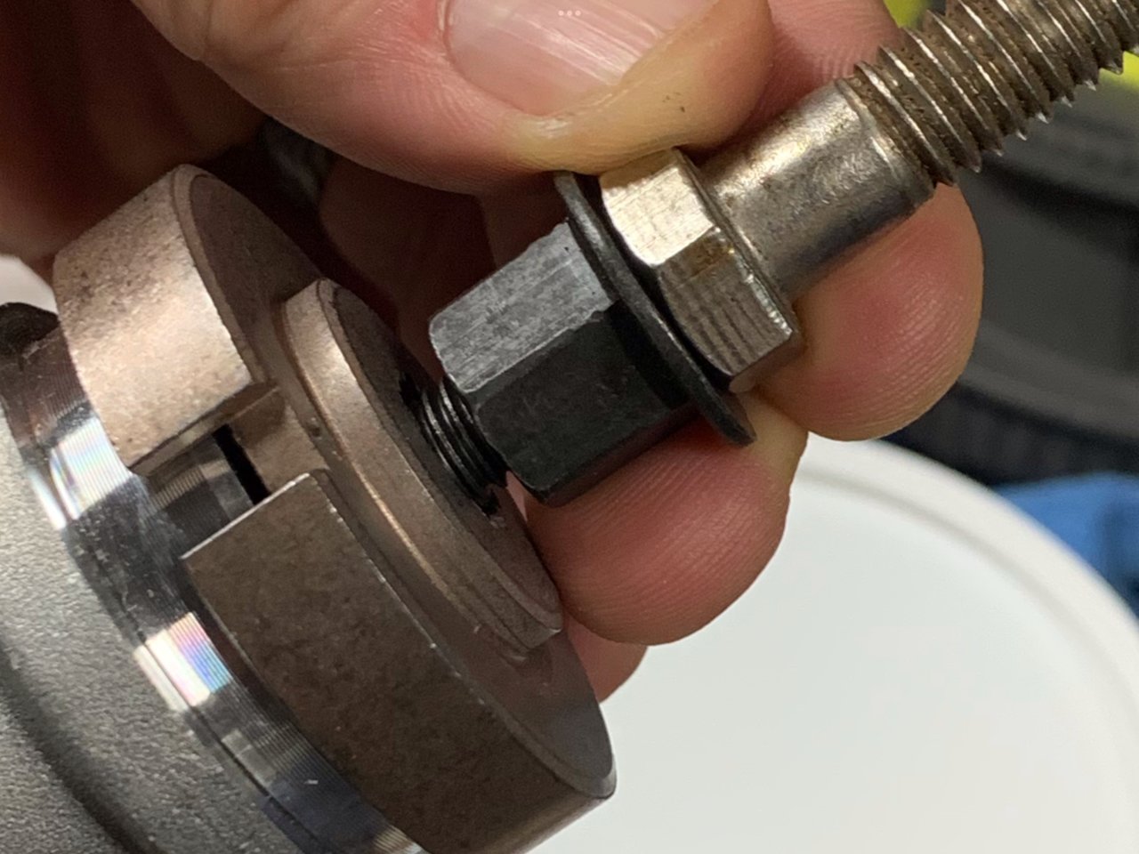

    This would be something I’d take to work and ask for a favor from the shop!
  3. Apr 27, 2022 at 2:54 PM
    308savage
    308savage Well-Known Member
    Mar 6, 2016
    #180389
    4,943
    Adam
    East Tennessee
    2012 Tacoma TRD Sport DCSB
    Leveling kit, roll bar
    Or take 30-45 minutes here and measure 18 times and cross my fingers! I could chuck it in the vise and try.
  4. Apr 27, 2022 at 2:57 PM
    wilcam47
    wilcam47 Keep on keeping on!
    Jan 27, 2016
    #176243
    54,878
    Will
    Bourbon state
    If you have a drill press it would be easy. Pilot drill a 1/8" piece rod centered on both pieces. I prob wouldnt try freehand...
  5. Apr 27, 2022 at 3:08 PM
    308savage
    Mar 6, 2016
    #180389
    4,943
    Adam
    East Tennessee
    The small black nut has threads on the inside, it threads onto the shaft from the weed eater

    Cut the head off that bolt and thread it to match the black nut

    needs a left hand threaded bolt

    Left handed can be done

    I bet those threads didn’t like it.

    You'll want to make damn sure you don't have any runout.

    Gonna need a left hand bolt and nut or the torque from the motor is going spin off the prop...then this ordeal becomes an anchor.

    Double nut/jam nut?

    You need a coupling nut.
    https://www.fastenal.com/product/Fasteners/Nuts/Coupling Nuts?categoryId=600076

    Another question, how do you measure thread pitch on the trimmer shaft?
