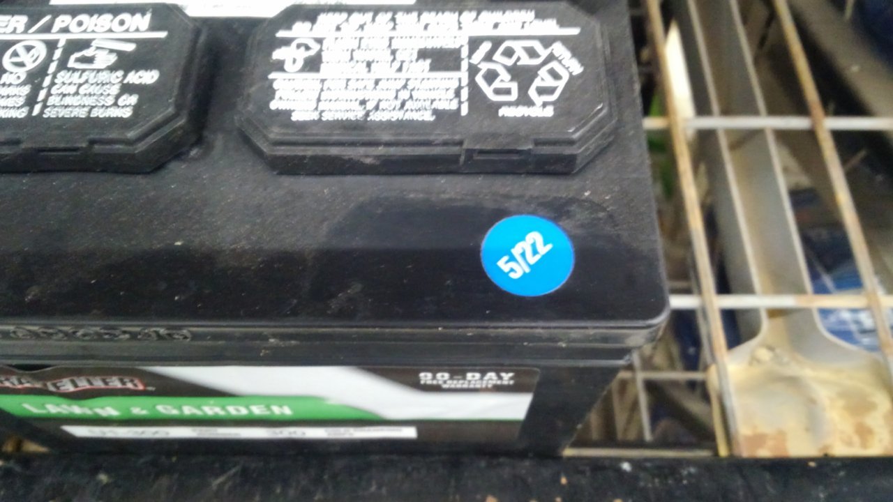

    Well, my local TSC has perfected time travel. (corporate probably)
    This battery was made 5/22... :notsure:

    The oldest I saw on the rack was 7/21!

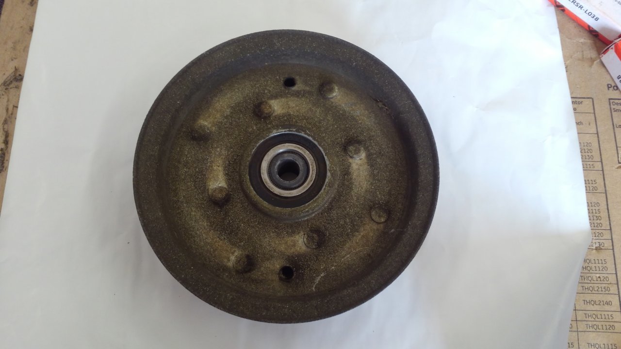

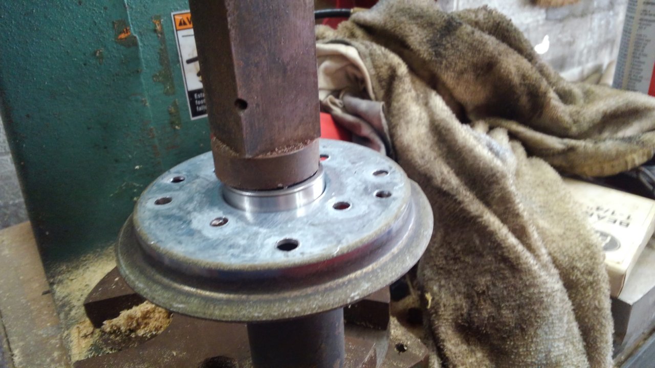

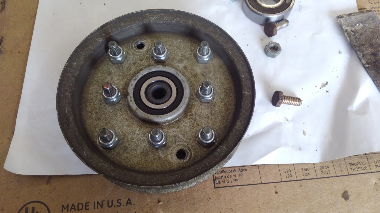

    Well fellers, today on Past Tech with Rusty we aren't working on something too old, my 2006 Zero Turn mower. It was making the well storied "funny noise".
    This pulley (and an identical friend) made a zing noise, bad bearing. We can see it is a common 6203RS bearing, only a few dollars. But how to get it out? It is spot welded together...:mad:
    First we press the adapter out, some sockets work well for this. If you don't have an arbor press you can use a vice or really just tap with a hammer, it isn't a real tight fit.
    In process photo.
    And success! When working with (good) bearings the important part to make sure the bearing is supported properly so it isn't damaged.
    But still, it is spot welded together... :confused:

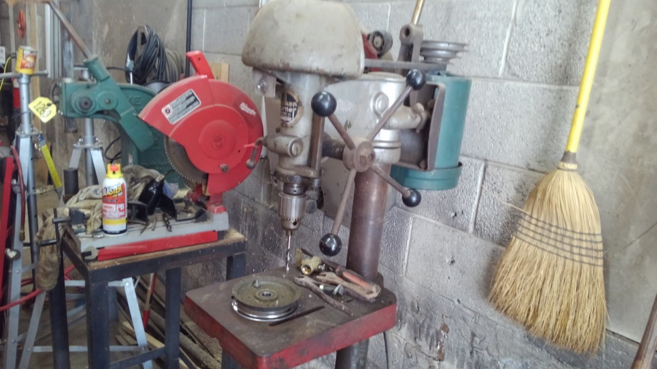

    However a 1950's Walker-Turner drill press and a 1/4" bit can fix that problem for us!
  13. Apr 30, 2022 at 6:09 PM
    RustyGreen
    Aug 12, 2020
    #337468
    14,602
    sleeping in a chair
    2017 AC 4x4 Sport 6M Inferno
    Pavement Princess
    PTwR page 2

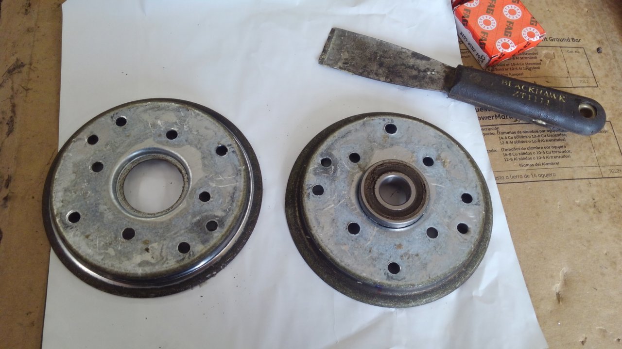

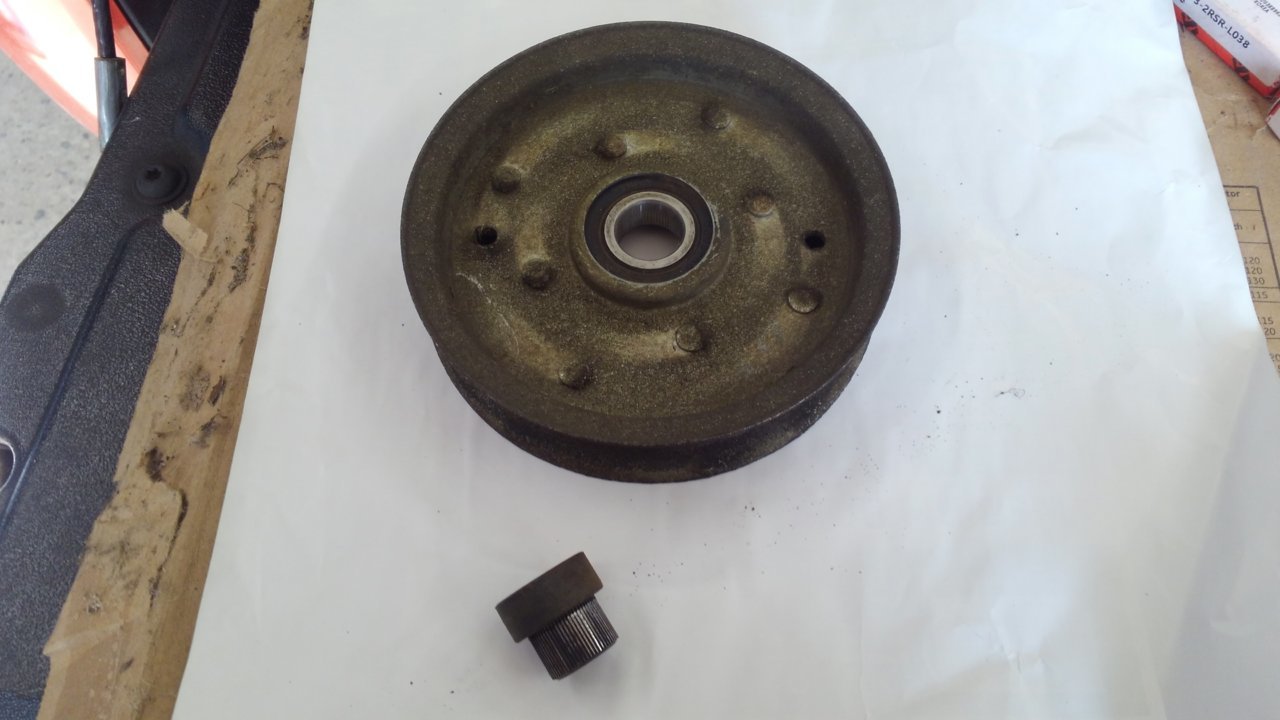

    After drilling all the spot welds out a putty knife assists in splitting the halves.
    The old bearing will just tap out, it is junk so we don't need to be too careful, just don't bend the pulley.
    Using the arbor press to seat the new bearing, again it isn't a real tight fit so the press isn't 100% needed, just nice to have.
    Smoothly pressing the 2 halves back together, notice the bolts to keep the holes aligned.
    A butt ton of bolts with nylock nuts replace the spot welds, probably didn't need them all -- but bolts are cheap. You can see the insert is already pressed back in place. The bolts are where the original spot welds were, 8 for 8. The two open holes were already there, probably for assembly in the factory.
    A new pulley is $30 or more, with a $5 bearing, $1 hardware and a 1/2 hour you are ready to mow and now it is repairable in a few minutes.
    Make sure you press the insert in on the side where the protruding bolts aren't going to hit anything. ;)

    Didn't think of it at the time, the originals lasted 15 years and they were a China bearing. :notsure:
