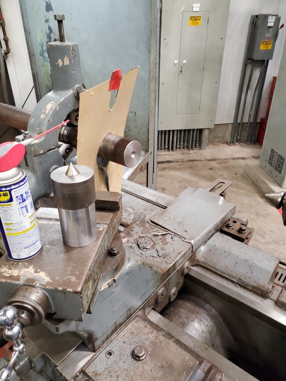

    This fan shaft I'm working on is only 64.5 inches long. I'm going to turn it between centers. All I got done today was both ends center drilled and faced off to length. In order to center-drill and face the ends I had to turn a small area for the steady-rest to run, both sides. Trip to the band-saw in there to cut about a foot off. (The bar-stock was already set in the lathe...term set used loosely)
    I couldn't find a center for the chuck / drive end that had a shoulder on it. I've had a part push back in the jaws because of that...once, lesson learned. So anyway I turned the piece on the left so it has a shoulder to butt up against, and I'll have to skim cut that angle (pointy thing) before I put the bar in and start turning. It has like 3 different diameters but most critical are short distance for the bearings.

    I forgot to mention that I have a 4-jaw chuck that goes into the tail-stock. How I get it running true to cut the bearing area for the steady-rest.

    Between centers huh. Can't say I did that much. Got a lathe dog?

    Several of them. I'll try to remember and post a picture when I dig one up for this job. It's a fairly sure way to know that the bearing diameters are going to run true with each other.
    This particular shaft doesn't have that much material to take of like other shafts I've made, and that caused that center to push back when I was hogging a bit. Always keep a eye on the live center and sometimes I'll put a fingertip on it to make sure decent engagement.
