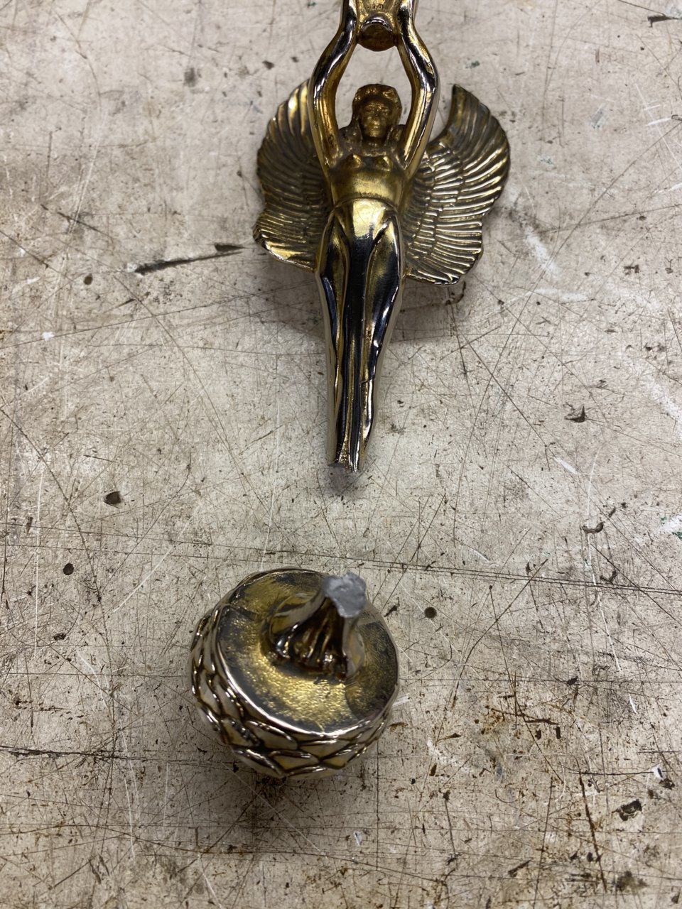

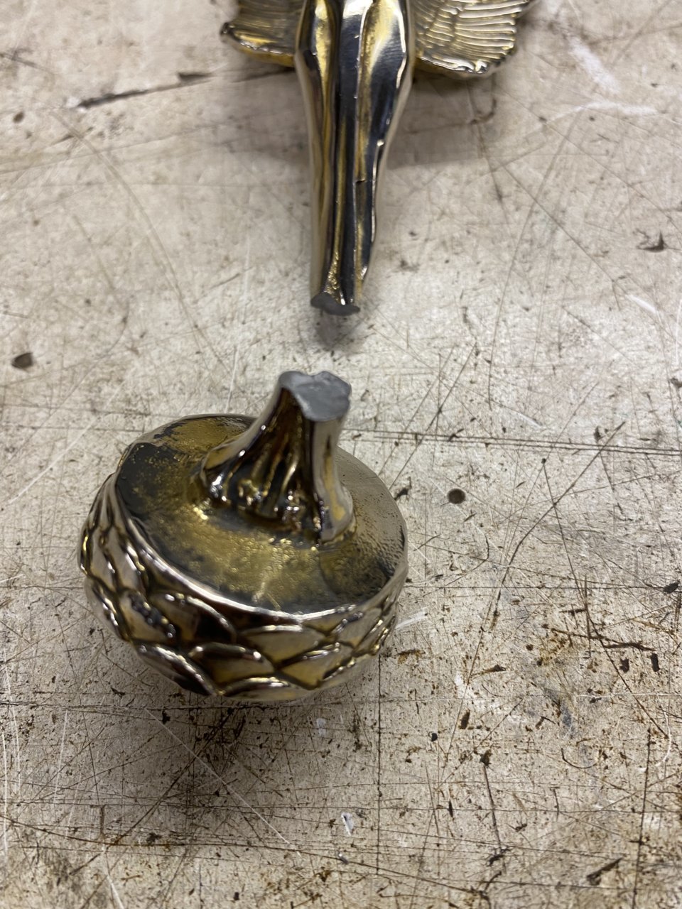

    He suggested threading both pieces and screwing it together. I said it won't line up, he said I know. I said the biggest challenge is holding it. He said can you build a fixture?
    Is it worth that much o_O

    The only lasting way I can think of would be to turn a thin, brass sleeve just large enough for both ends of the 'stem' to slide in to, and then fill with epoxy and cross pin it. The contact area at the break is too small, IMHO, to make epoxy on its own, reliable.

    I agree, it's too small for just epoxy, and it's very top heavy.

    That'll be a weird one to get a grip on. You could temporarily epoxy them back together and then drill from the bottom all the way up onto the main body where it gets thicker. Then do a ridiculously long tap and run a length of all-thread or the like up through it with Locktite.
    Depending on what the base looks like I suppose.

    He handed me a card, he is a polisher. I'm not sure if he broke it or it came to him broke. I'm assuming the first but not sure.
