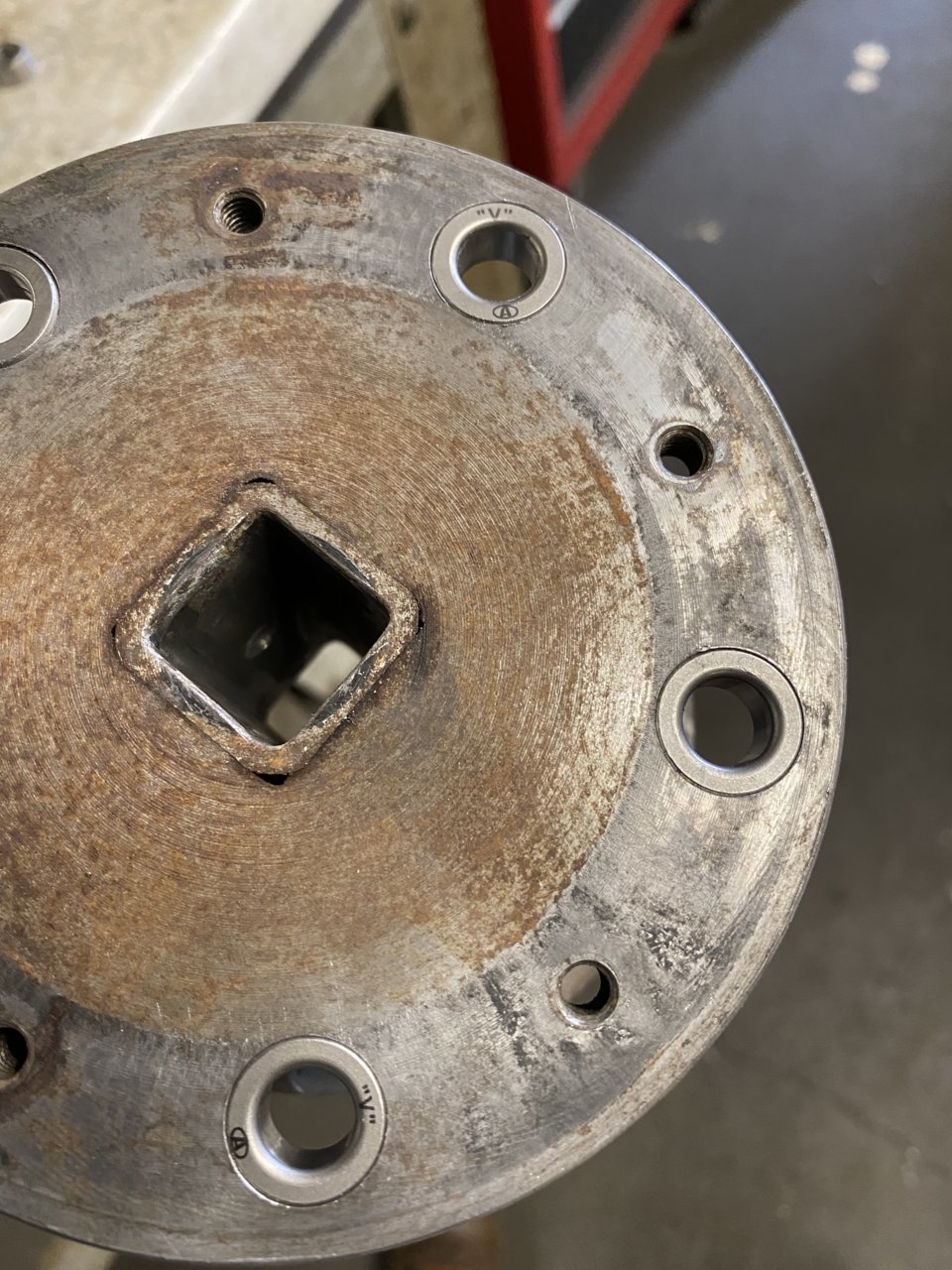

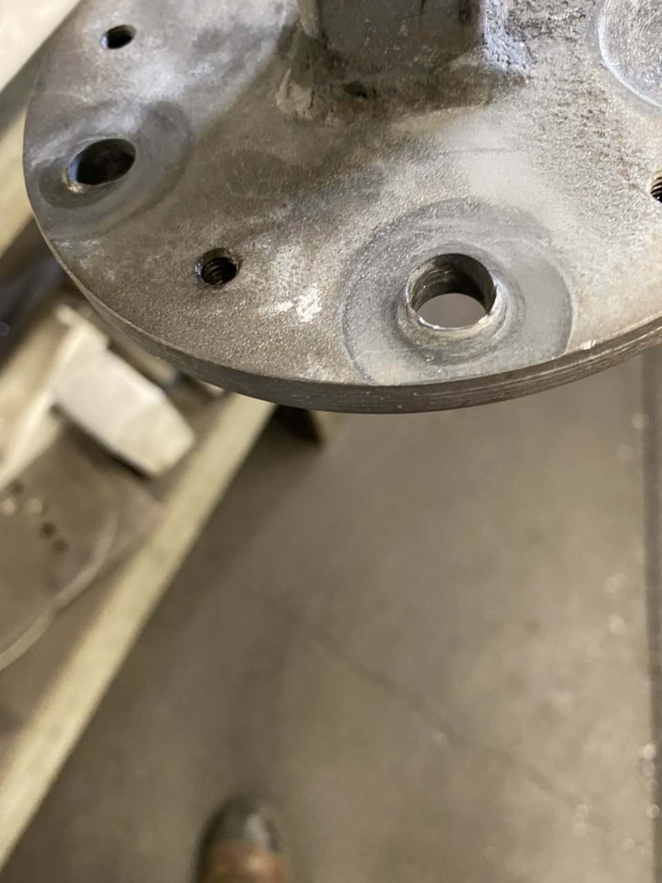

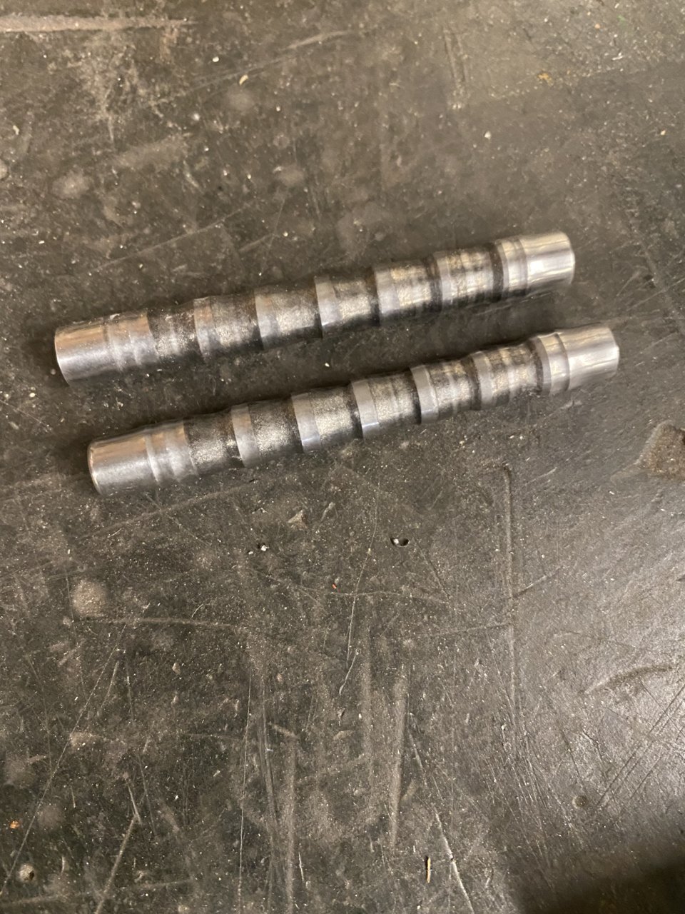

    I made this drum a few months ago, the hardened dowel pins wore the hot rolled material along with themselves. The solution they came up with, put hardened bushings in it. I told the boss the first time they use it the bushings will wear the softer material and fall out.
    :facepalm:
    There’s theory and there’s application. Prove me wrong boss man :rofl:

    Whole disk needsto be hardend..

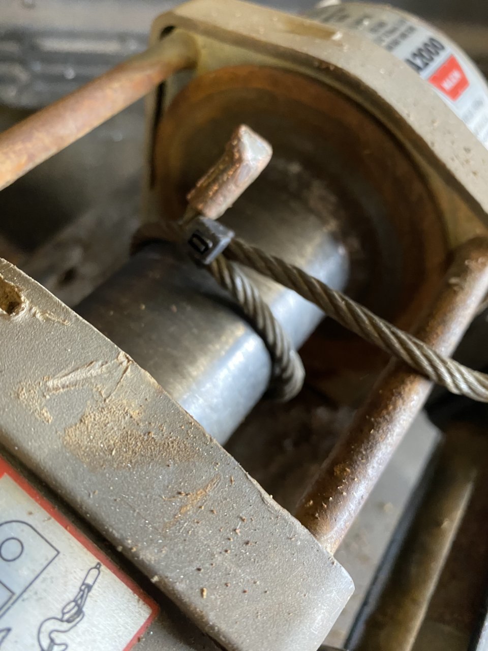

    I needed to move this wire to the bottom so I unspooled it. :facepalm:

    Yeah...may want to leave a couple of wraps on that set up

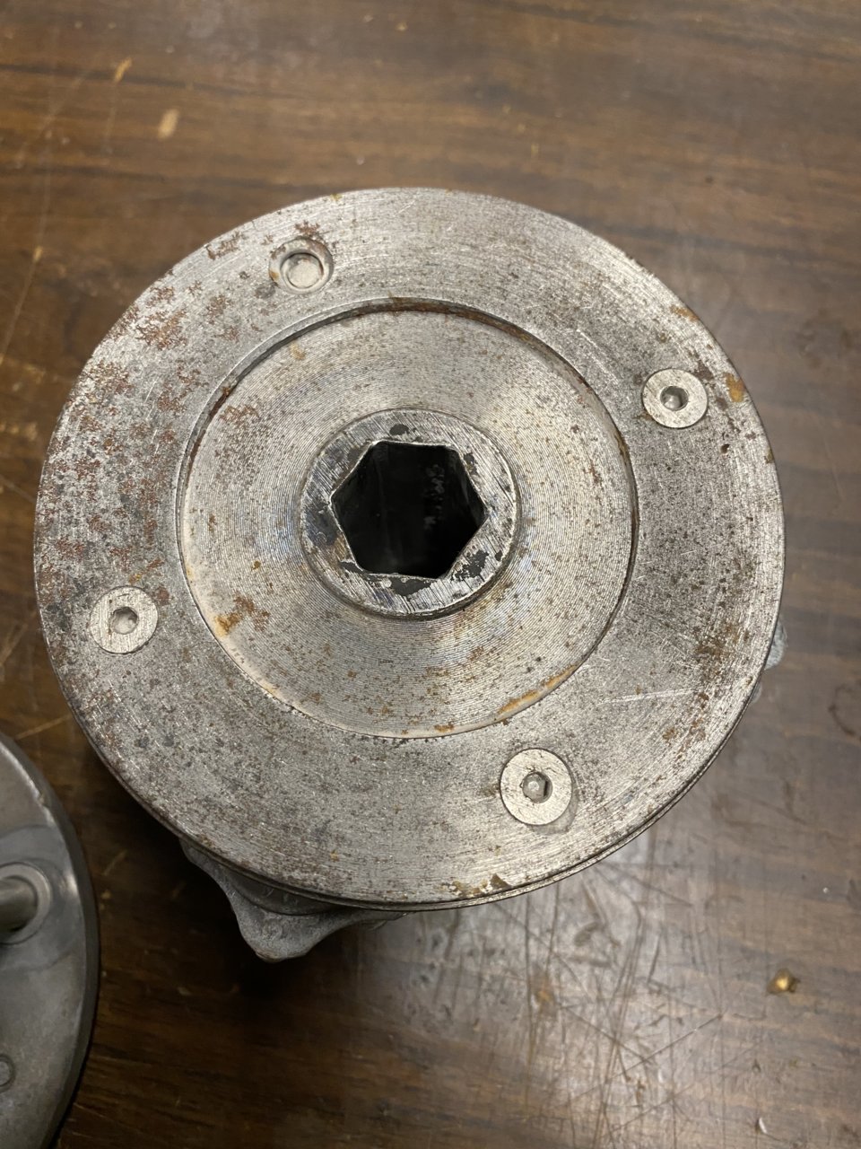

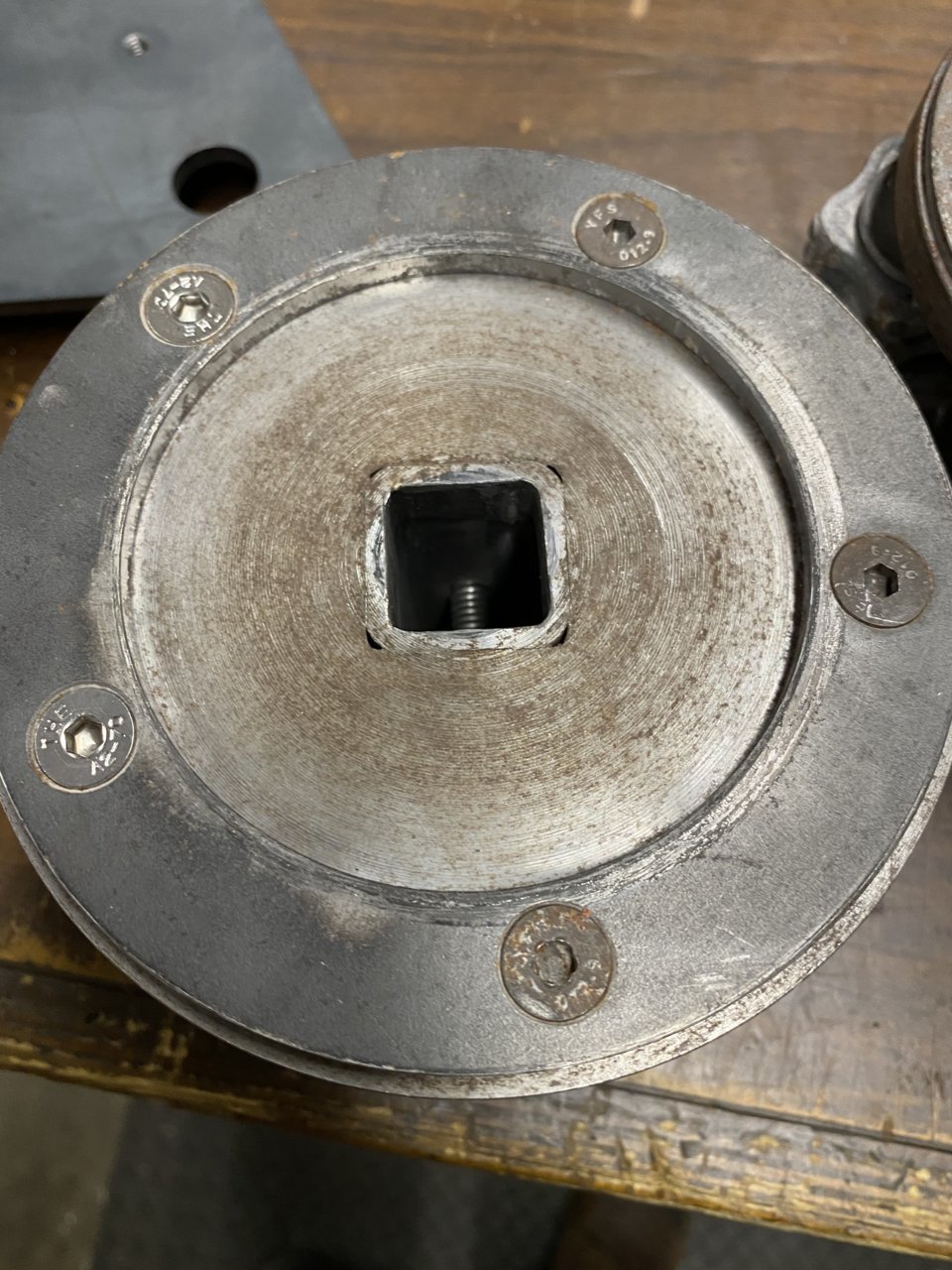

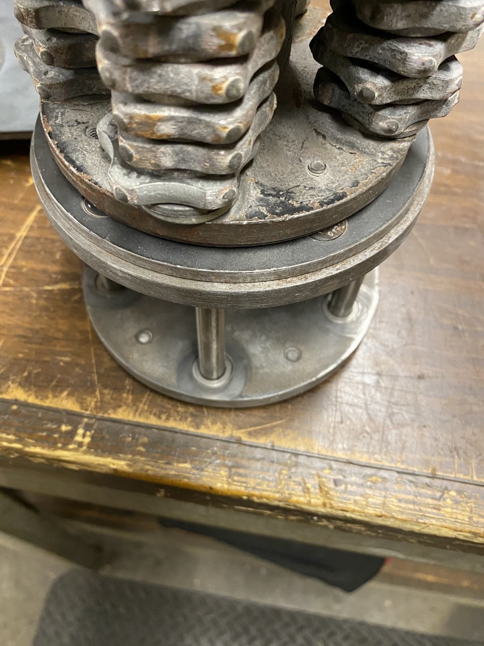

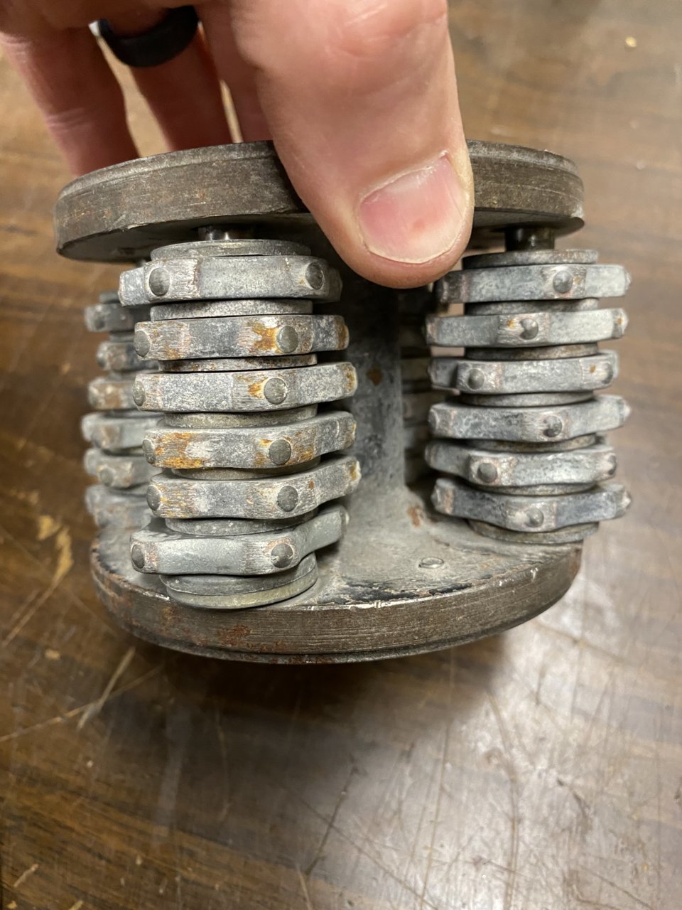

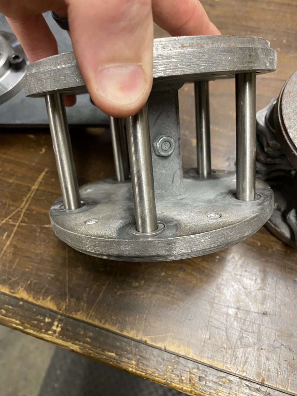

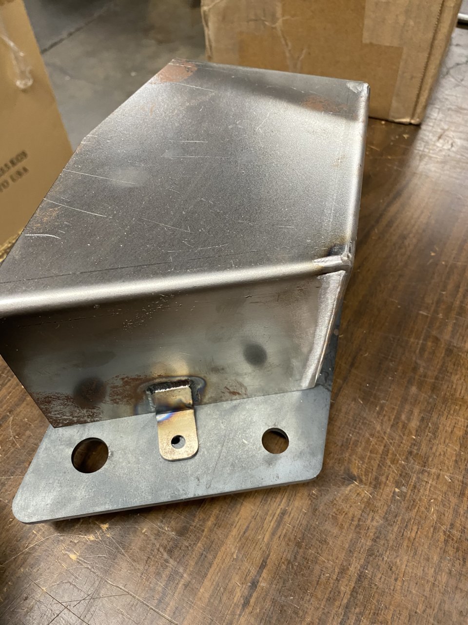

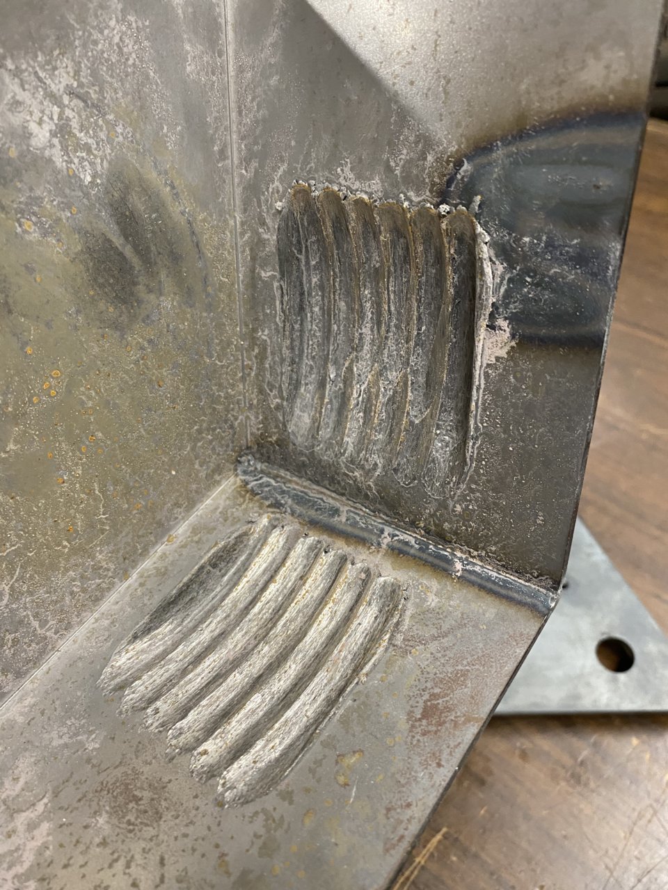

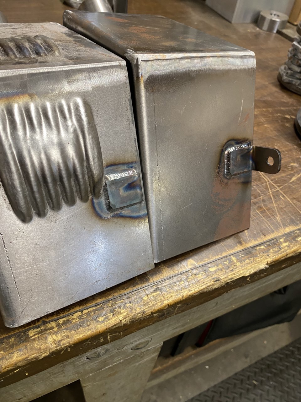

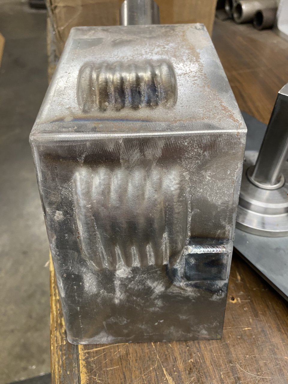

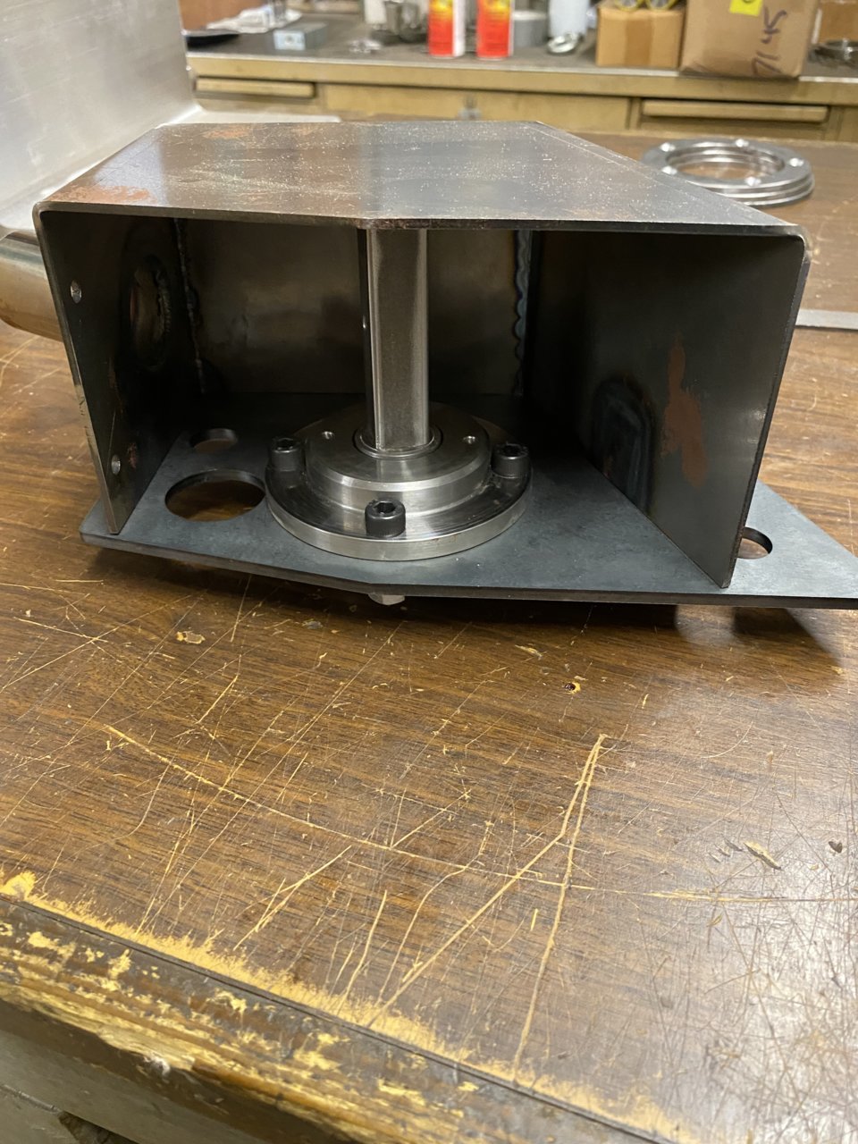

    We need to change the kool aid around here. Seems like we take 1 step forward and two steps back.
    This is an original drum from Switzerland. It’s metric hex inside and has 4 rows of blades.
    We made the square one and the customer said make it like we did for another customer that had 5 rows of teeth and the square inside. We made one and they didn’t say anything about it hitting the cover.
    Boss man copied their cover and we had a fab shop make two. I put it in a few weeks ago and it fit great. They didn’t have the blades on though. Here’s the shaft it goes on we made and one of the new covers.
    Customer just came by and said I told you it was hitting :annoyed:
    Time to make a bigger cover o_O

    Looks perfectly machined in place to me:anonymous:

    Imagine the racket when they fired that thing up:confused:

    They used it like this for a job :facepalm:
    They broke the front tab off, it was held on by one 6mm bolt on the back side :eek:
