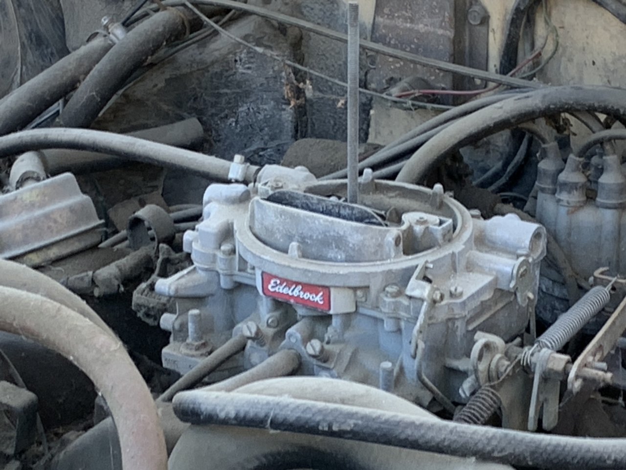

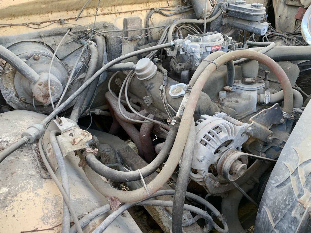

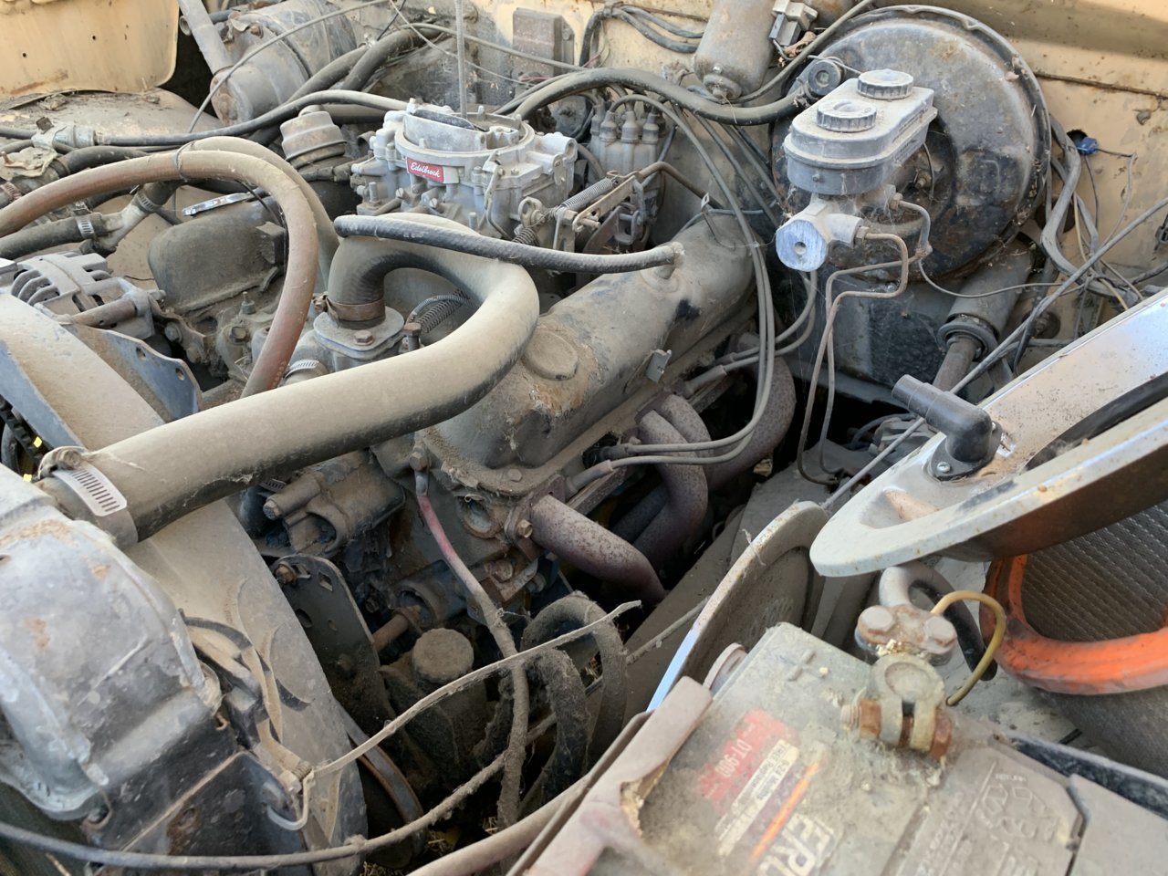

    We took a look under the hood. Might try to see if it'll run. Not postive what size this motor is...thinking 318 or 360 cu in; I'm leaning towards 318. :notsure:

    It is an LA series small block, either 318 or 360.
    That brings back some memories, I remember laying over the fender/engine to tighten the distributor hold down bolt -- cursing all the way. The Chrysler big block engines had the distributor in the front (and Ford, Buick,IH & AMC too).
    Looks like that truck has locking hubs too, hopefully it has a part time transfer case. Many of the 1/2 ton Dodges from 74-79 came with a New Process 203 full time transfer case, they were quite tough. The problem (as always) was the driver -- people didn't understand the full time transfer case and did amazingly stupid things to them.

    We checked the door jamb...1979.
