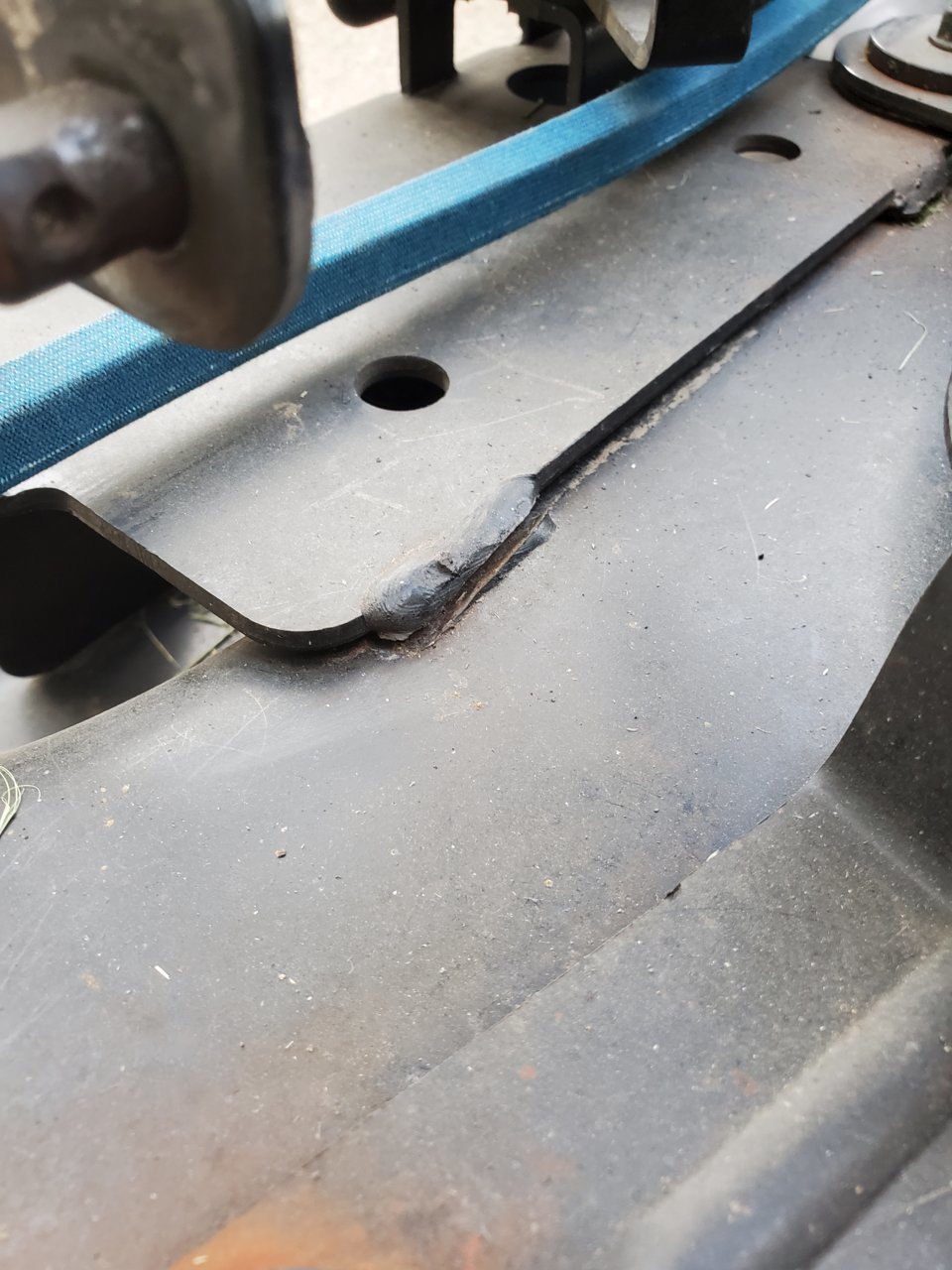

    Wish that I had a little welder handy.
  8. Jun 3, 2022 at 5:12 PM
    tacotoe
    tacotoe Pastry Chef
    Nov 25, 2007
    #3593
    5,915
    Nebraska
    `17 AC Sport MT
    ARE Topper, Icon aal, OEM Audio+
    Pffft...spring tension hold 'er together for awhile

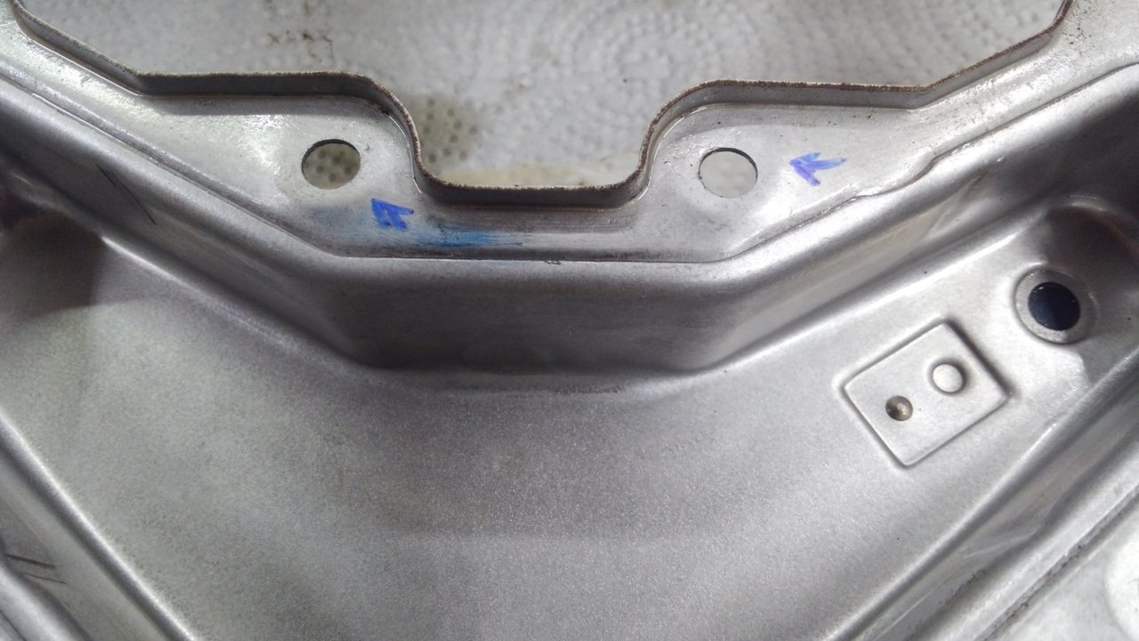

    Something I forget to add, notice how the bolts have distorted the valve cover over the years? If you put this back on this way it might damage the gasket and leak. Leaking is what got us here to begin with...
    This is easy to fix. Place a block of wood under the rail and tap the depressions back down flat with a small hammer, an appropriate sized punch can be useful as well -- if you have someone to hold the valve cover while you are hammering and punching.
    If the metal ends up slightly bowed the opposite way that won't be a problem, the bolt will pull it back flat.
