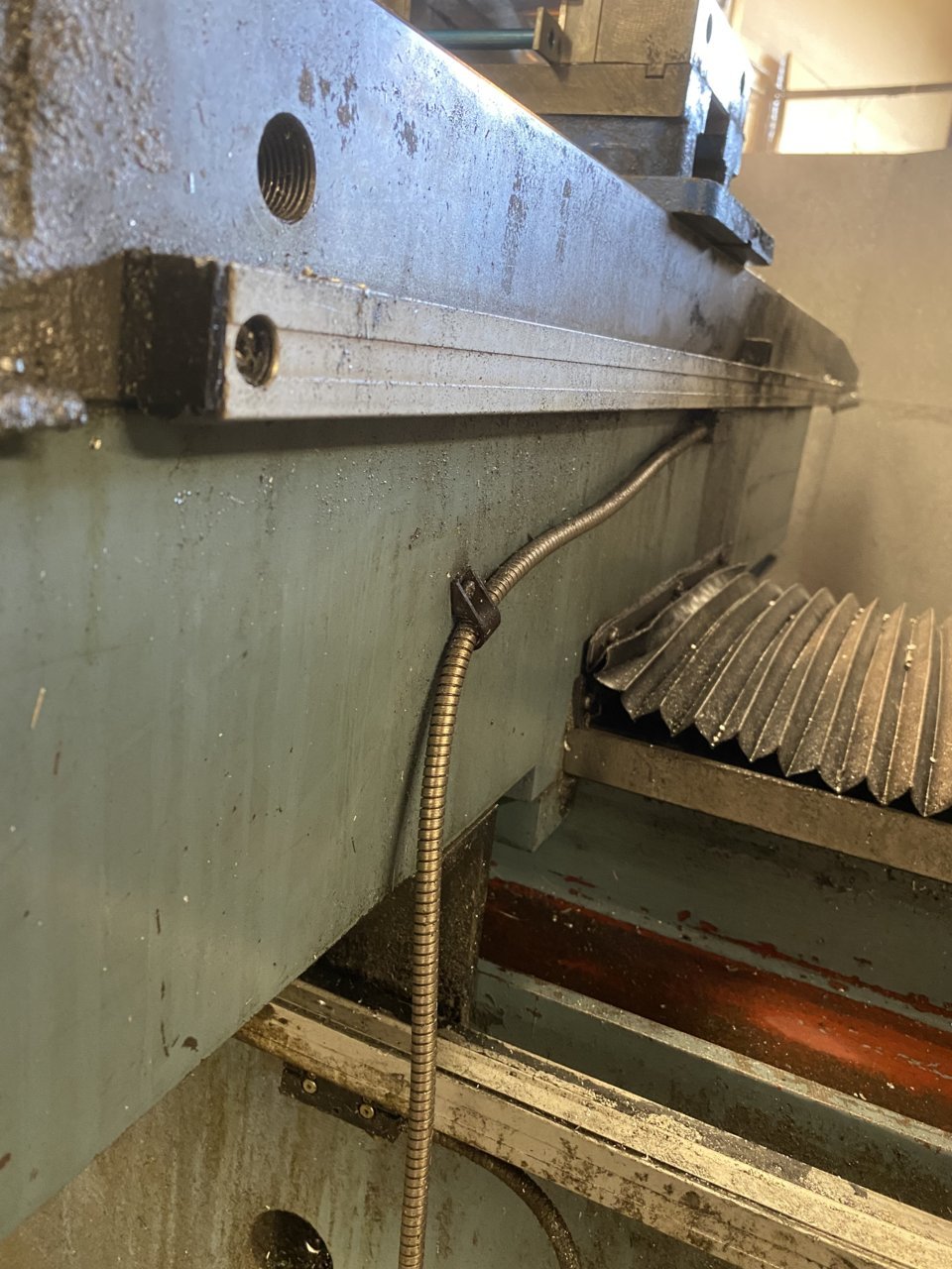

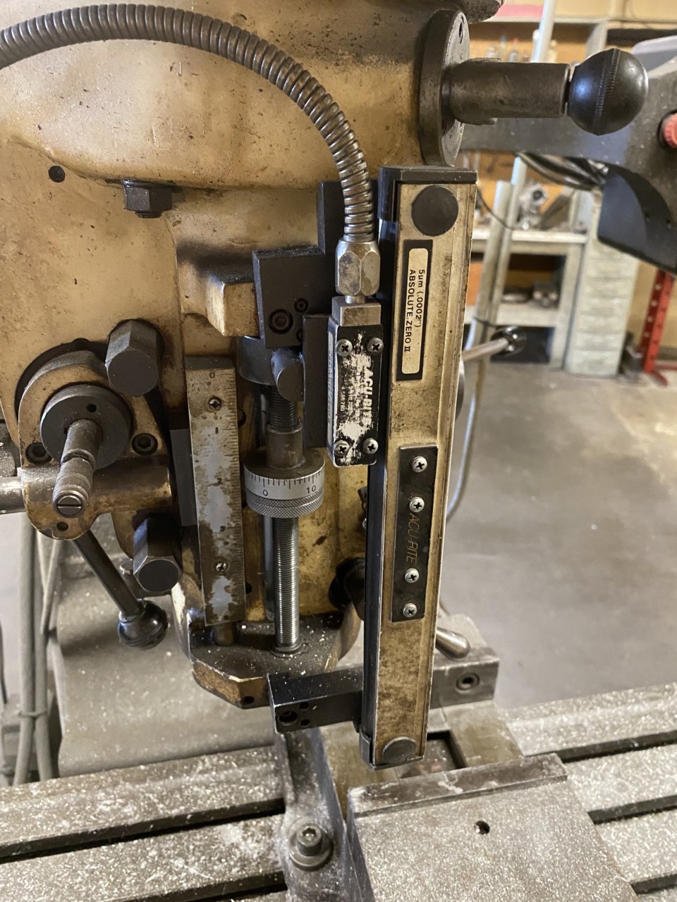

    Milling machine is fixed, man do I feel like an idiot.
    Service guy was here 30 seconds and had it going, turned the glass scale off on X axis. He turned Y off about 5 years ago when we were having trouble with it. My baby is healed :goingcrazy:

    Glass Scale?

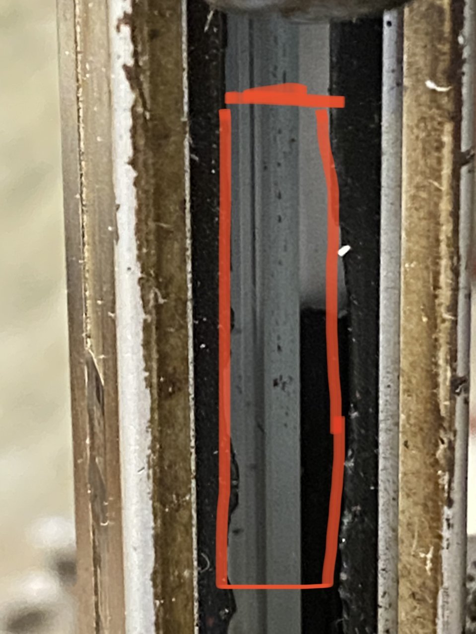

    There is a bar mounted with a piece of glass on it that a reader rides on. You can barely make it out what I circled in red. They get dirty, worn, etc. turning it off makes the machine read the encoder in the servo motor.
    The last photo, the cable coming in from the top is attached to the reader that moves along the glass inside.
