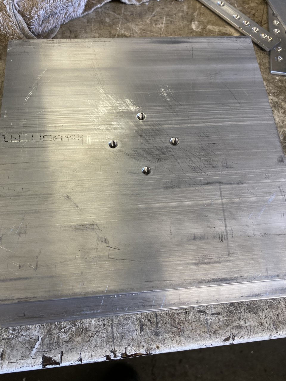

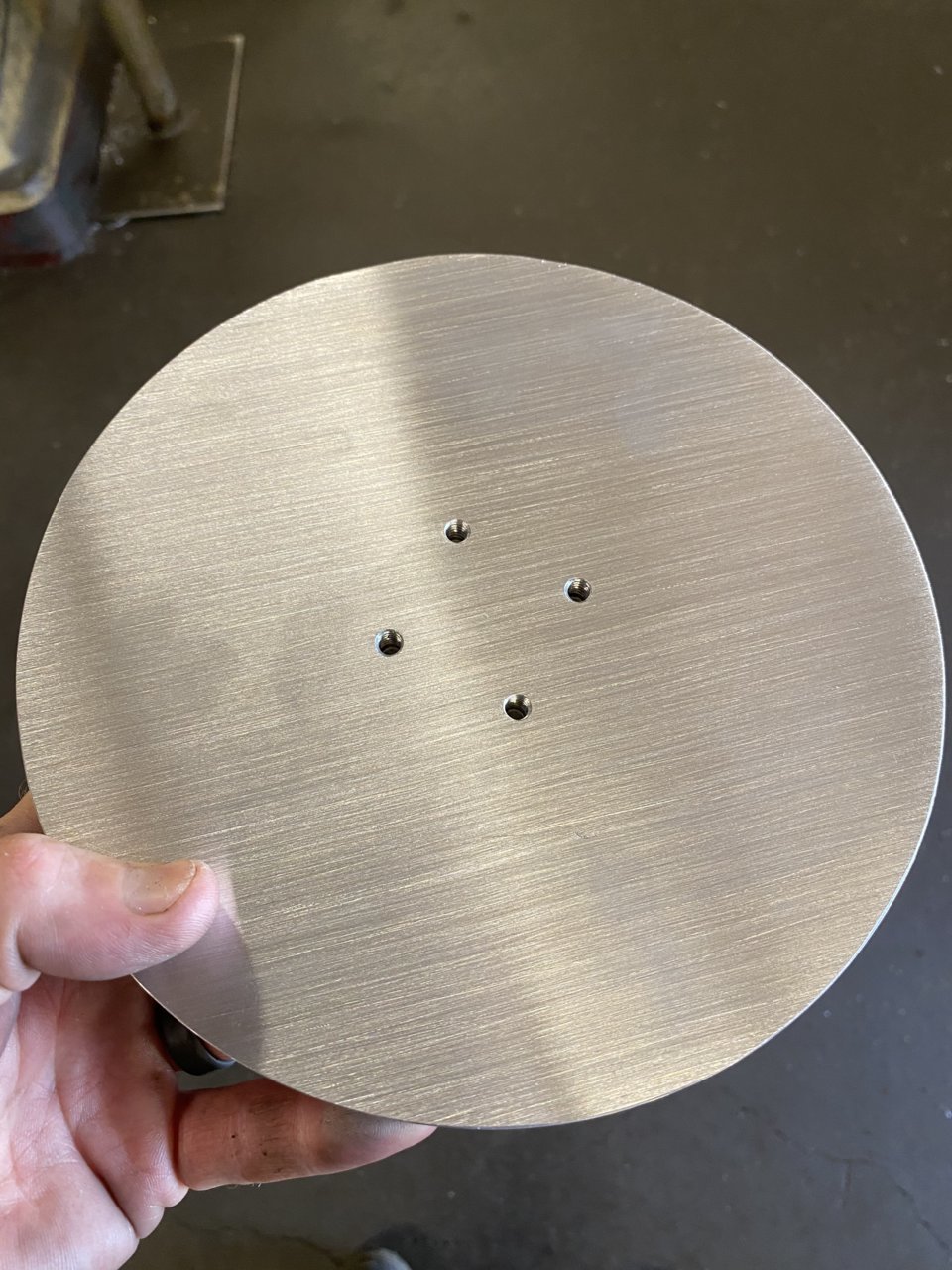

    Round plates out of square, sure thing.

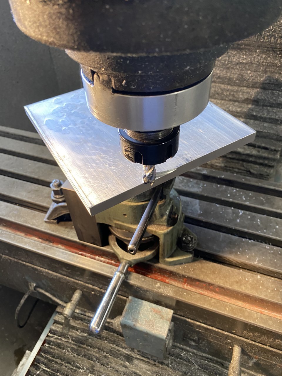

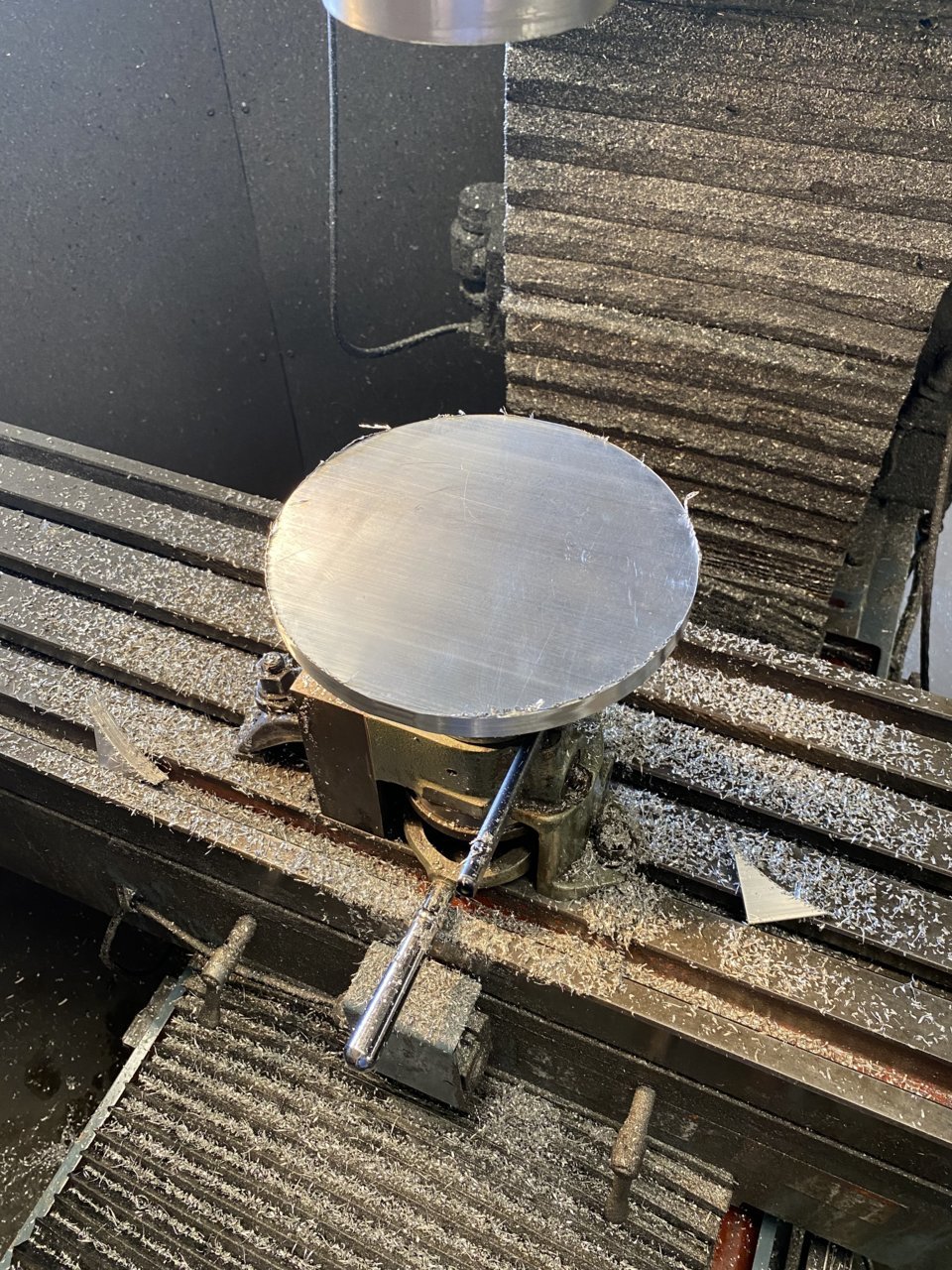

    Luckily I tapped four 1/4-20 holes 3/8” deep in the bottom and bolted them to their mating piece and held them with a collet.
    I didn’t have the collet tight enough on the first one and it started twisting.

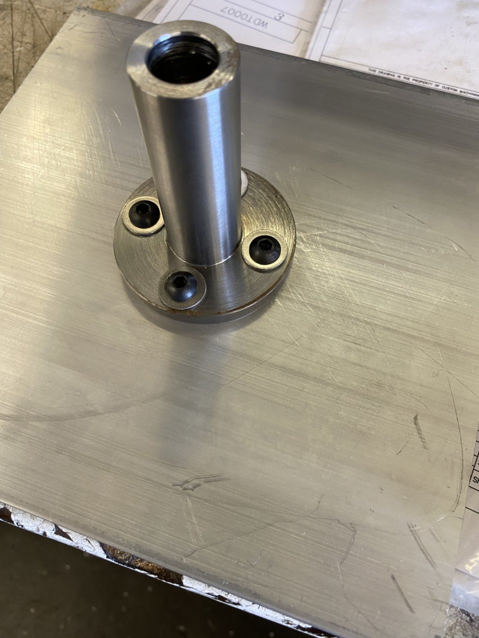

    Just got put on high alert stand by for this, got to jump on it as soon as material comes in so it can get to powder coat and be shipped to Texas by the end of the month. Painters are backed up is the biggest problem.
