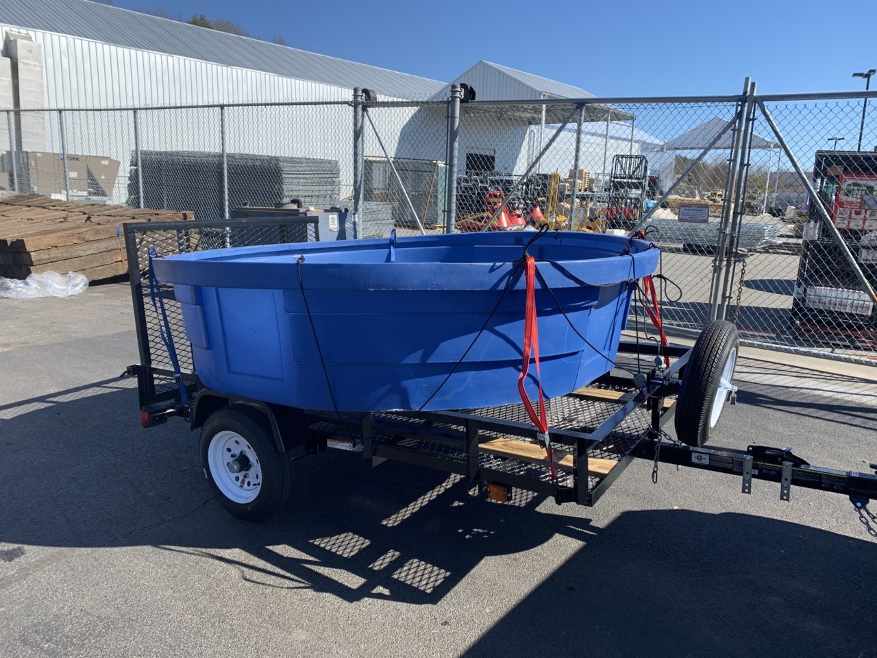

    That filter is the same cost as the stock tank!

    That's a spa, not a pool.:cool:
