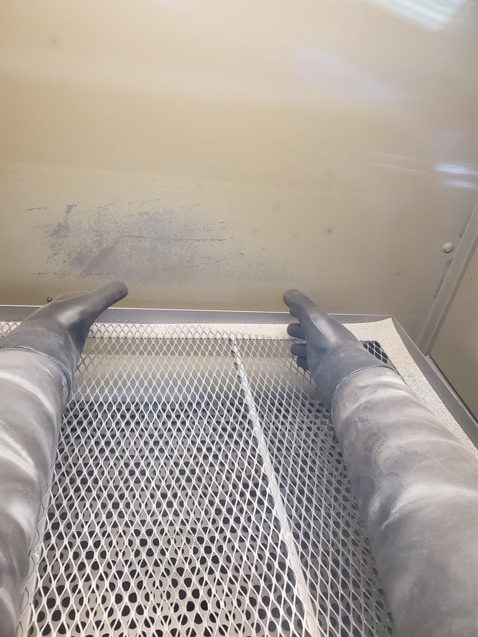

    I'd love to have a sand blaster!

    You and me both! A parts washer too!
    This particular cabinet cost about 10k I believe :eek:
    Clemco Zero Pulse or something brand/model

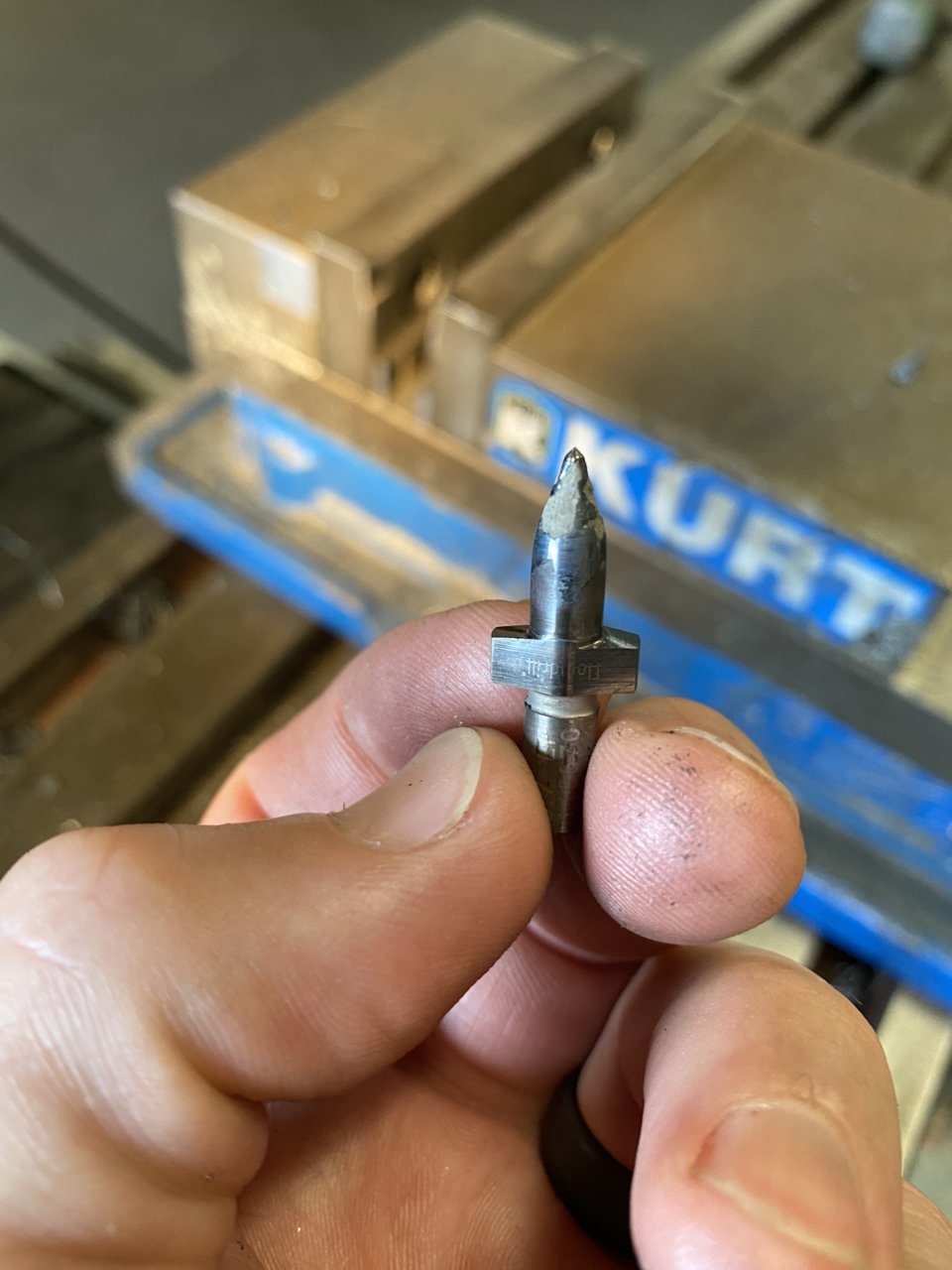

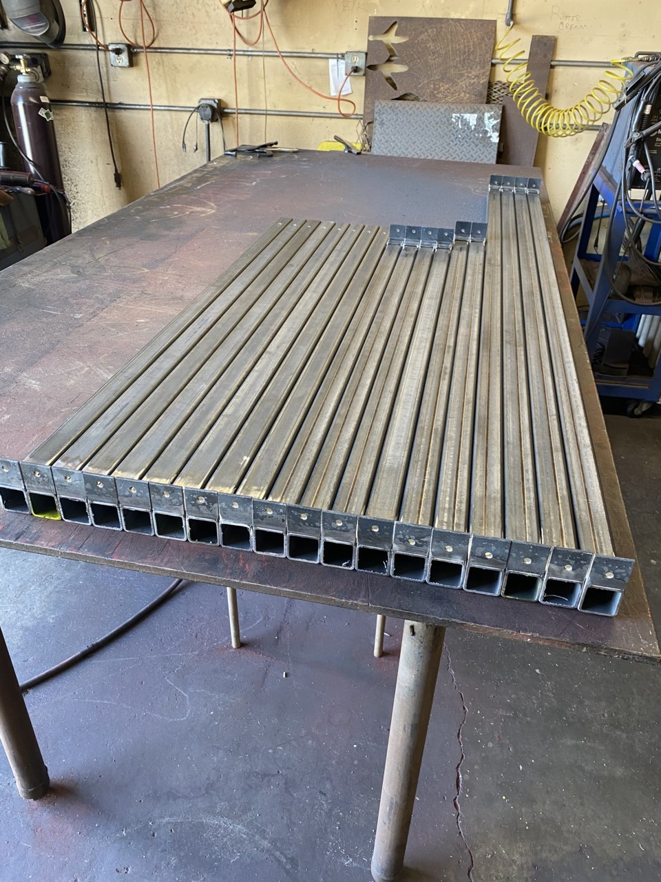

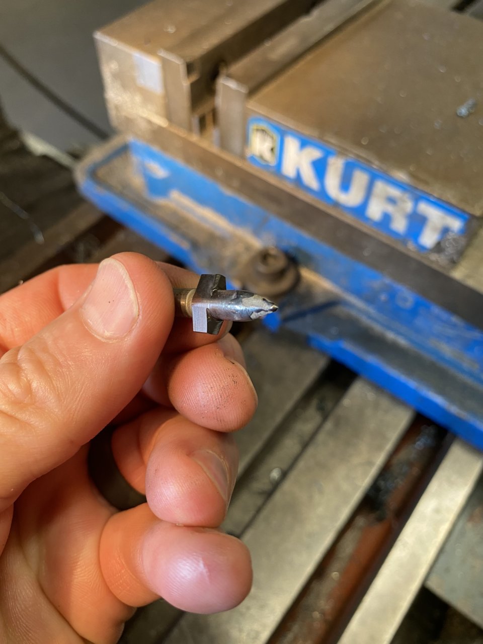

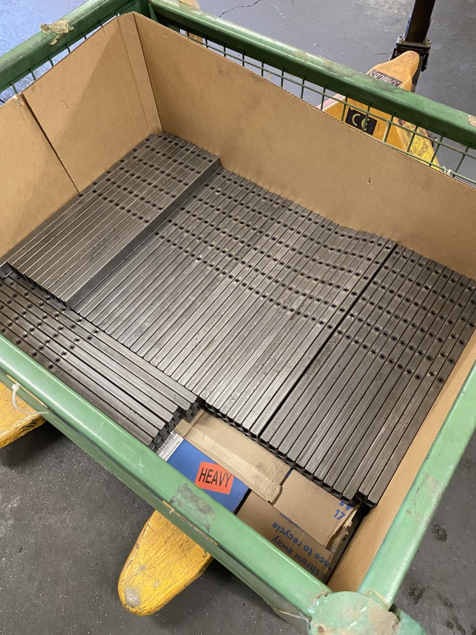

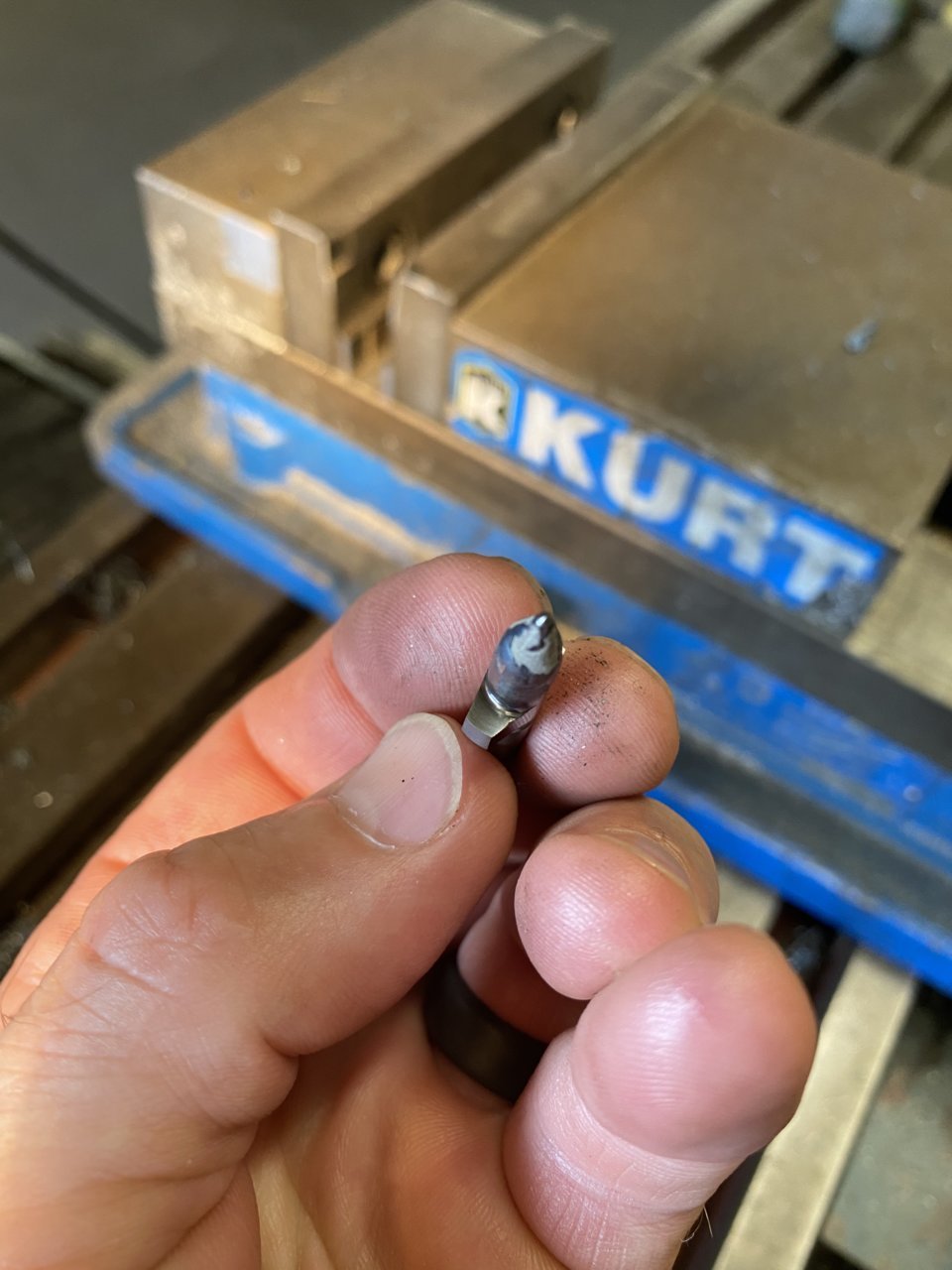

    264 parts, 1,584 holes with this one bit.
    Customer came by earlier cause he “happened to be in the area” o_O
    He ask me about speeds and feeds, told him 2,400 RPM and 5.9ipm. He said that bit likes 4,000 RPM. :annoyed:
    Do you want to do it or you want me to? :D
    Come get yo parts!

    And he was probably feeding it in inches per minute and why he burnt it up and farm it out

    Last time I did these parts I did them on the 2 axis bridgeport, didn't raise the tool up when I hit go and broke a bit. He brought another one. This time there were so many I wanted to do them on the cnc. Luckily @XPOTRPR helped me figure out the speed and feed from their website. It says nothing about 4,000 RPM.

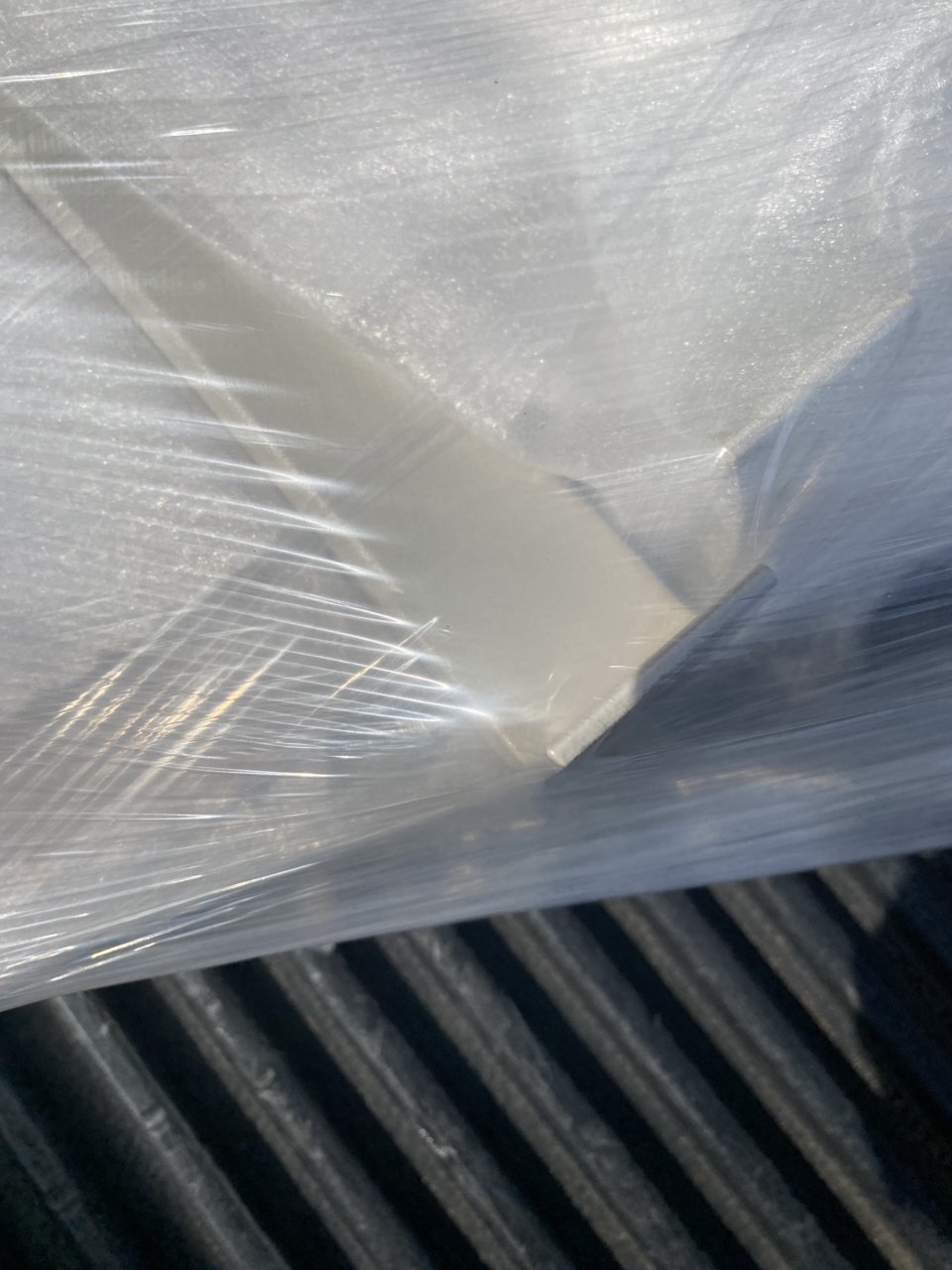

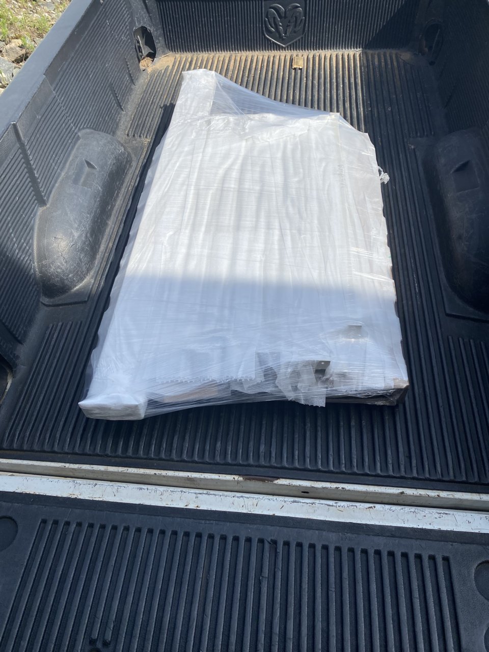

    Powder coat got it done yesterday, boss picked it up and delivering it now.

    nice! glad they worked out. Gotta love when the customer knows better.. lol
    yeah idk where he got that number from. maybe he was just trying to knock em out faster and cranked the Feed as well with it.
