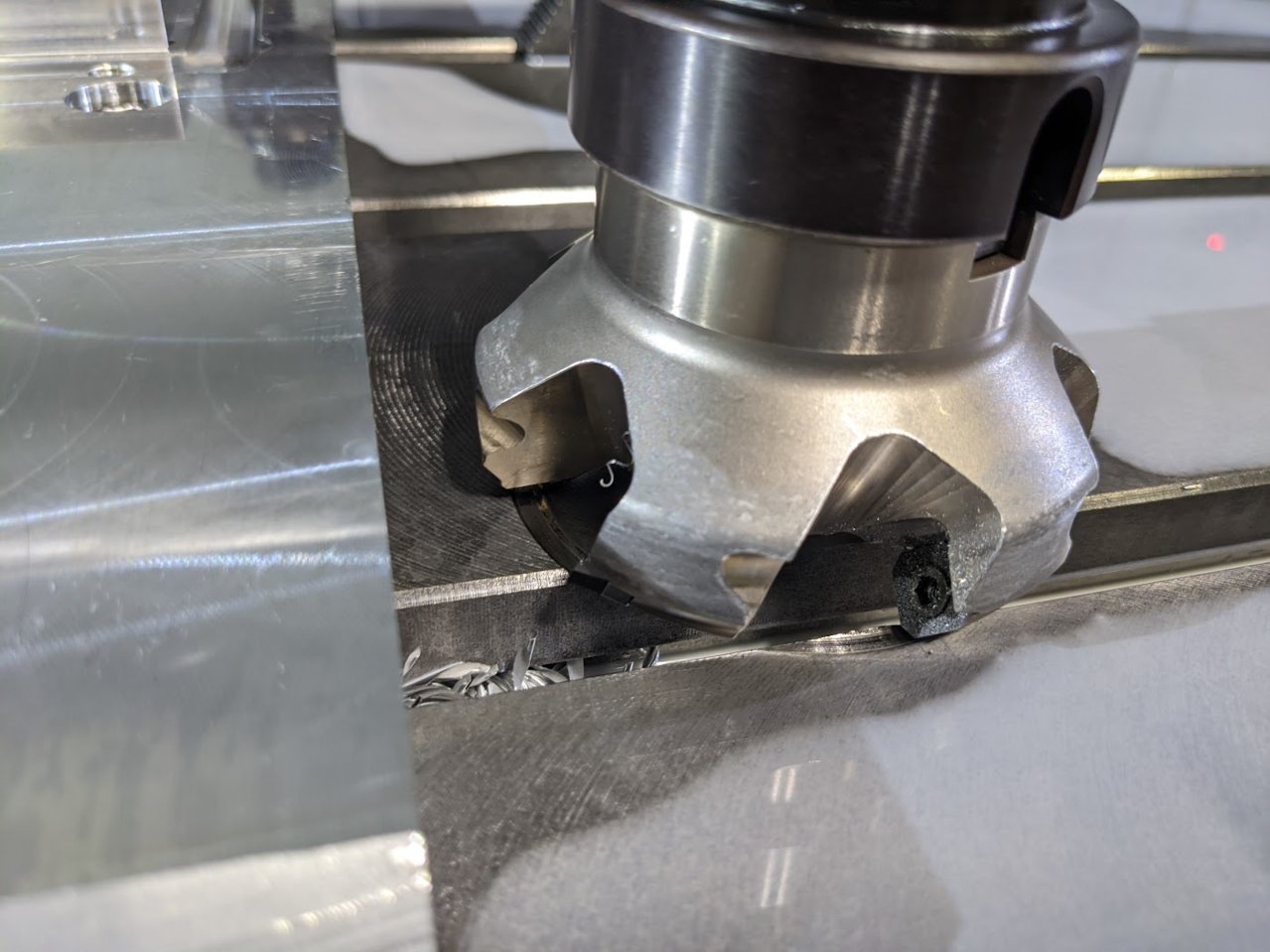

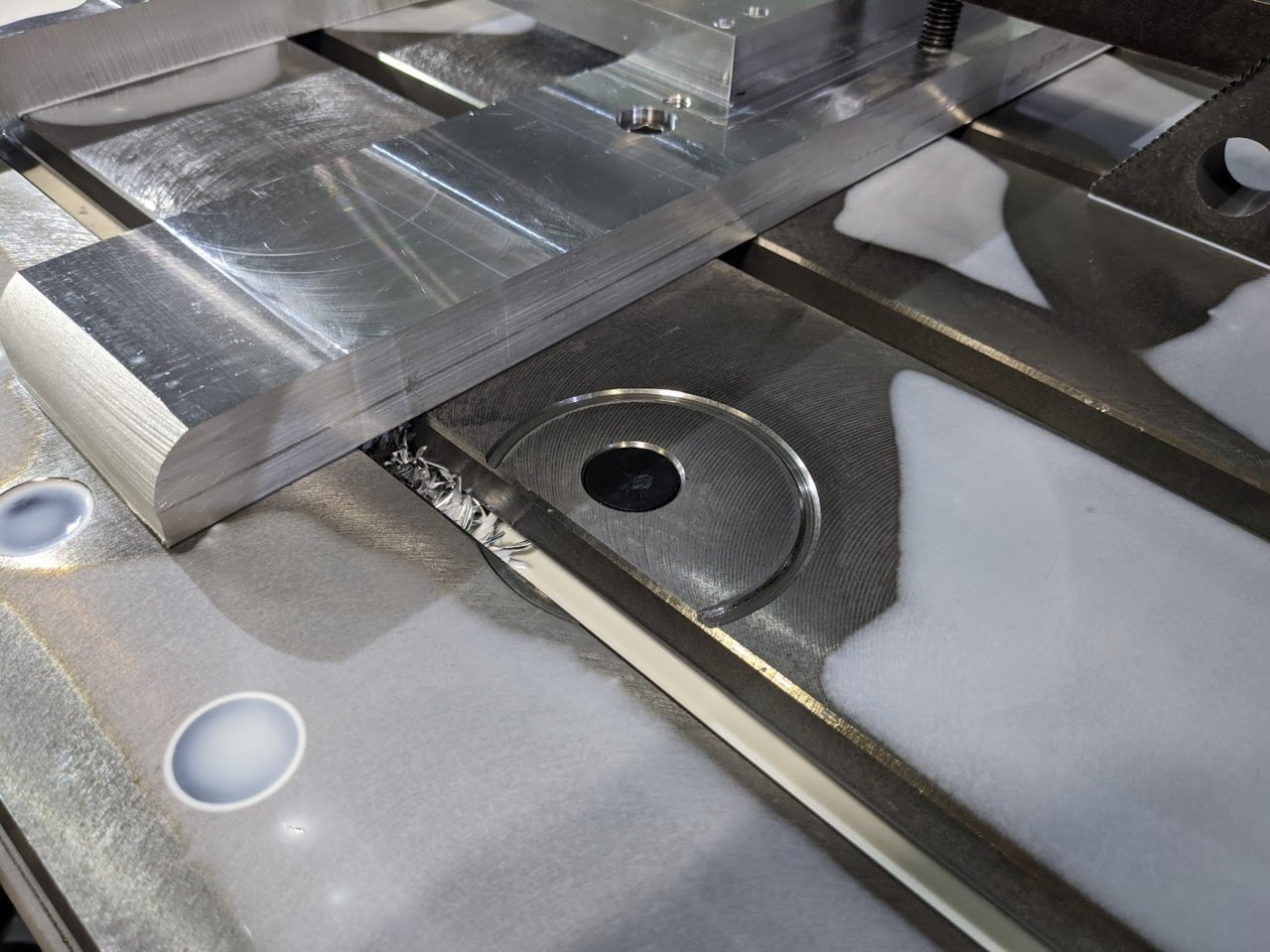

    oof.. nobody wants to be that guy tho.. lol I've done it too. One guy thats no longer here sent a 3" facemill into the table of our brand new vf-6.

    We've all done it, or will at some point. We had a guy who worked here who left the 3/4" wrench on the spindle of an old bridgeport and turned it on. It came off and busted the DRO on the mill beside it with a guy running it :eek:

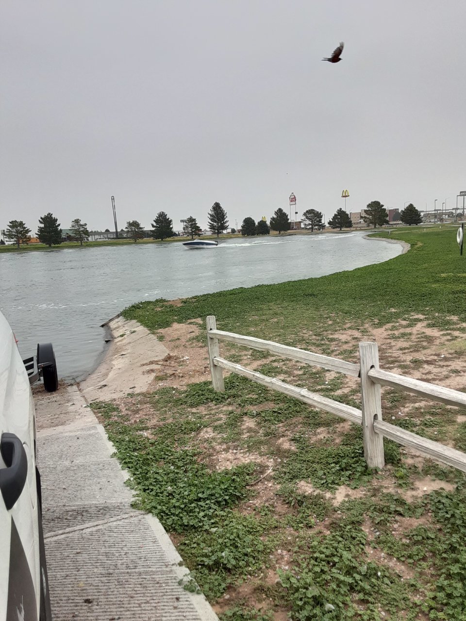

    Morning all, just churning up the goose crap in our little shop pond. 20220727_093608.jpg

    Did it stop the machine or he have to push the E-stop?

    I don't know of any shops with a pond, makes sense when you work on boats :D

    it servo'd out..
