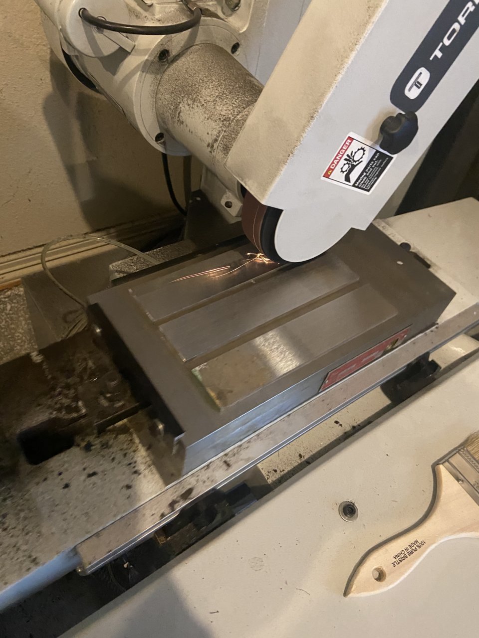

    Got the surface grinder fired up this morning. Taking some 440C stainless to final thickness before milling.

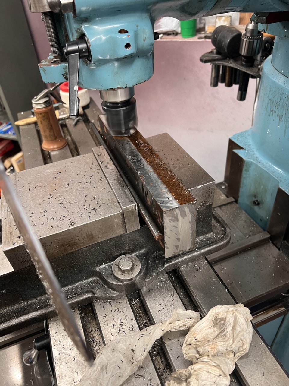

    Sometimes jobs don’t go as planned. I’ve got to take this piece of scrap down a bit to use as a press tool to put my rear end back together. When I was at UMO I pulled 4 4’ x 1.5x3 off cuts out of the dumpster. Score!!

    What's with the rod instead of clamping the work piece directly? Limiting the jaw cam?

    It is an out of square piece, so the rod will allow the vice to hold the work square to one side while I square the top, then once I flip the work over I should be able to mill the other side square relative to the other two.
    Keep in mind, I’m a YouTube taught machinist, in principle I know how this works, I may have explained it incorrectly. But it should keep this part square enough to press my axle back into the bearing.
    Also, I think this might be a chunk of 4140 which seems like a waste to use for a press blank, but you gotta pee with the wang ya got.
