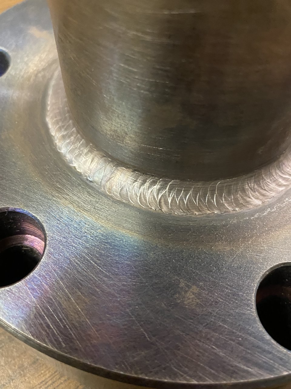

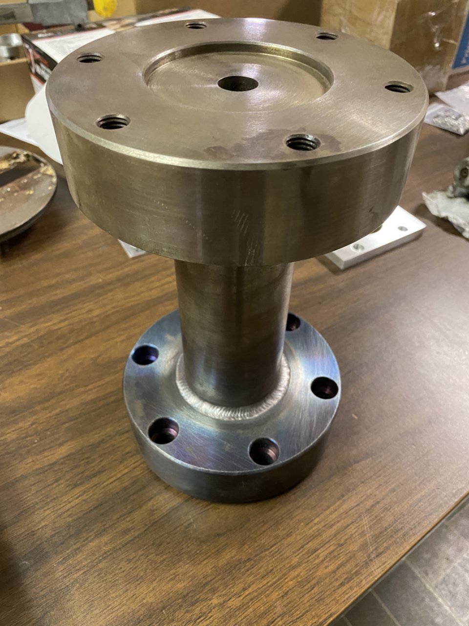

    We made this last week and since the counterbores are on the inside it had to be 2 pieces. It’s that same material we had trouble with cracking after welding so we sent it to another shop. They tig welded it with a special filler after preheating it and wrapped it in an insulated blanket and let it cool for a couple days.

    Thats amazing

    That's not welding, that's art! :eek: If you meet the feller who did that, please punch him in the nose for me?

    If it's the same guy he's twice my size but I'll tell him you're looking for him :rolleyes:

    Flatness check. SAT.:anonymous:

    Glad the welding process was sorted out now no more cracks.
