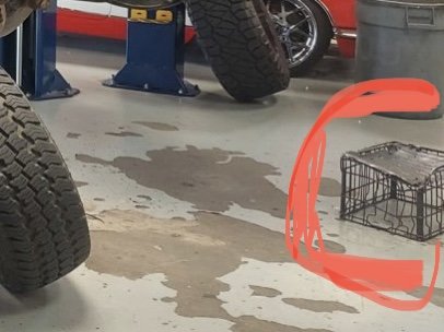

    Back in my (very poor & dumb) youth I did use a pair of those ancient metal milk crates as jack stands, surprisingly strong... :anonymous:

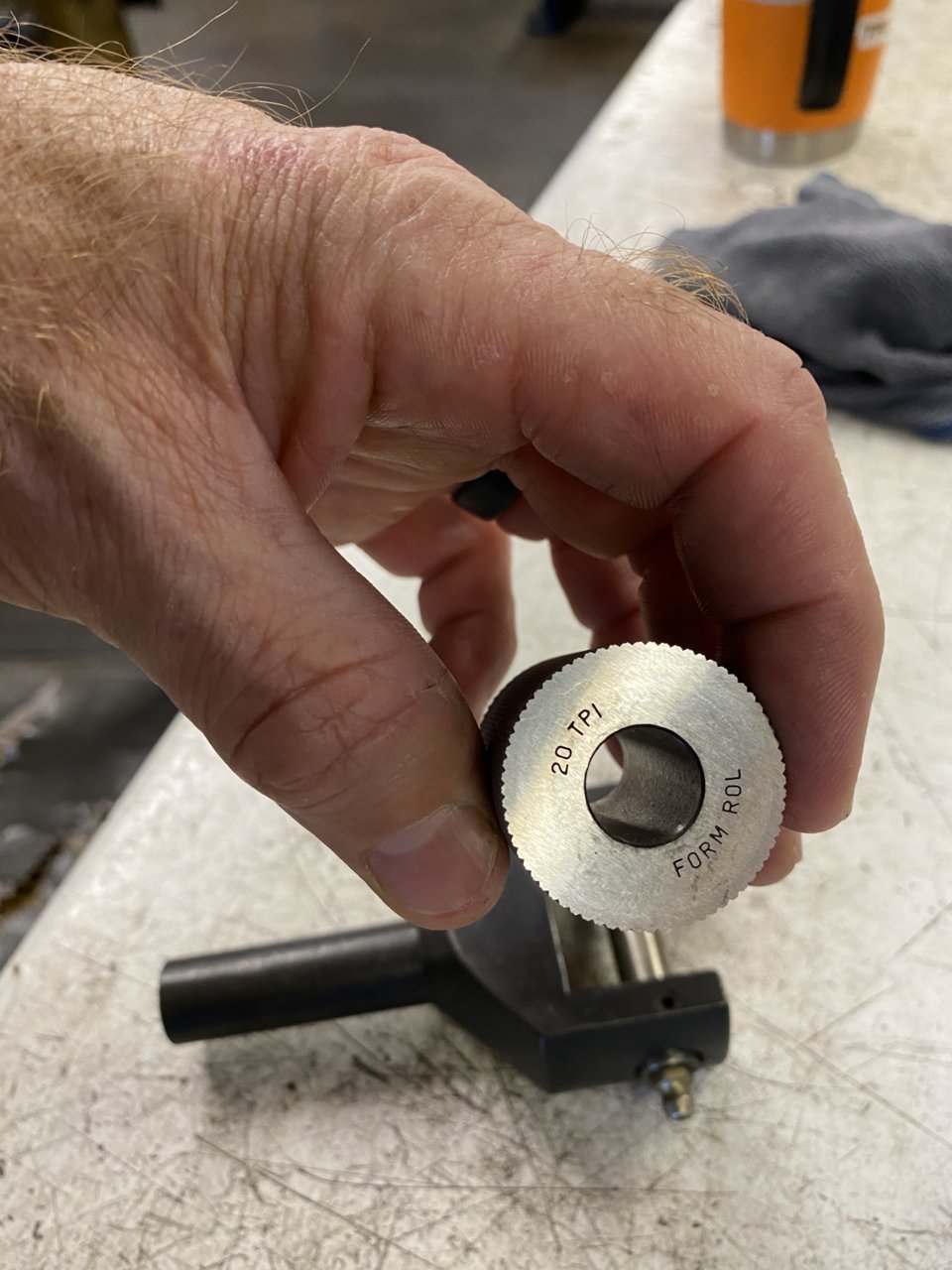

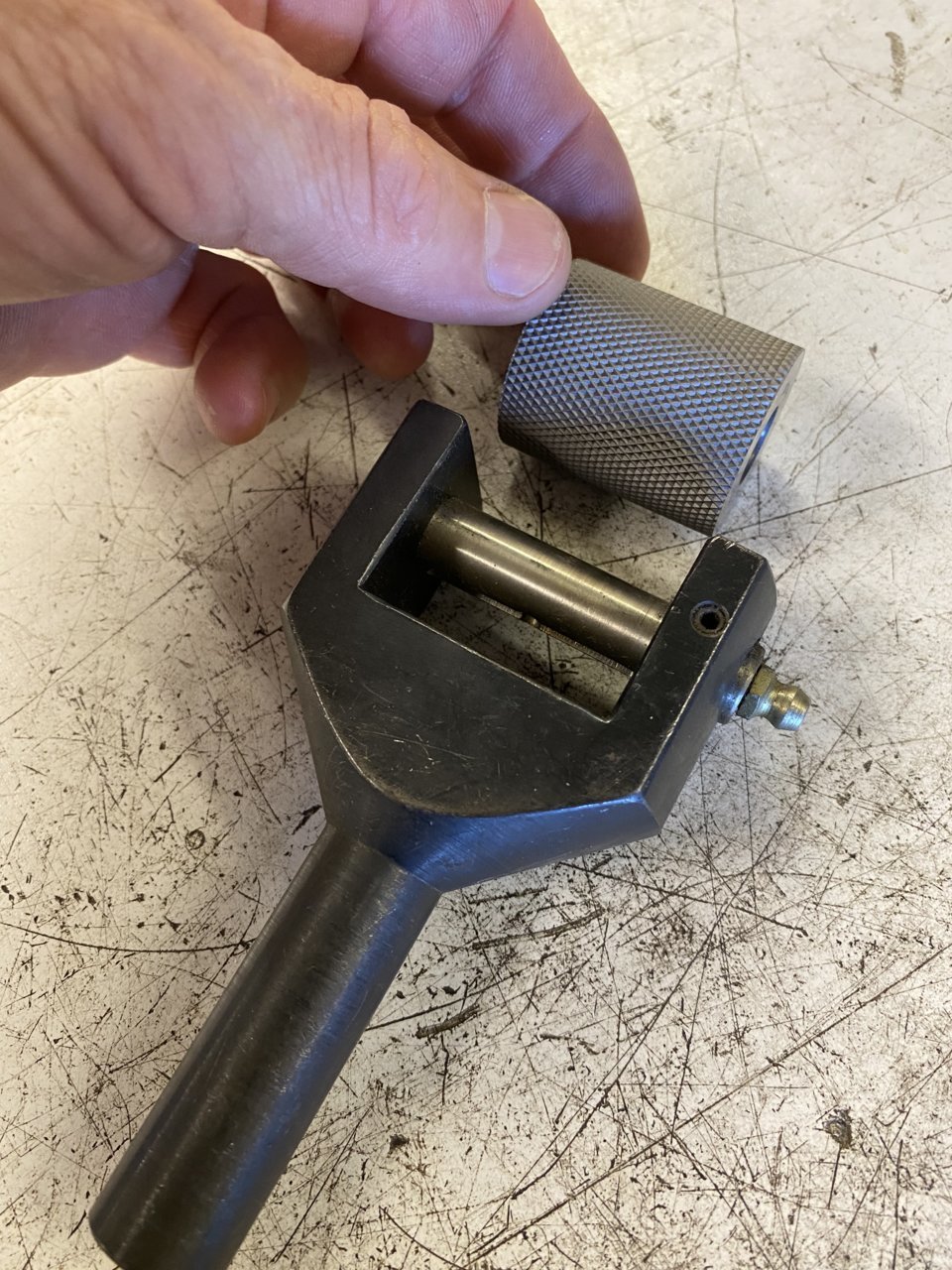

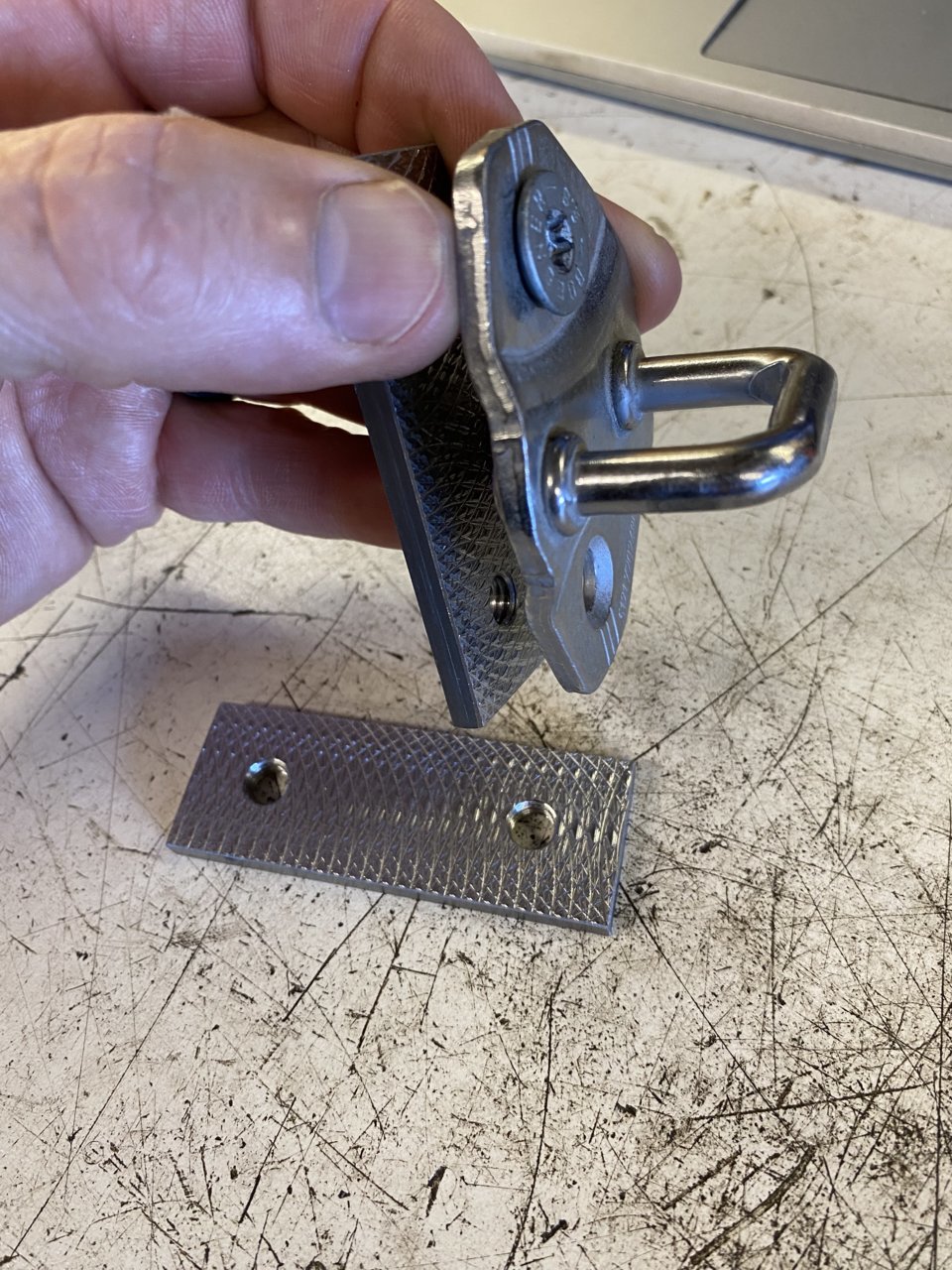

    Customer just came in with an odd request......knurl a flat surface on steel. They actually call it checkering from what I found. Boss sent me a video of a guy using a cutter with all the inserts removed but 1 with fast travel.
    Challenge accepted.
    I made this 20ish years ago and tried it in the mill on a piece of brass, it did not work.

    You need a shaper!

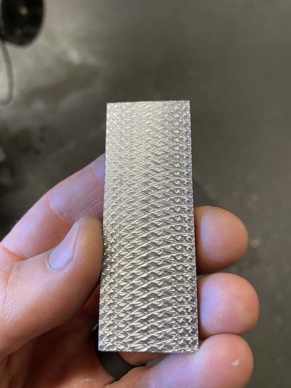

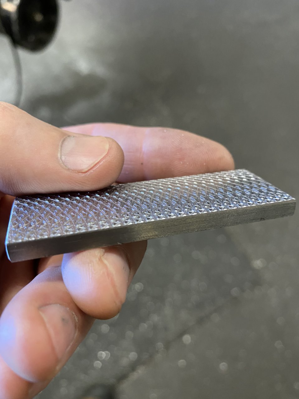

    Flat knurl went good. Ground a carbide insert to a point and ran it 400 rpm, 40 ipm, .015” deep. Went over it three times with a 1/2” offset each time.
    It’s a backing plate for a door striker, it’ll never be seen.

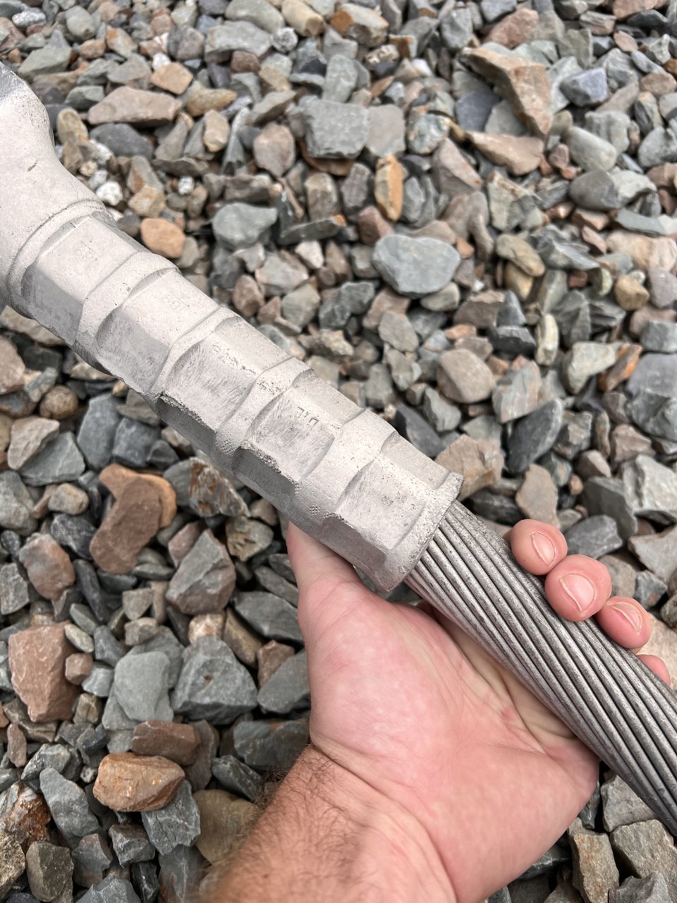

    Here’s one of the leads from those oil breakers. Little big for terminating receptacles!9699E1B8-5E18-4E8C-BDC7-A7BF4FC00641.jpg

    Pretty friggin' expensive backing plate!
