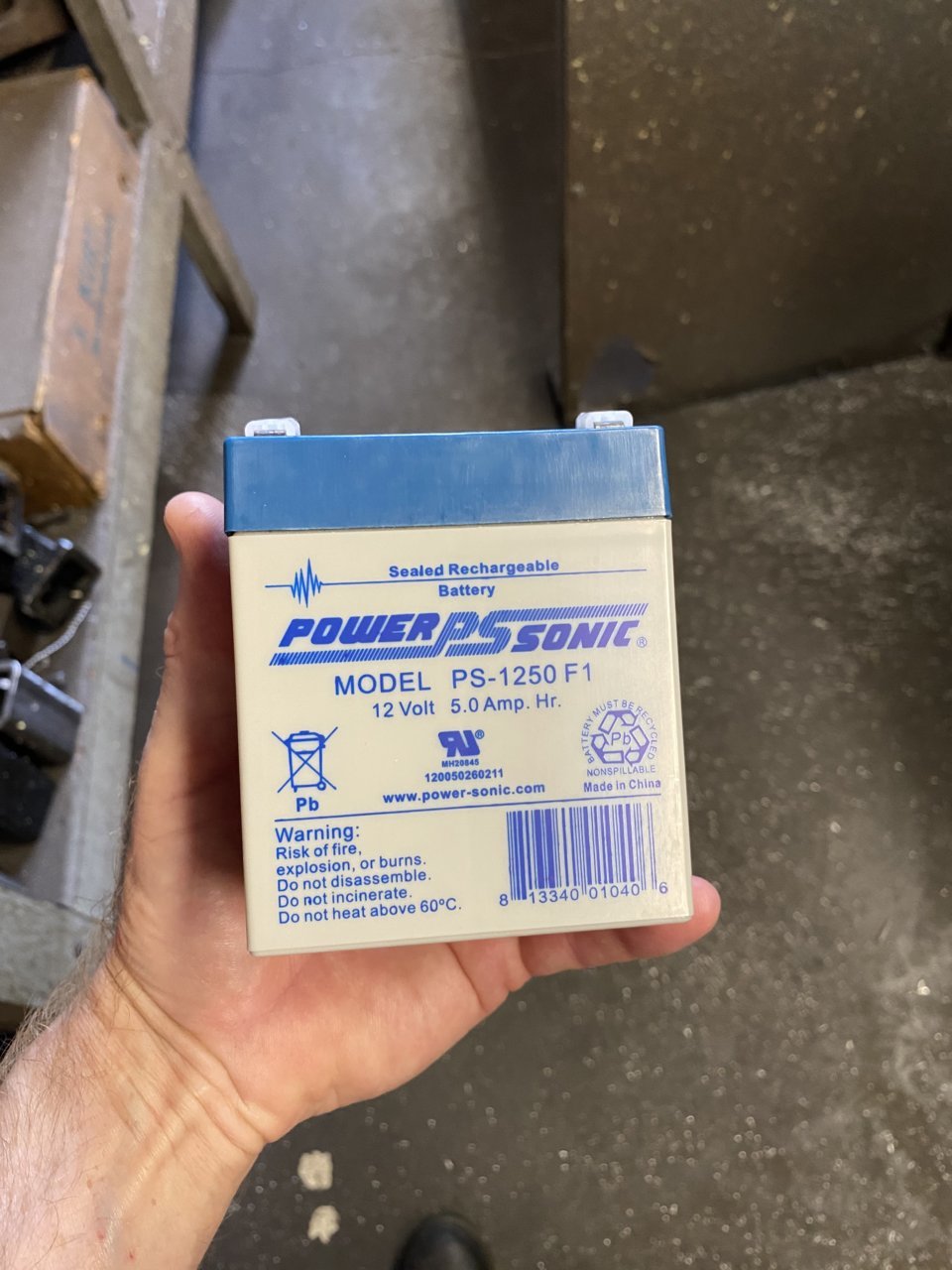

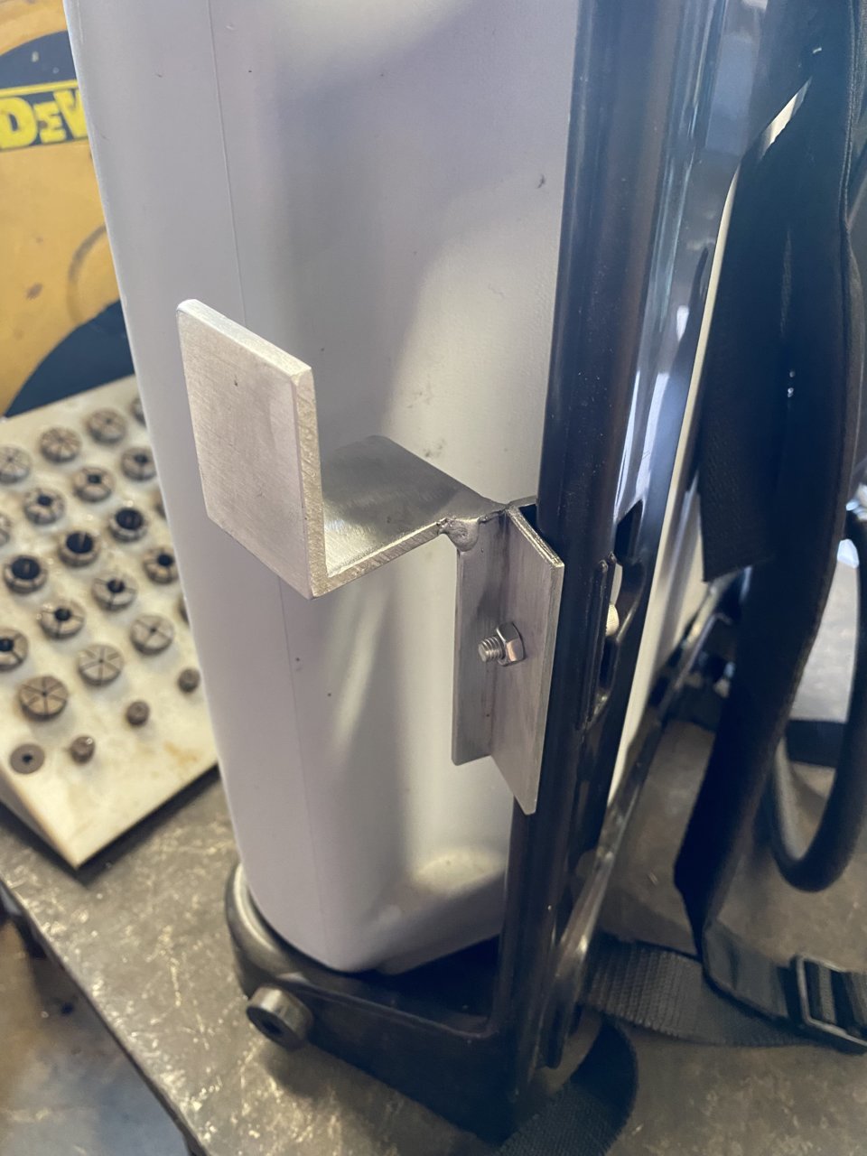

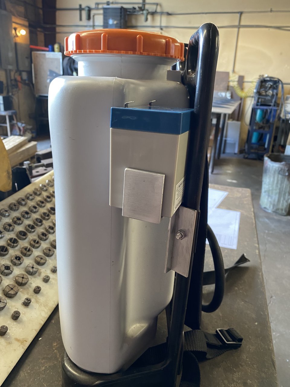

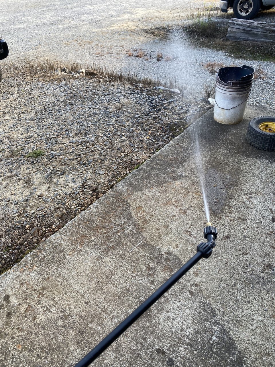

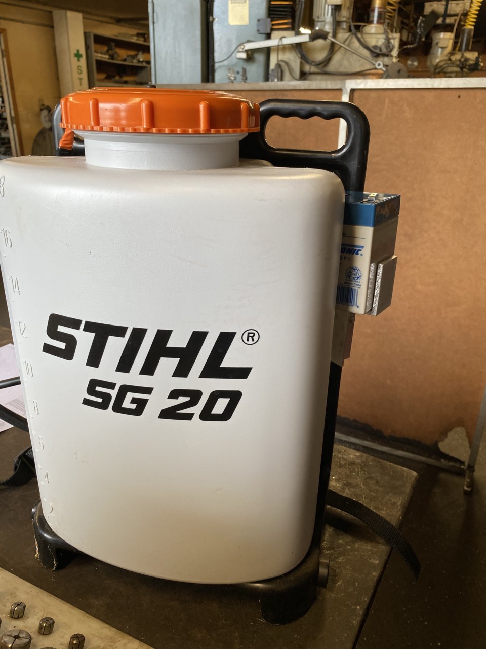

    Adapt and overcome. $18.95 and we’re spraying :bananadance:

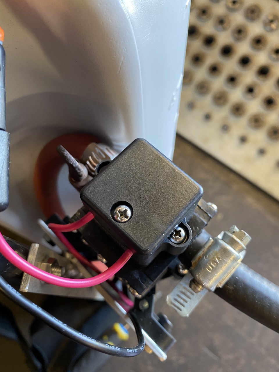

    Does anybody know if you can reduce the pressure on these cheap pumps? This one is set on 60psi.

    You could put a T in the output side returning to the tank and use a valve to adjust the amount of return.
  5. Sep 20, 2022 at 6:35 AM
    RustyGreen
    Aug 12, 2020
    #337468
    14,603
    sleeping in a chair
    2017 AC 4x4 Sport 6M Inferno
    Pavement Princess
    Probably want a needle valve for more accuracy over a standard ball valve.

    6 volt battery? :anonymous:

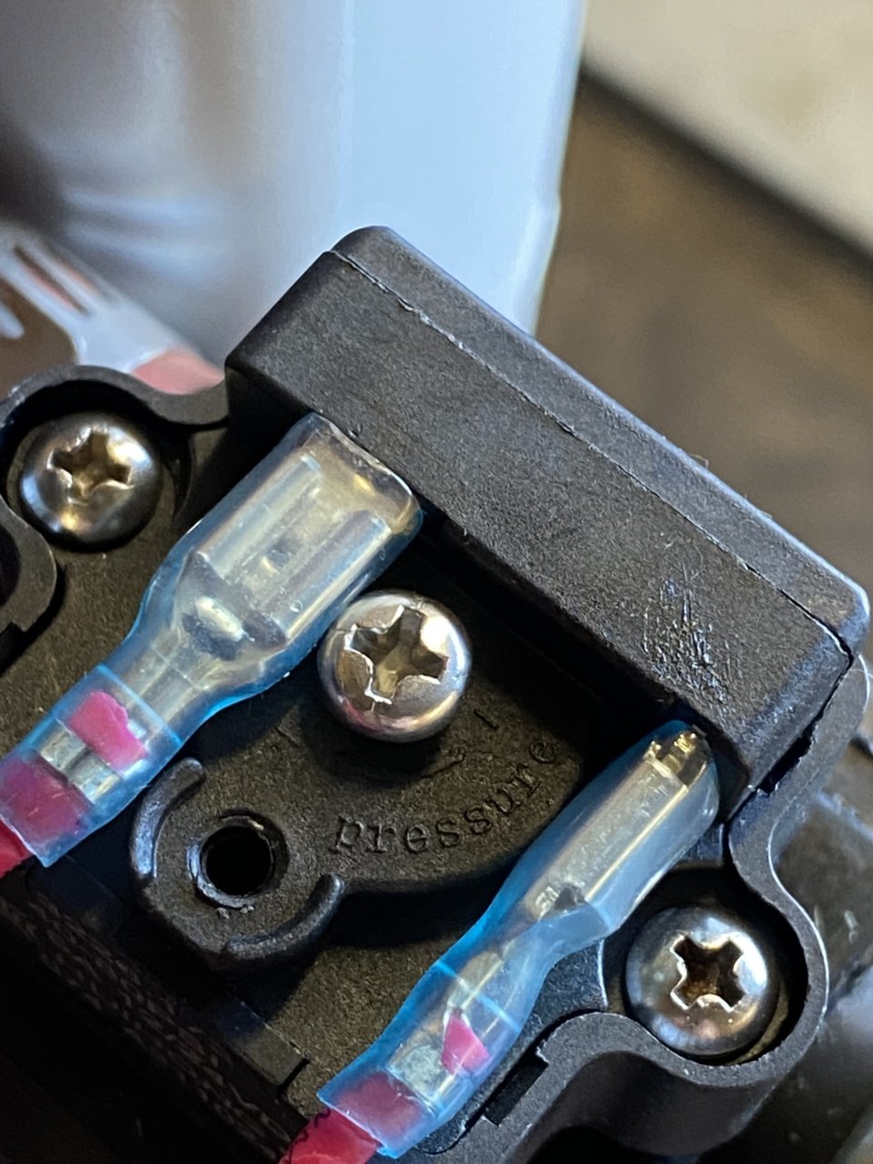

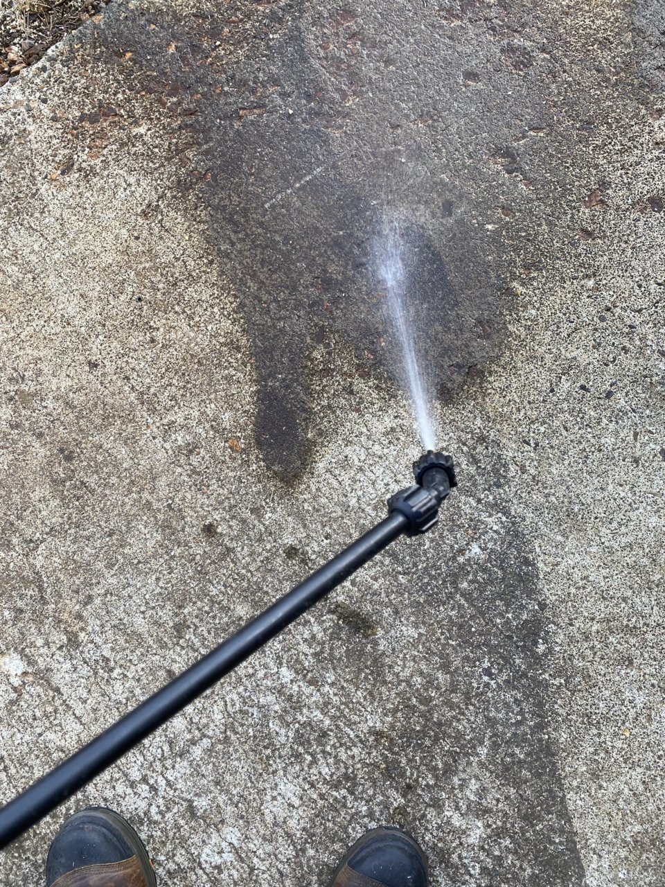

    Did a search and found there’s a pressure screw under the cover. Unfortunately it doesn’t slow the volume. I may have to put a 1/4 turn valve in the line to slow the volume down.

    Last post in that forum, maybe make a restrictor?
