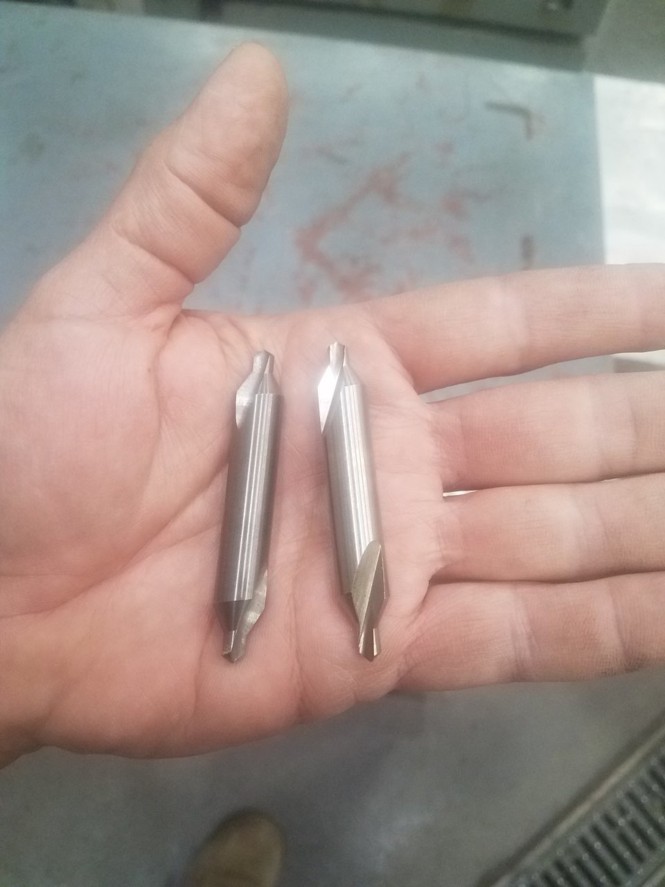

    Hand drilling. Someday I'll get a drill press.
    I'm using a piece of 1" foam insulation as a backer currently. I had the bit chucked in as far as it would go, so only maybe 1/4" was out of the chuck. I'm not sure what I'd gain from a center drill. Other than probably better quality than my HF drill index that I'm currently using. Are center drills ground at a different angle?

    Not different angle just shorter and made for a pilot hole. These I'll post a picture of are much larger than what you would need. Also they make stub length or screw machine length drill bits that are shorter, a little more stout. I think you may be better off hanging that drill bit out and not on the flute's of the bit, easier breaking I would think, less flex.20201228_065842.jpg

    I've used center drills in the past when I had access to a machine shop. Just didn't know if they were ground at a different angle than standard drill bits. Just ordered a handful of short 118° #48 drill bits.
