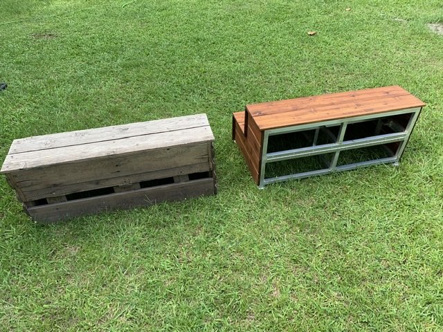

    That’s awesome, I need to make some aluminum steps for our camper now :facepalm:

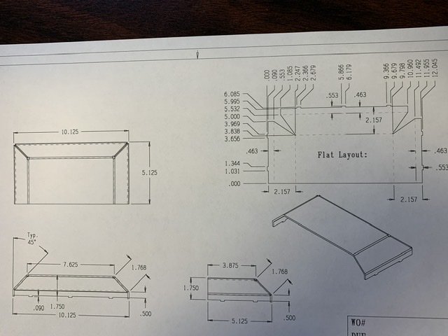

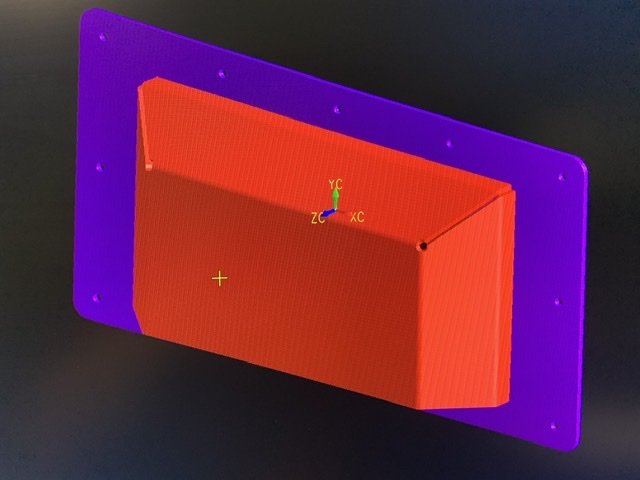

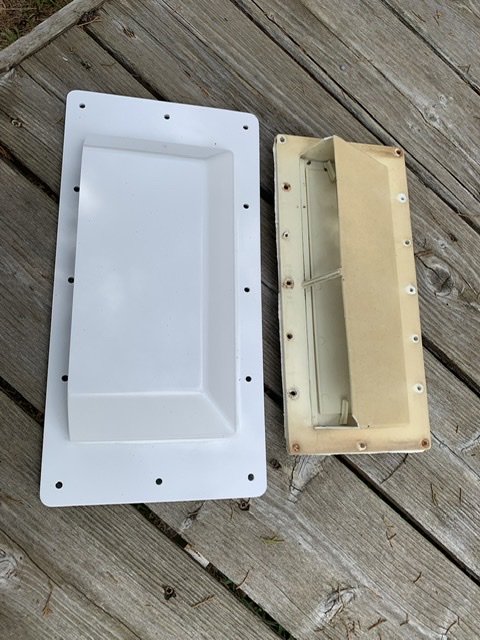

    A while back I got sick of replacing the cheap plastic vents on this camper only do it again a few years later, so I made some from .090” aluminum.
    I made a trim bezel for the back and sandwiched a piece of aluminum screen behind it to keep the nesting critters out!

    That looks great! Is it one piece or welded together?
    I had to make the inside flap for ours, we had a thin piece of stainless here at the shop :thumbsup:

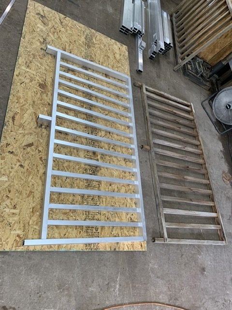

    Railing came out great!

    It’s a back plate and a formed cap for the vent, I used a tab and slot location to get the position perfect and it also allowed for some plug welds in the back of the plate.
    I also made an upper and lower refrigerator vent system like this as well and added a muffin fan at the top on a thermostat to vent the hot air from the back of the cabinet.

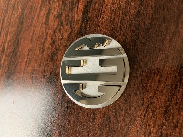

    Just cut this steering wheel initial emblem out for the center of my son’s go kart. Had to add a personal tough to it! The plan is to epoxy the loose pieces in the thin base disc while in the recessed center hub. I know, he has the coolest initials, CCR!

    Looks cool :thumbsup: What did you cut it with, laser? Water jet?

    4,000 watt Co2 laser. The bottom disc is 22 ga. and the letters are 11ga. I might end up remaking the letters thinner to make them less of a sharp hazard.
