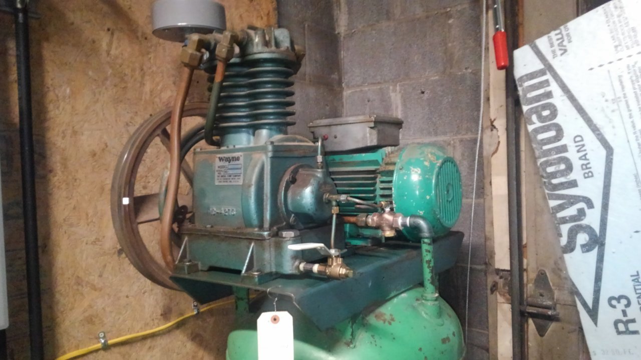

    Agree!
    My old 1960 Wayne chugs along quietly at 378 rpm, you can have a conversation standing by it.

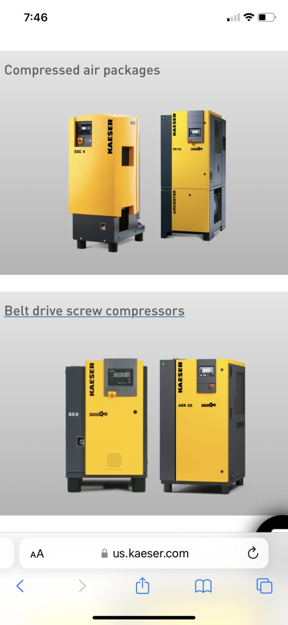

    If I had the money I’d get one of these rotary screws compressors.

    Small rotary compressors are a double edged sword. For something like a busy body shop that genuinely needs the volume they can be a good choice.
    If the volume isn't really required however the maintenance & utility costs are much higher than a reciprocating unit.

    Rotory screw units are really not beneficial to a single person shop.
    They have little storage capacity and adding a second receiver (tank) makes no sense. They are designed to run constant. They unload when no one is using air, so the motor spins doing no work. I'm not paying to run a 7 HP motor making no air. If you hook it to a regulator, you are paying more for the "inrush voltage" to start the motor. Again, more $.
    Reciprocal, low rpm, 2 stage units tick all the boxes.

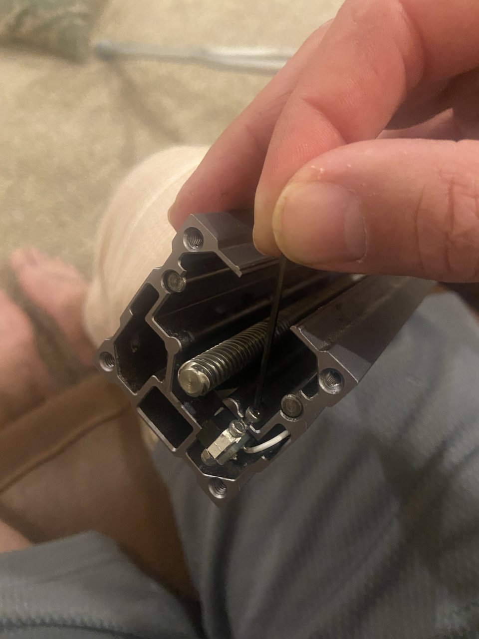

    I guess while I’m in recovery mode I can work on small stuff. Need to replace this broken limit switch.
