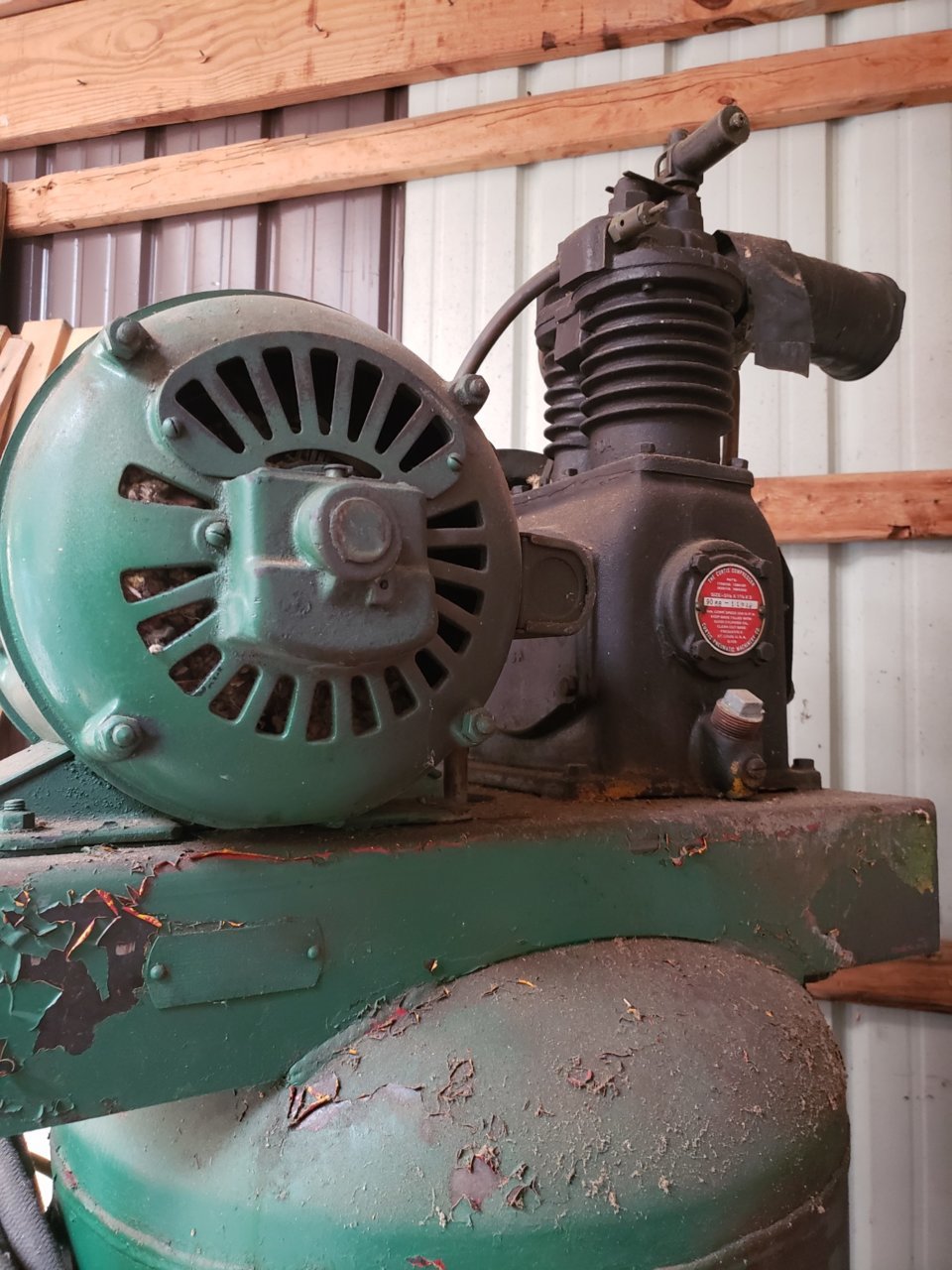

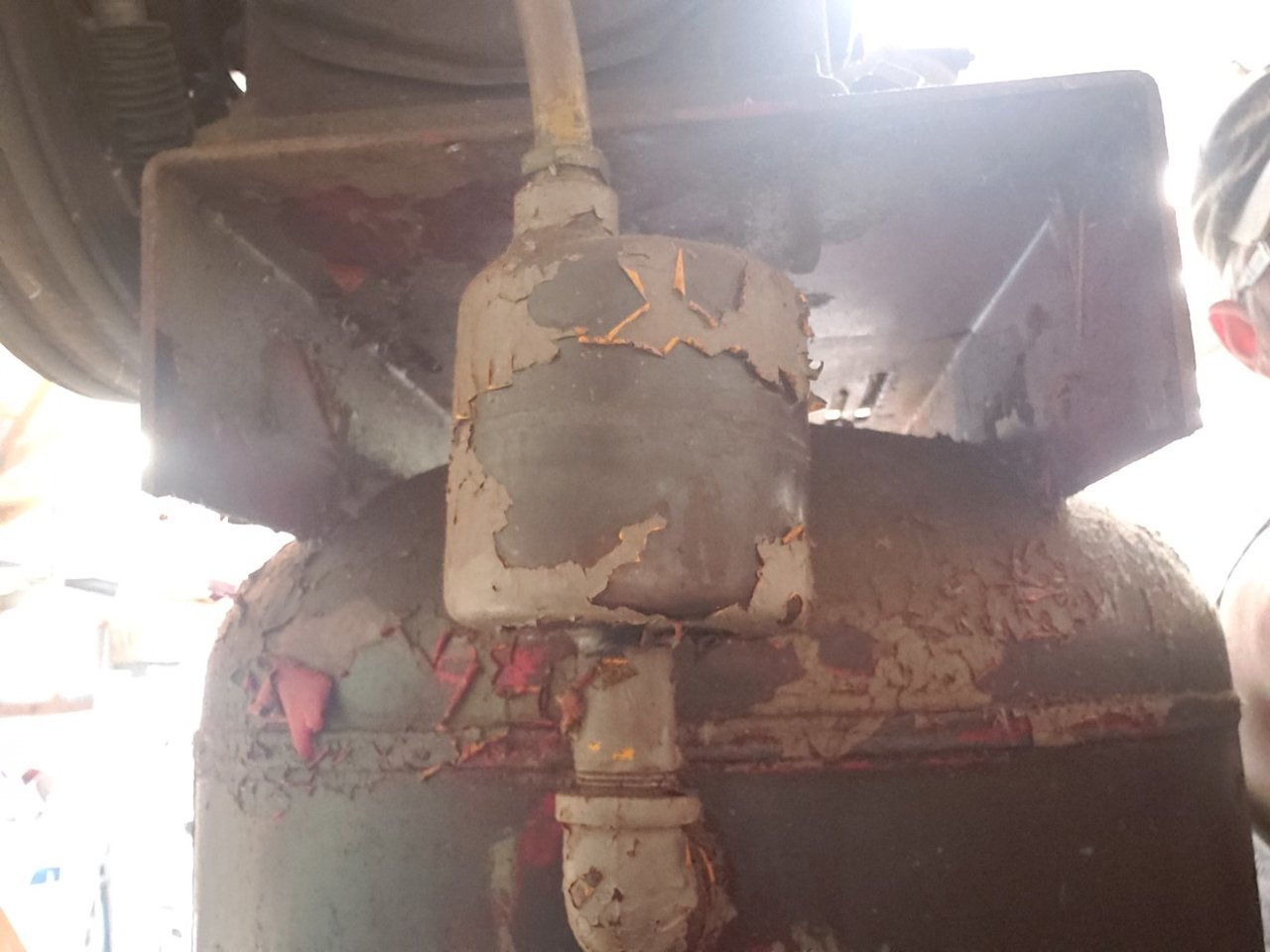

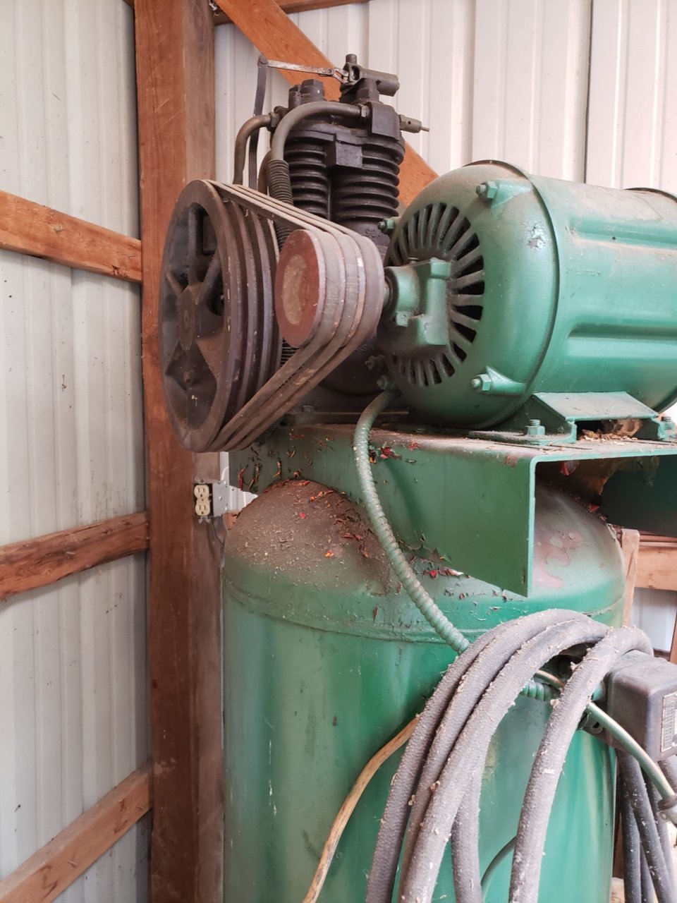

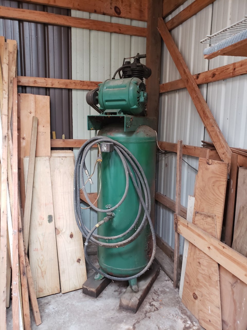

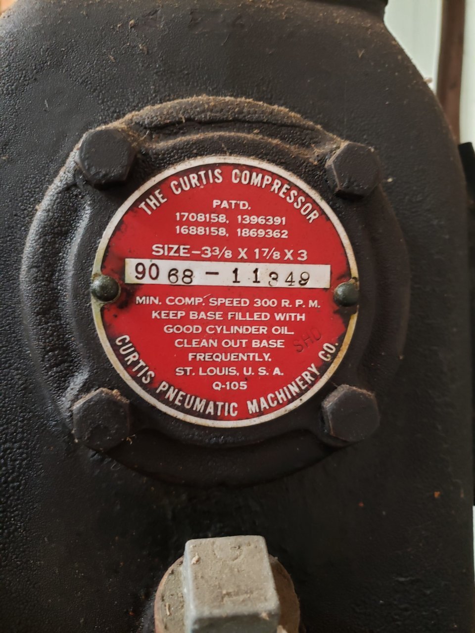

    Looking for some insight on who/where this would find it's best use. Looking to sell it eventually, it runs, but has a leak somewhere keeping it from holding a full tank over 24 hours. Thinking it is a valve as opposed to tank damage. Just wanting feed back on this type and model. Thanks.

    That is a Rolls Royce class machine!
    It is a 2 stage machine good for 175 psi, the 3 belt drive makes me suspect it is a 3-5 hp unit good for about 15 - 18 scfm.
    Curtis has been making that pump since 1897 (not a typo), their top of the range, they appropriately call it "The Masterline".
    That one has the old style flywheel head unloader, I have a 1944 unit with the same. Later units don't use that but I don't know what year the change was made.
    The date of manufacture might be on the tag on the base under the motor, if there is a tag welded to the tank it will be there too.
    With reasonable care that is about as close to a lifetime machine as possible.
    There are just a few equals but no finer machines built.

    If memory serves me correctly they used the head valves as the tank check, the small tank item in the photo is just a muffler I believe.
    If the tank checks out well the easiest way to keep the pressure is to put an in line check valve in the line between the pump and tank.
    McMaster - Carr can provide for a reasonable cost.
    Edit: And a new quality air filter assembly too.

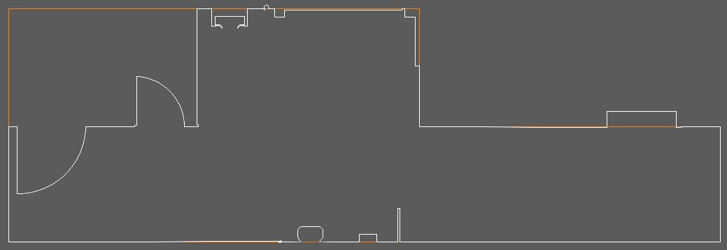

    Admittedly, even after using AutoCAD for 25 years, I was not aware of that particular command so while I was testing it out, I was thinking "if this :censored: works, 1) I'm going to be pissed but 2) holy crap that would be nice".
    No dice, at least not with the bathroom I used as a guinea pig:
    The white polyline is using the boundary command, the orange is what I need it to be.
    Appreciate the suggestion, though!

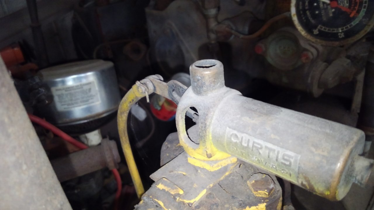

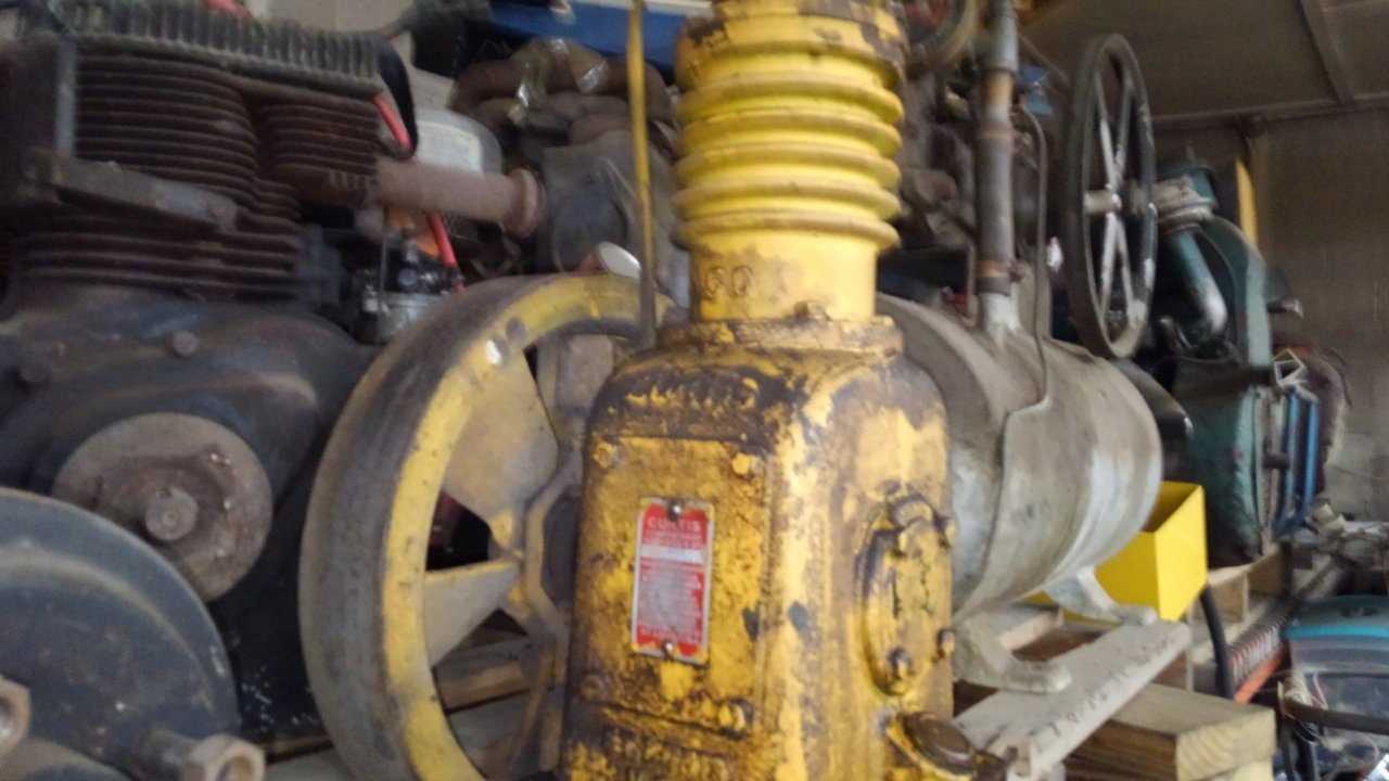

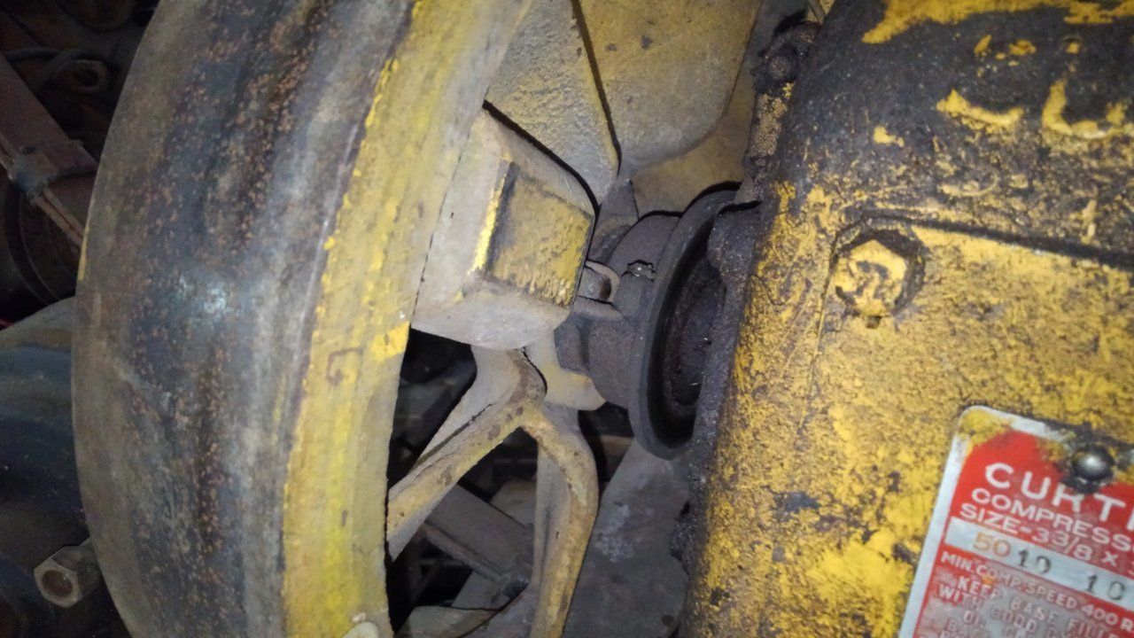

    Pretty awful photo, I was standing on a snowblower...
    This is the single cylinder Curtis compressor in the same family.
    This is the oldest unit I have in the archives, dating back to the 1920s iirc.
    Here is a close up view of the flyweight centrifugal unloader, note that this machine is old enough to have a flat belt drive instead of a conventional v belt. The pulley isn't actually flat, it has a crown to assist the belt in staying aligned.
    This is the other half of the unloader, the flyweights move a linkage to this, it holds the valve open until the pump comes up to speed.

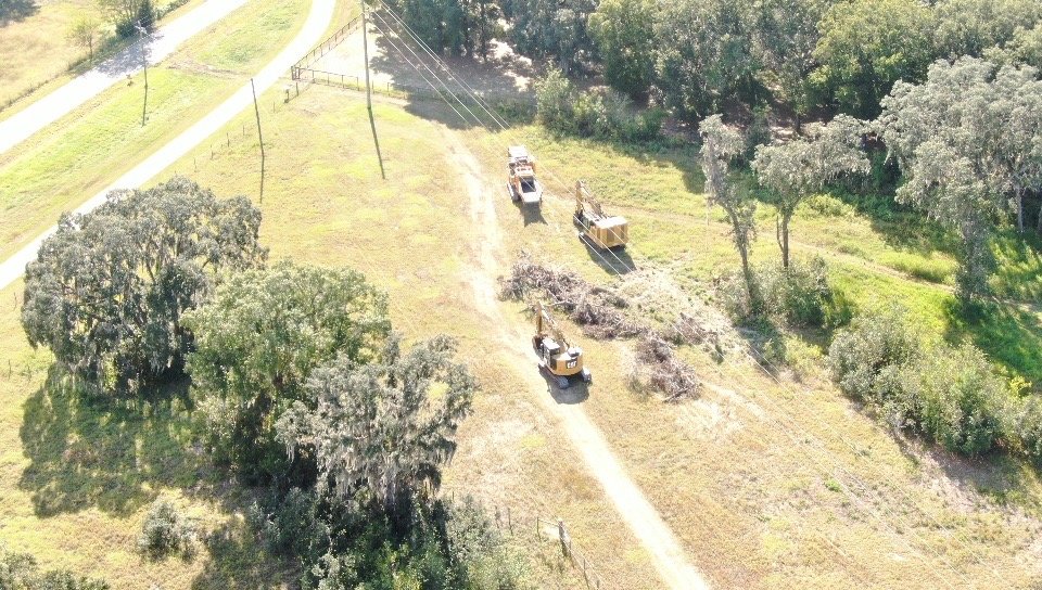

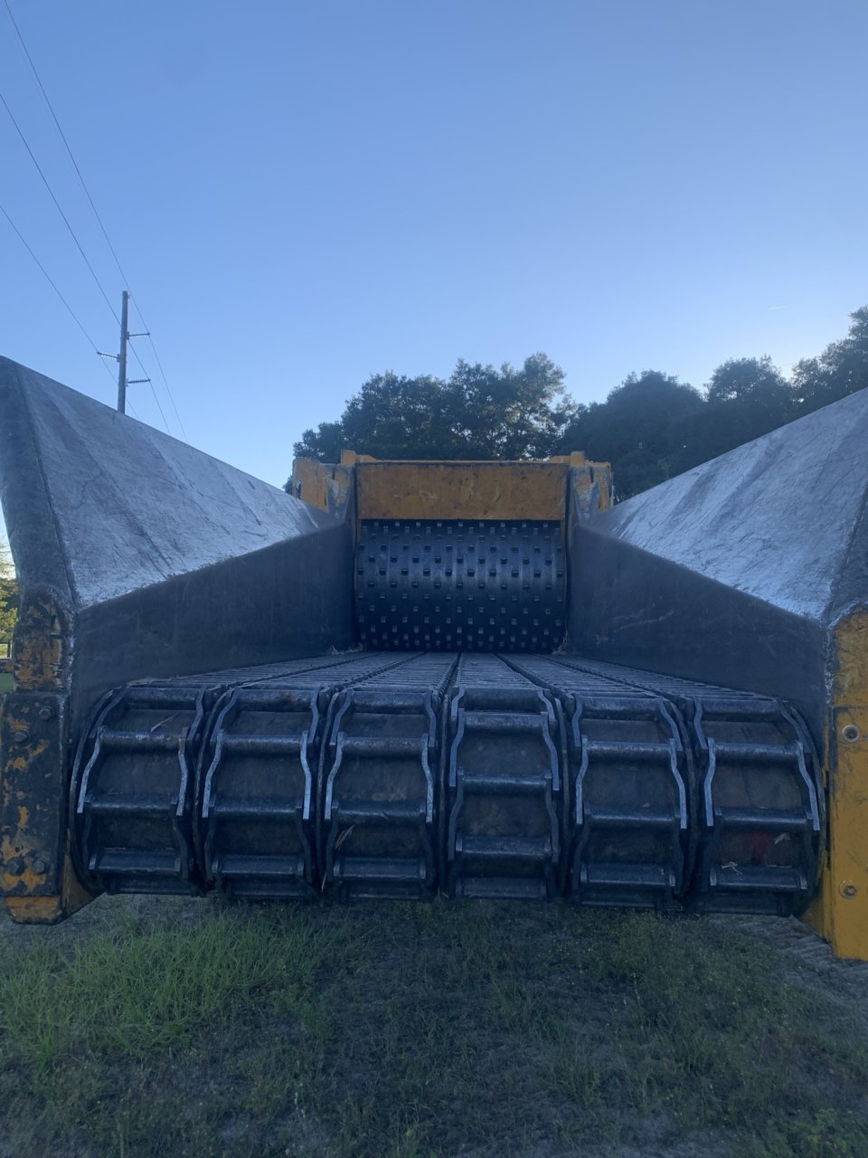

    Got these guys clearing my power easement , of course it’s 3 days before hunting season

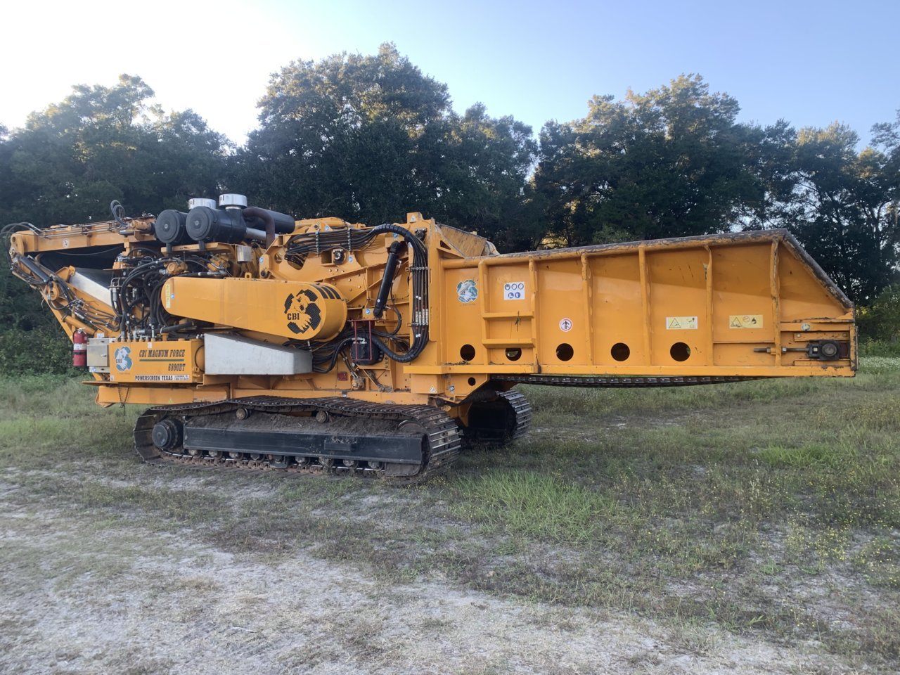

    One heck of a chipper

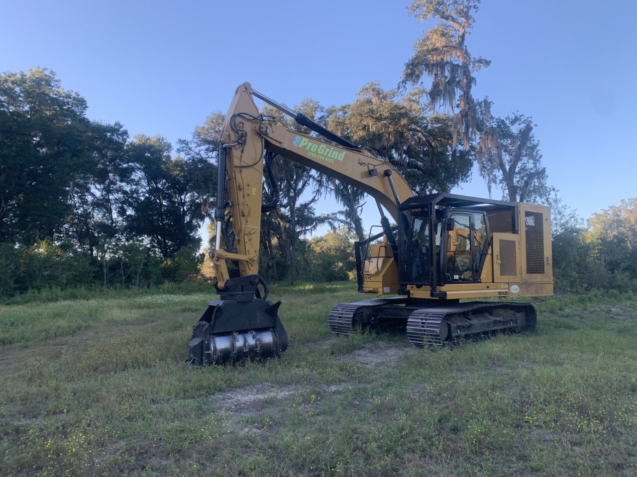

    D00B9392-6EFB-418C-9AA3-36EB5E30D248.jpg Had to do a over head
