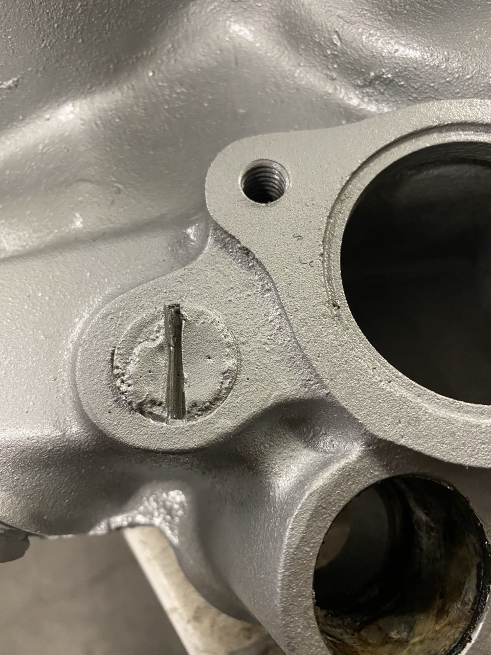

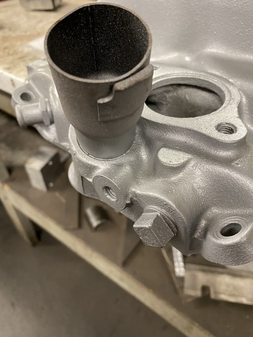

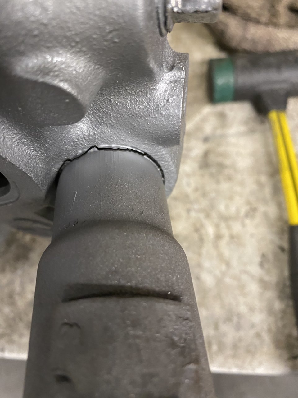

    Where’s the GM folks this morning, guy wants this tube out of this aluminum intake. Is it pressed in or threaded? I’m guessing pressed.

    Pressed, just tap it gently side to side with a soft face hammer and it should loosen up.

    Did...he spray paint the whole thing? Threads and all?

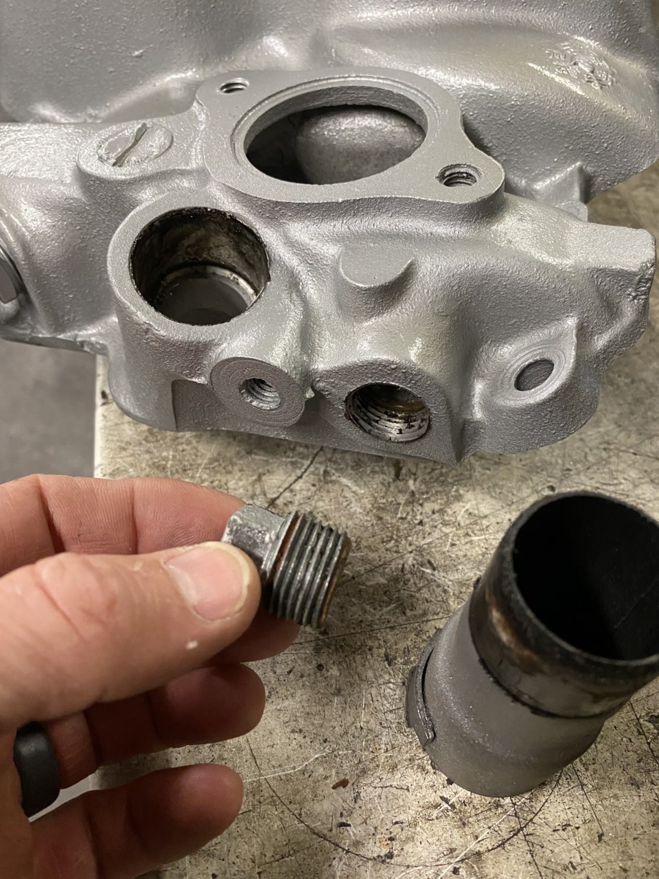

    The guy did paint it, afraid I'm gonna mess it up getting the tube and a couple plugs out.

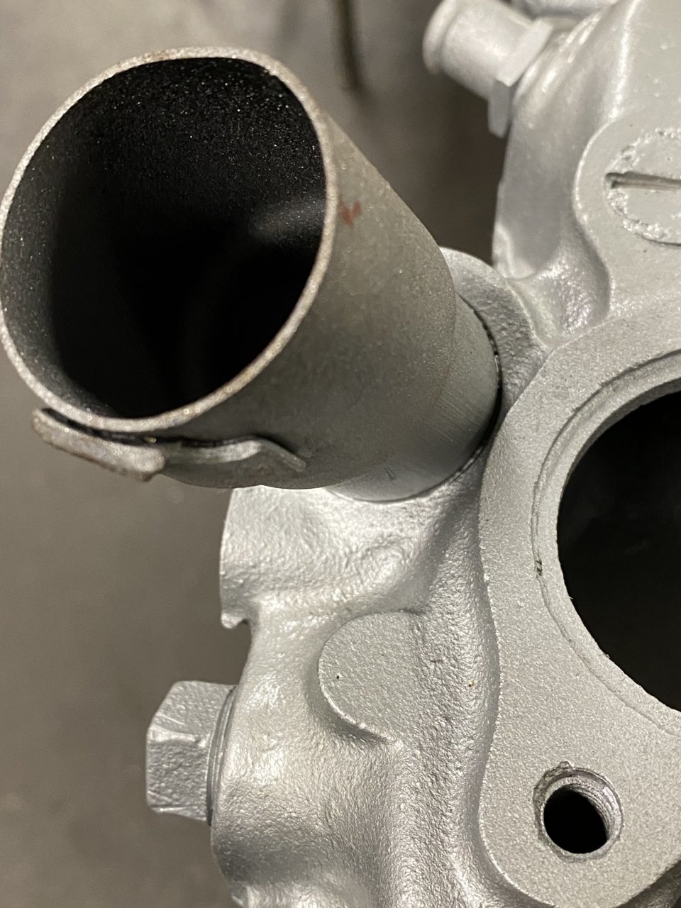

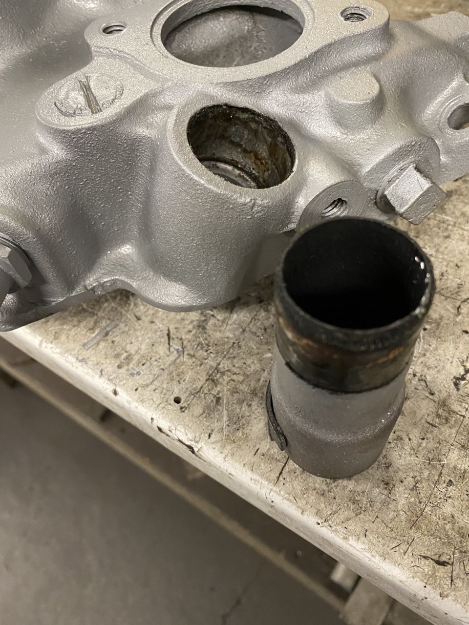

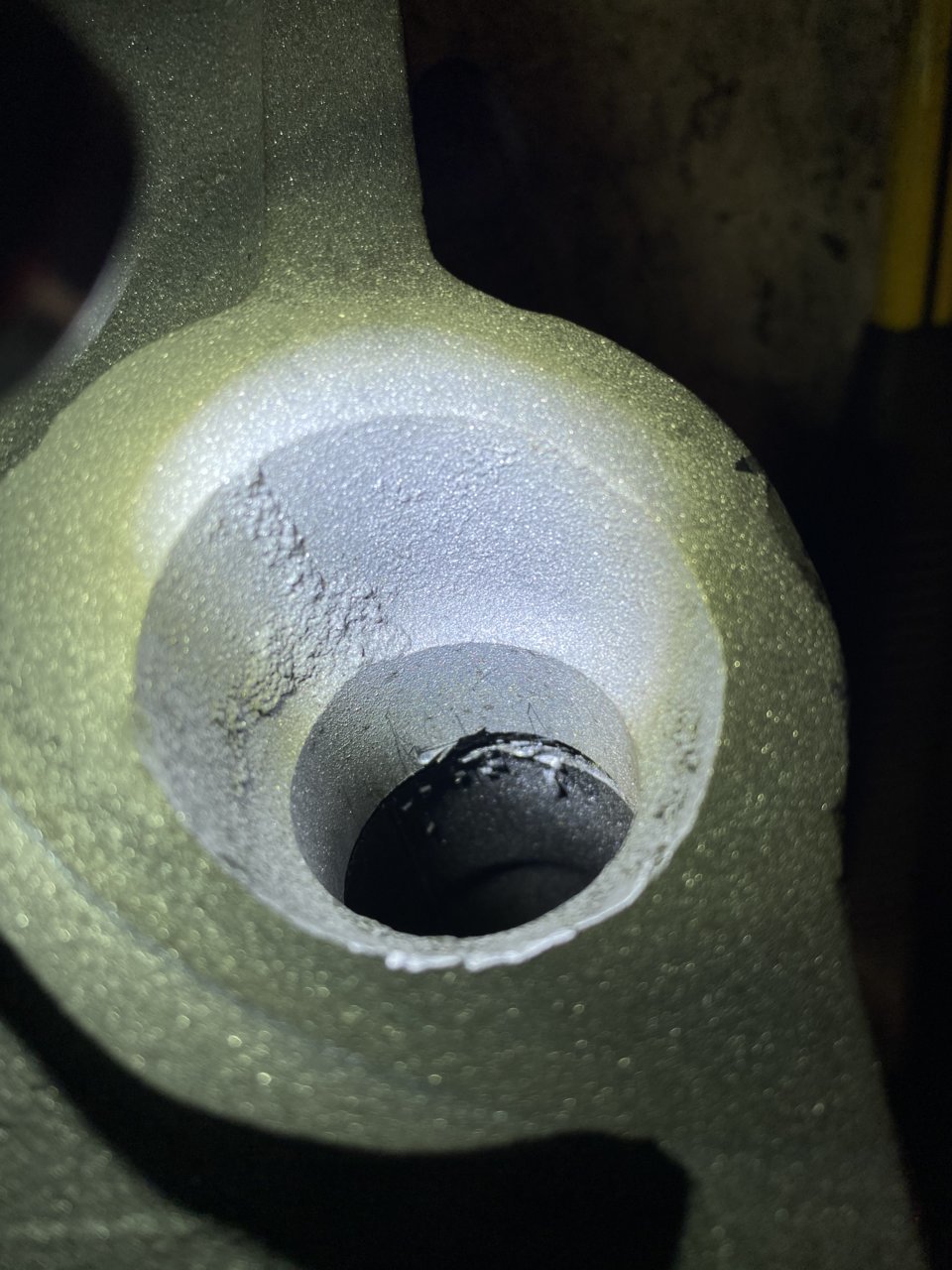

    Thanks @RustyGreen gave it a few taps and it came right out.
    Noticed the customer tried from the inside.
    This thing is older than I thought.

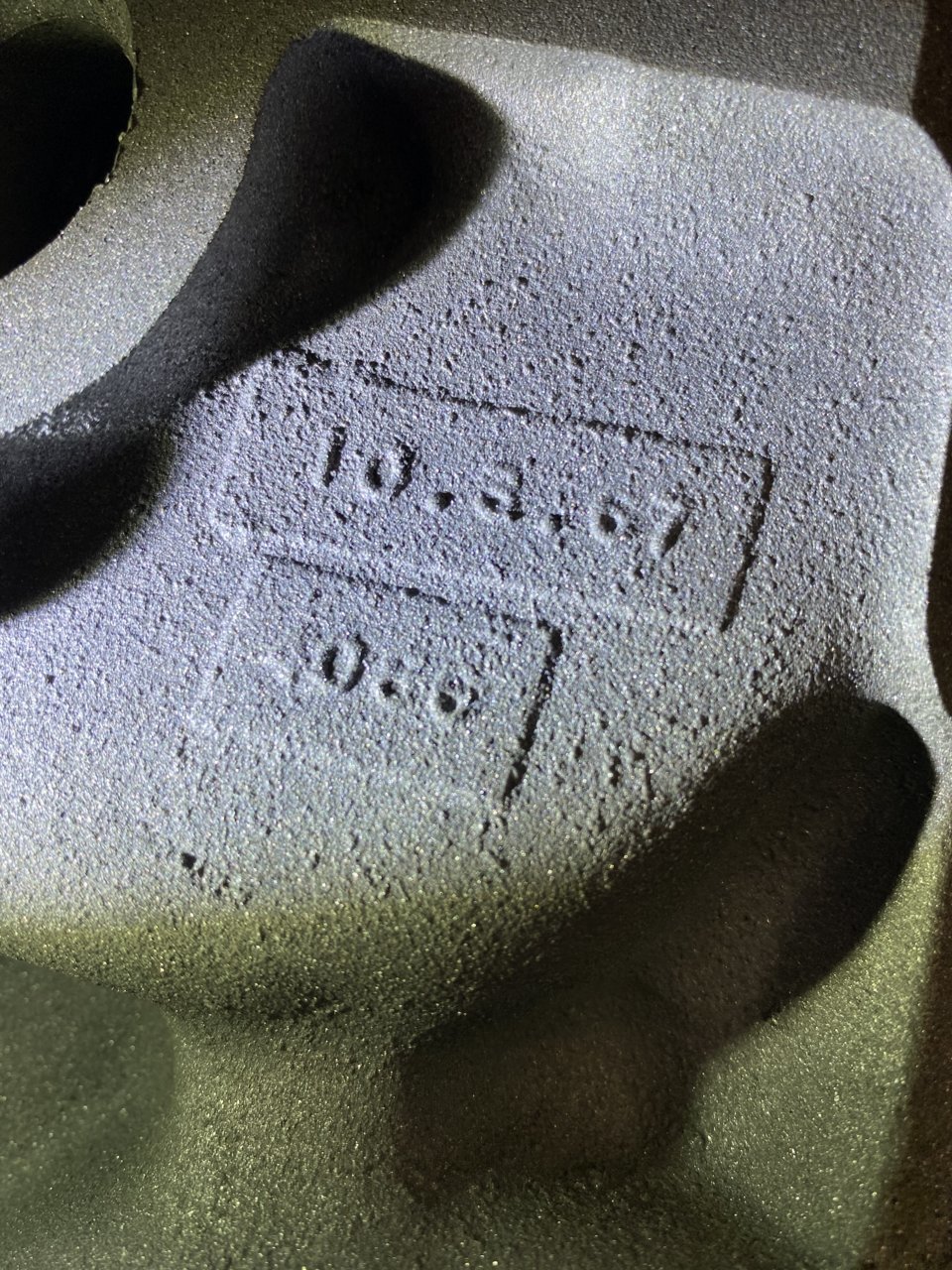

    2 down, 1 to go.
