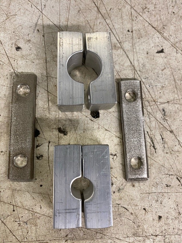

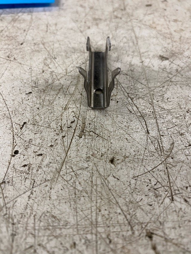

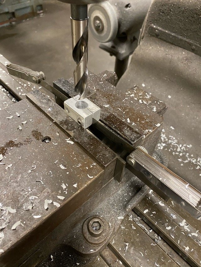

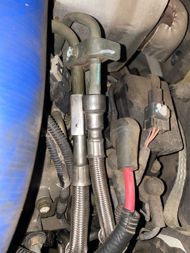

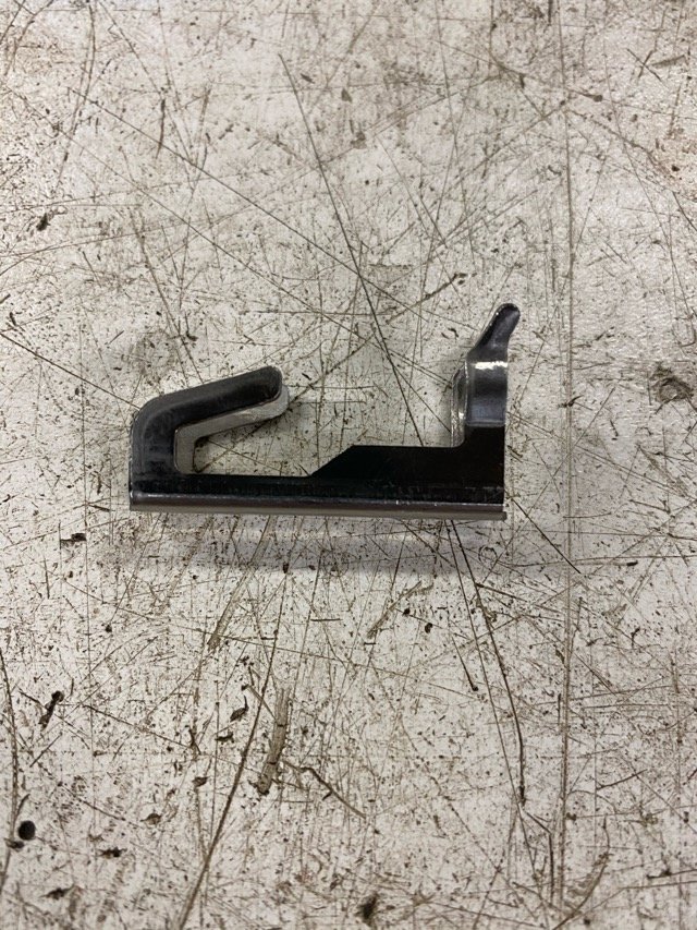

    Put those new fuel lines on the Duramax last week and the return line at the engine is supposed to have this locking clip on the quick connect. The supply one fit good. This return one won’t fit on the new line, time to get creative.

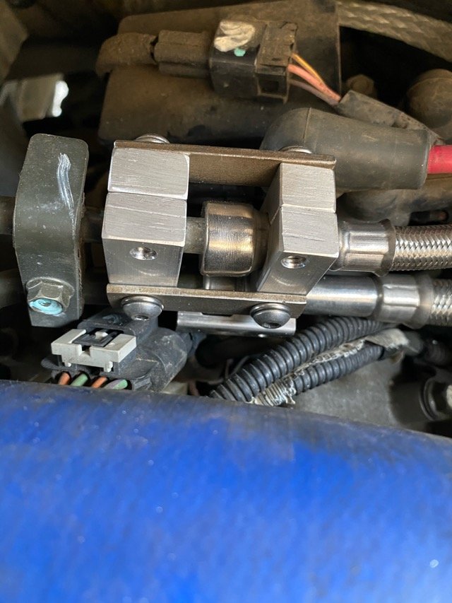

    It’s a little beefy but it works. I used .010” feeler gauges to give me a little tightness. I feel better about it not coming off now and spraying fuel everywhere without me knowing it.
    A friend put an LS2 in an S-10 and he wanted me to drive it, we rode around the block and I pulled in his driveway and his fuel line came off at the engine. Luckily it didn’t catch on fire :eek:
