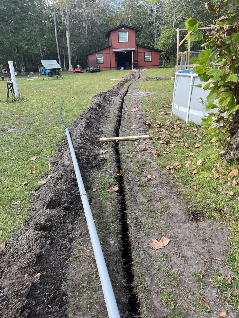

    I ran shielded Cat5, I buried the service cable at 18”+ then partially filled the trench and laid the shielded Cat5 in conduit at about 10” deep to help avoid any interference from the high voltage as well.
    The good thing is, the data in conduit is easy to chase if I need to switch it out at a later time.
    Thanks for the input!

    When I built my garage I ran a trench as well with 2 conduits and ran a sting inside them... that way when things changed I could pull other things through.. initially I ran a coax and a phone line, but when those things became obsolete I pulled them and used the string to re pull a CAT 6 and another string. Who knows what the future holds.

    I decided to not pull a 2nd mortgage on my house for copper, went with aluminum at 1/0, 1/0, 1/0, 4. Running a 60A sub. The previous service out here was 12/3 direct burial that decided to give up the ghost about this time last year.

    I ran aluminum to my building as well, been good for 10+ years :thumbsup:

    In addition to more capacity everything should run better, you had some voltage drop with that long of a run of #12.

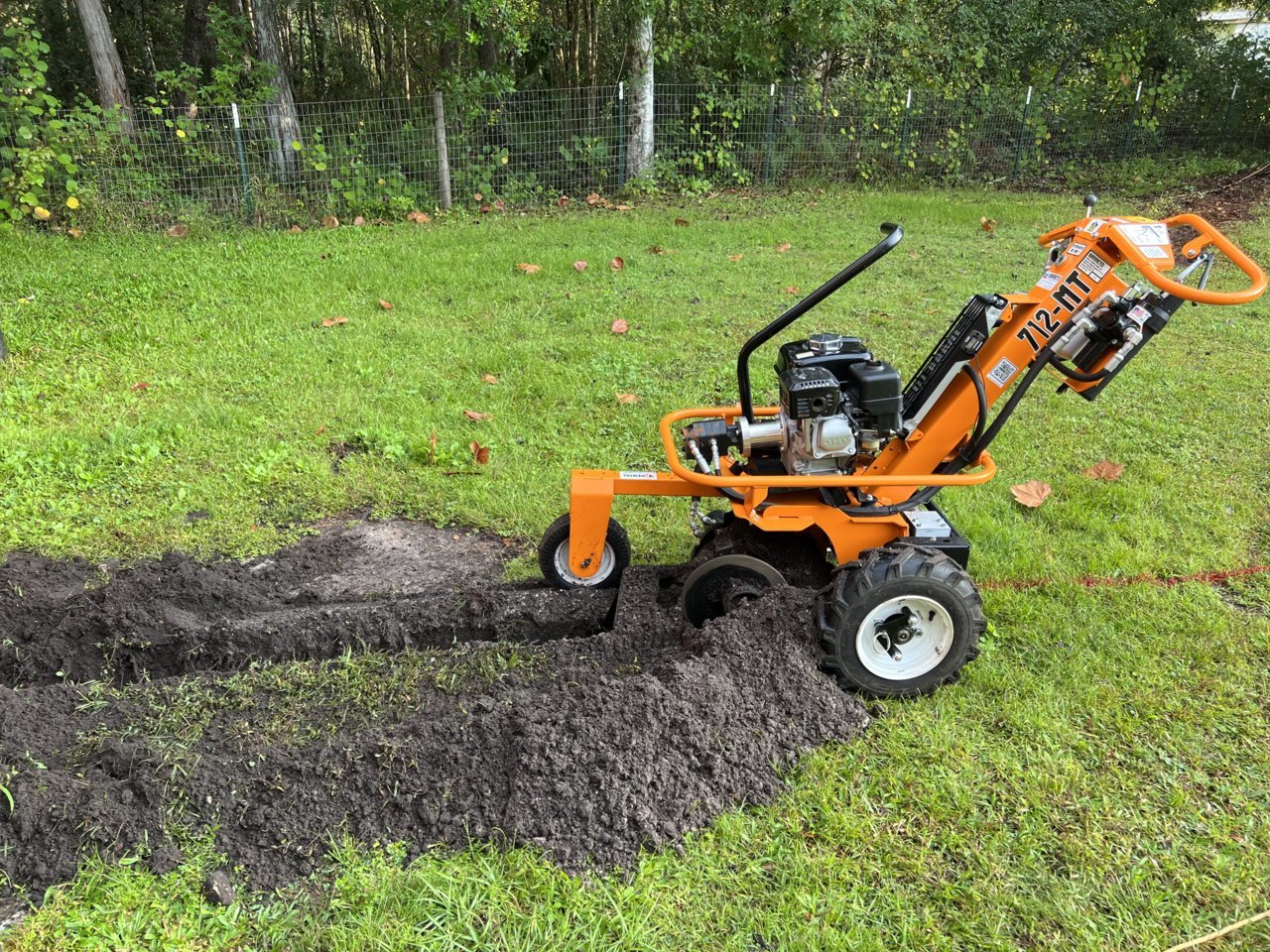

    No way did I hand trench that, did need to do some delicate areas by hand, but I rented a trencher from Home Depot for $200 for the day. Well worth it!
    The machine I was issued had 4 hours on it, it was sweet!

    The one i used last year was a bigger version but those trenchers are awesome!

    I was glad I opted for the hydraulic Drive version. I almost went with the larger version, but it was quite a jump in rental cost.
