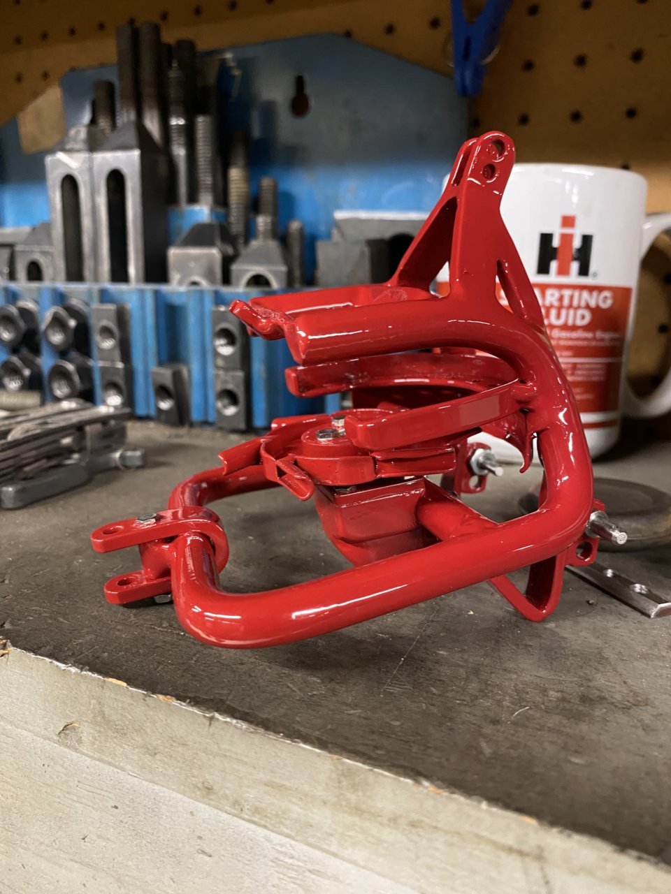

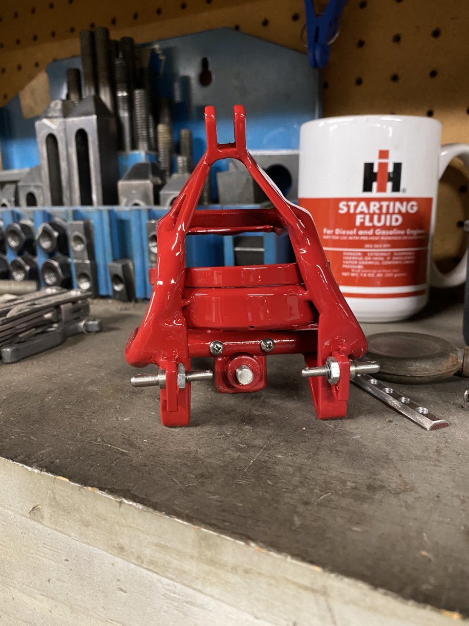

    Whatchew mean wet paint :anonymous:

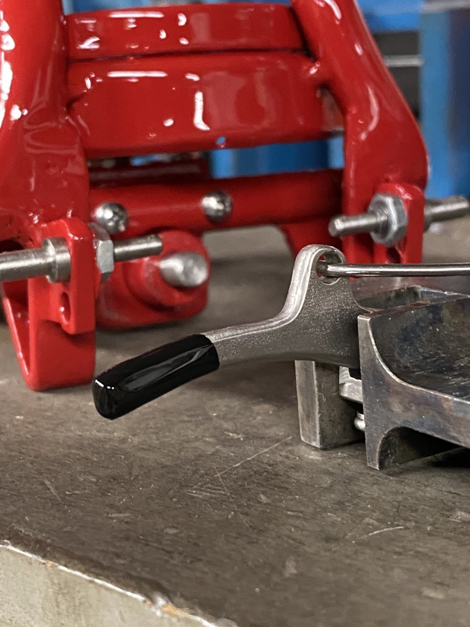

    Found a small can of black paint from the 20th century and finally found some moistness about 3/8” deep to make the handle look like it has a grip.

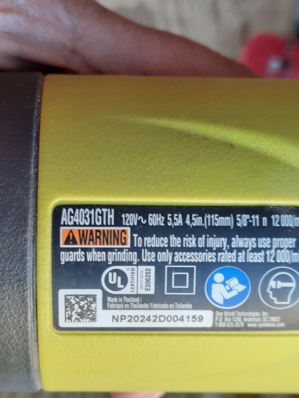

    I guess they dont want you fixing these grinders. Cant find much parts for it. The button for locking wheel popped off, I cant find a replacement:rolleyes::annoyed:Ill have to get a C-clip and find a work around. The lock stud just rattles around now, kinda annoying

    What brand is it?
