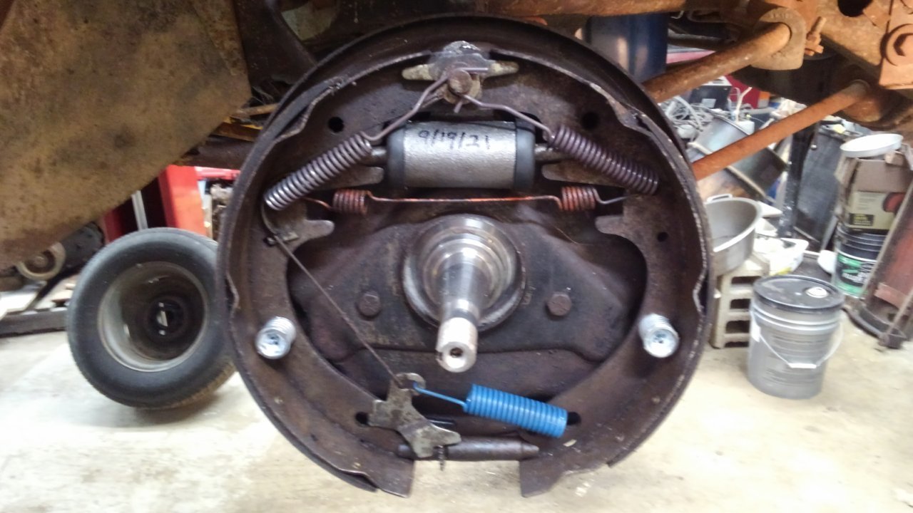

    Drum brakes are used because:
    1) they work well
    2) they are cheap
    Read this post for some information: https://www.tacomaworld.com/threads...r-off-road-racing.741784/page-4#post-26409750
    Self adjuster:
    The photo below is the passenger front brake of an old car, when moving in reverse the drum will be turning turn counter clockwise.
    1) As the brake is applied the shoes will be pulled in a counter clockwise direction also, moving the rear shoe (left) down and the front (right) shoe up.
    2) The self adjuster cable will cause the lever to move up and grab next the tooth on the star wheel.
    3) When the brake is released the shoes will be pulled back to the home position by the 3 springs.
    4) The lever will rotate the star wheel one tooth as the rear shoe moves back to home.

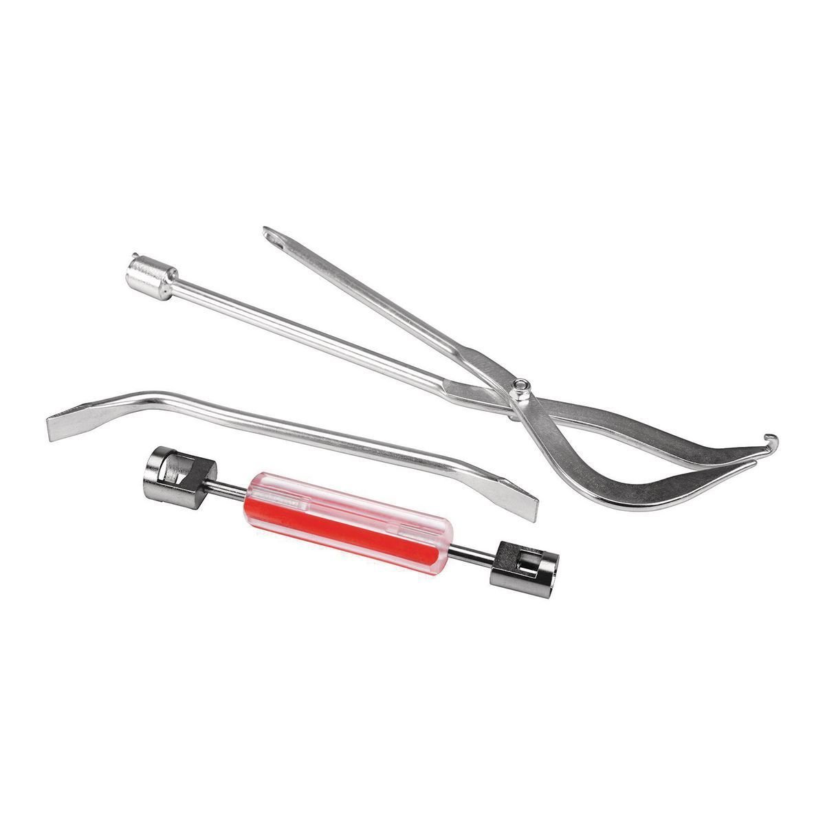

    If you invest around $15-20 you can have all the proper tools, makes the job much easier.
    Remember the other side is a mirror image not identical.
    The shoe with the shorter lining is called the primary shoe and goes to the front of the vehicle.
