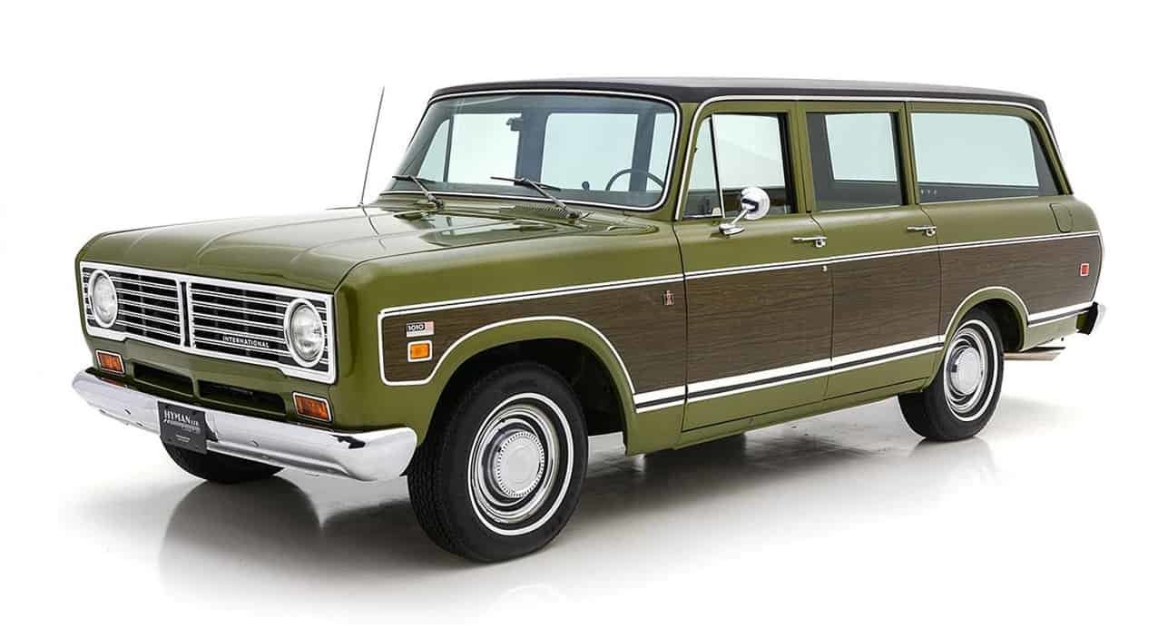

    None of the Ford/Chev/Dodges of the era had overdrives on their heavy duty transmissions, they did however offer OD on the 1/2 tons starting in the late 70's.
    There were 3 HD 4 speeds commonly available back then New Process 435, Borg Warner T-18/19/98, Muncie 420/465.
    International Harvester was different however. The HD bus and truck transmissions were available in pickups and Travelalls:
    4 speed with compound low and 1:1 final
    5 speed with compound low and 1:1 final
    5 speed with syncro first and OD final
    And finally:rockband::
    5 speed with compound low and OD final :woot::woot:
    Now that would be cats @$$ in a truck or Travelall.
    Travelall picture just because I always wanted one.
