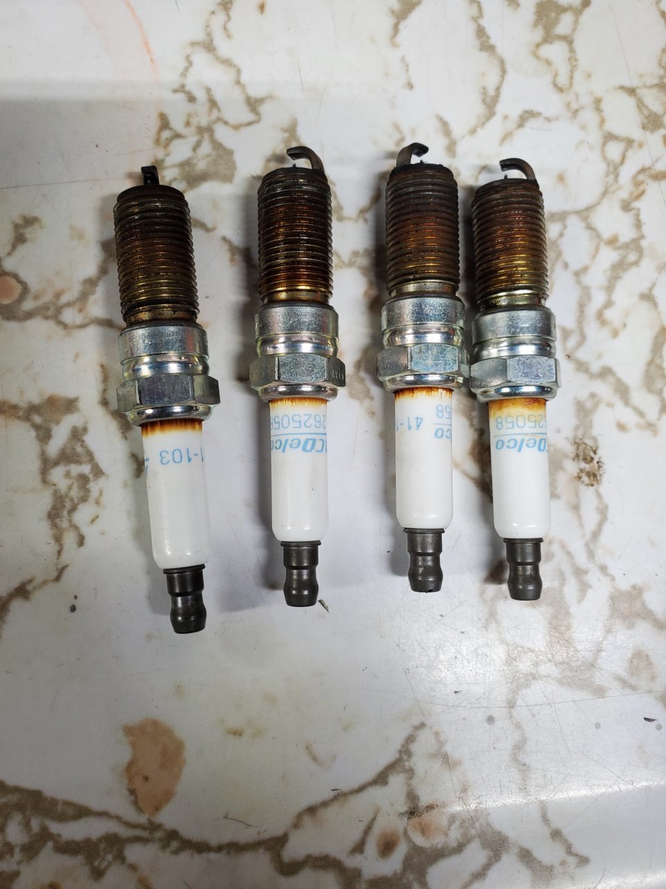

    I did maintenance on that 2012 Malibu this weekend, spark plugs and serpentine belt. Plugs were easy but belt was a bit of challenge with minimal room.

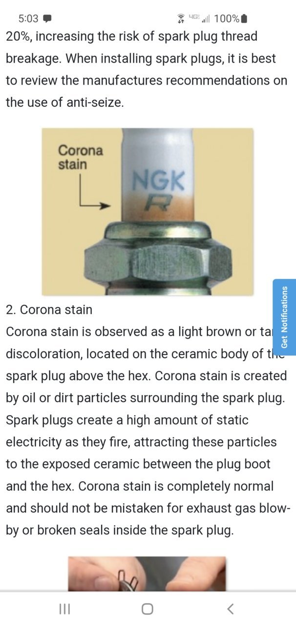

    I'll share a picture of spark plugs and something I learned upon researching.

    How these plugs looked made me wonder if they were leaking.

    Does kinda look like blow by

    I’d focus on the electrode and compare against any chart you can pull off the Google.
    The threads look like most plugs I’ve pulled from my vehicles. Like the info you attached says, the Corona stain is normal.
    Can you pick the one blowby plug out from the others?
